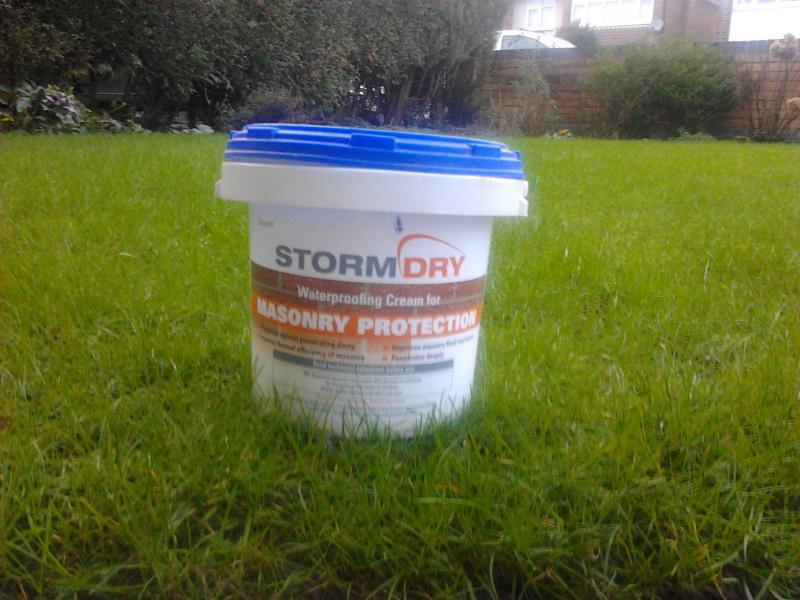

A few years ago we had a new wall built at the front of our house. After the first winter, several of the bricks had suffered from frost damage, so in the spring we had the bricklayer who built it chop out the damaged bricks and replace them. Then during last summer I treated the wall treated with this, which is promoted as "a waterproof repellent for brick and stone".
It was expensive at about £100, but I deemed it worthwhile to protect my wall from any further damage. Last week we had our first severe frost of the winter and I was smug in the knowledge that all would be well..........except it wasn't!
Two bricks have lost their facings. So I need to know what I can do to prevent further damage, so far I have forked out for the wall, repair of the wall and an expensive yet ineffective product. The idea of having a wall was because it would require less time and money in maintenance that a fence. :rolleyes:
Has the wall a DPC is it retaining any soil? If water can soak up into the wall sealing it in will probably have only made it worse I would think :cry:
Yes, the wall does have a DPC, however all of the damage is in the top half of the wall (it's 8 rows high) You can see in the photograph that it's the first row under the engineering bricks
No. there's no soil behind it, at least not above the DPC.
The 'cream' was applied after probably the driest period in the last decade, and according to the manufacturers application instructions it says it allows masonry to breathe naturally anyway. They also say it stops rain penetration and improves flood resistance.

Problem 4. A free-standing wall should not be coated with anything regardless of what manufacturers say.

It is engineering brick, you can see it in the first photo of the tub, the wall is behind it in the distance.
Can you clarify what you mean please? Do I have a claim against the manufacturer for making false claims and selling a fraudulent product?
