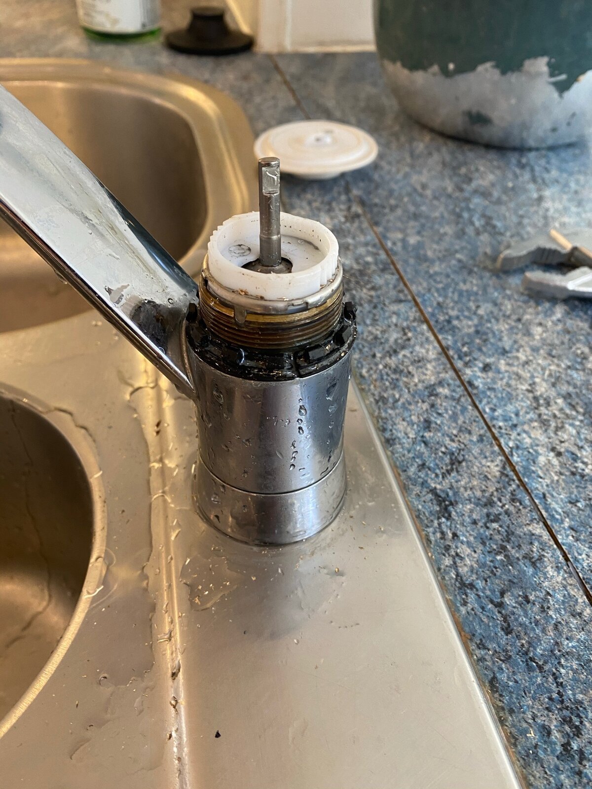

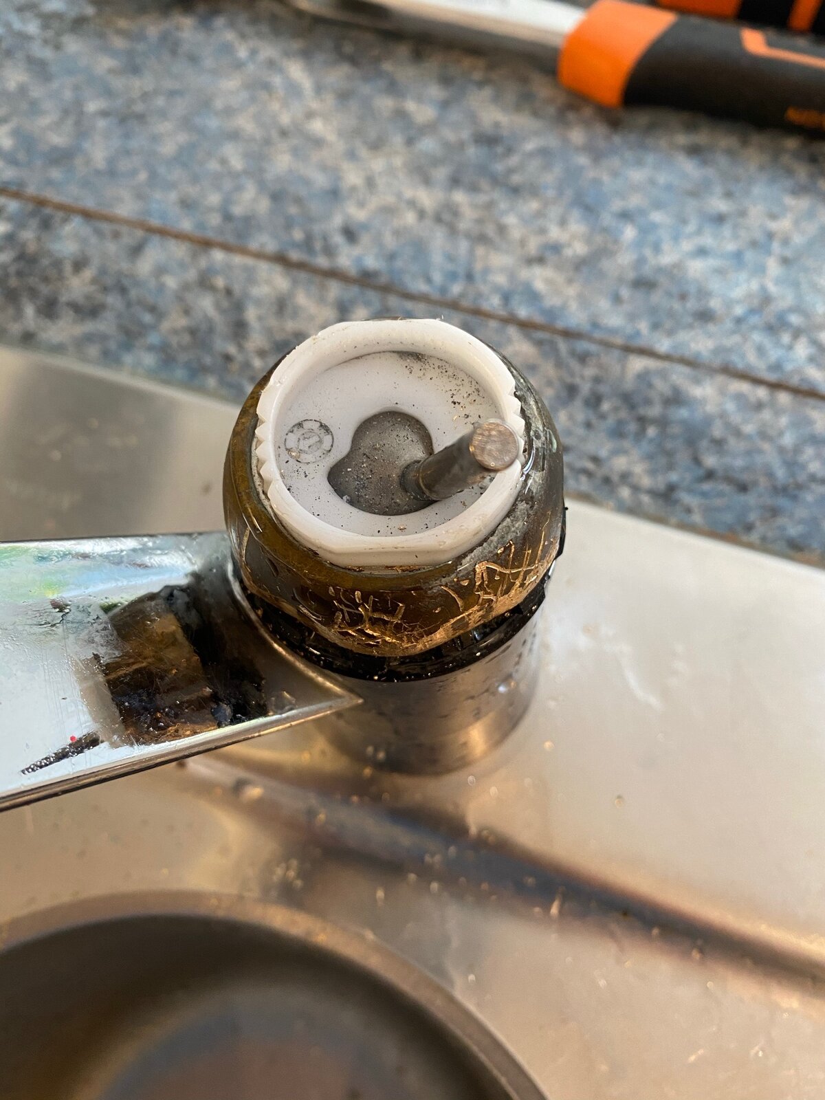

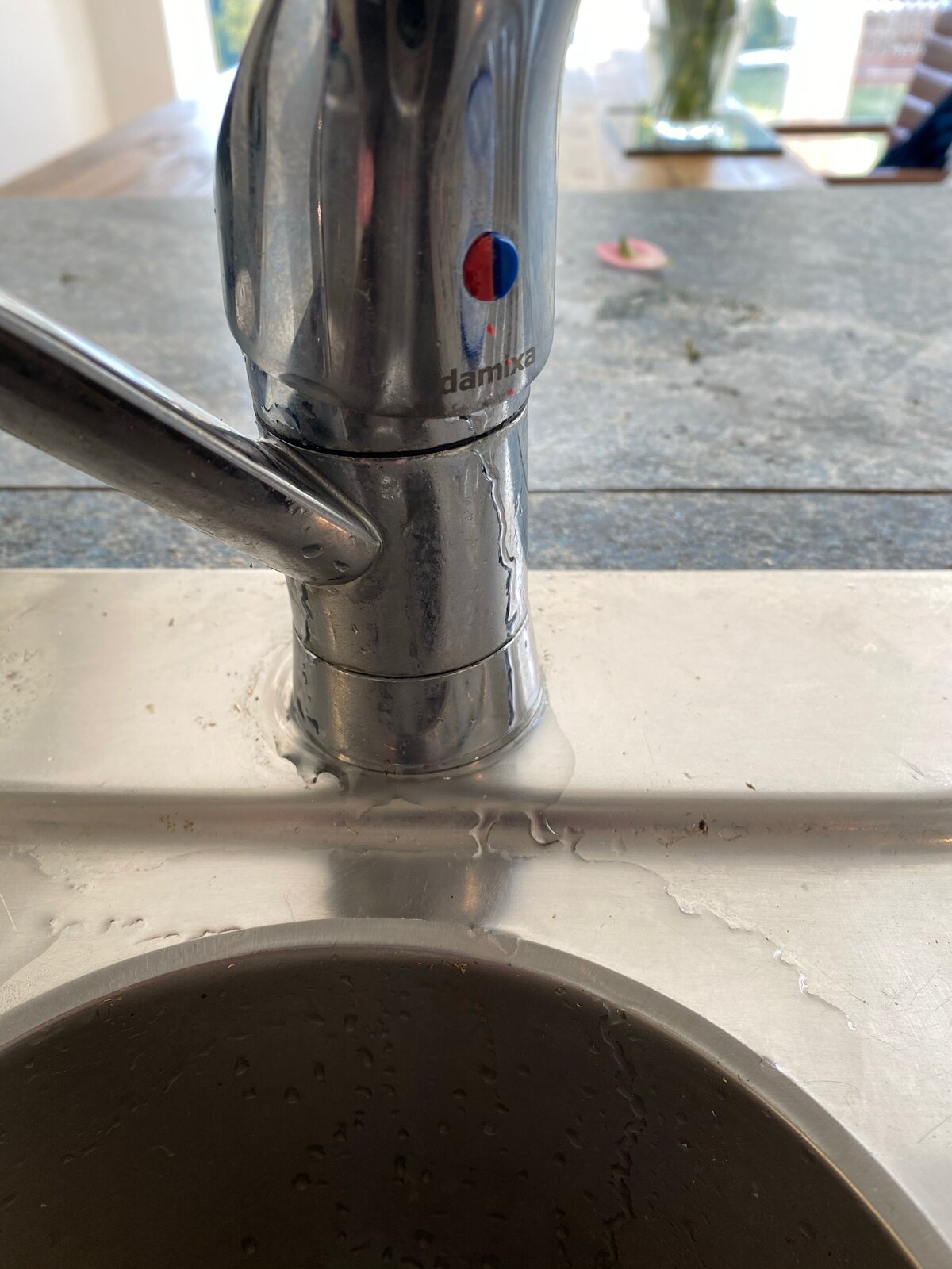

Hi,
I wonder if anyone can help? have a Damixa Jupiter tap (https://damixa.com/kitchen-mixer-33-p1406) which is constantly leaking from under the mixing handle.
I had thought it was the cylinder, so have replaced this. However I am getting a constant drip bubbling up from the cylinder, then running down the side (see pictures).
I've put some videos of the problem here:
Would anyone have any advice on what to try next?
Thank you for any thoughts!
Tom
Was there a seal on the bottom of the cartridge? Is it seated correctly?
Is the mating face of the tap clean, 1 small piece of crud will stop it sealing correctly.
Was the new cartridge identical to the old one
