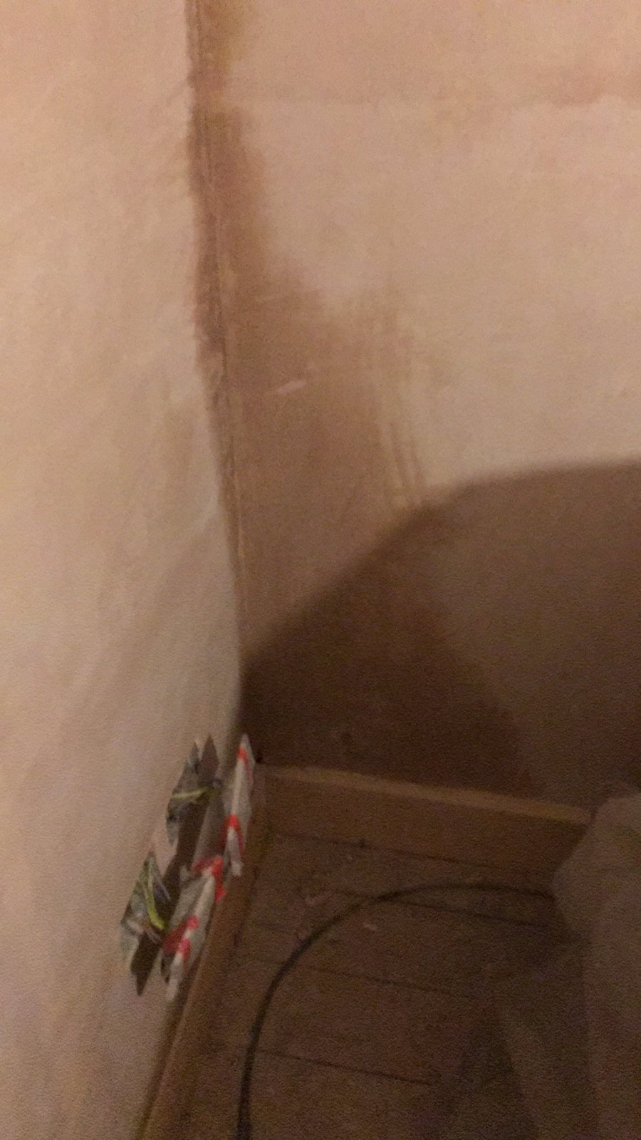

Hi.
So, this is a common problem right? That damp gets mistreated by damp proofing when damp showed on the walls? It’s happened to us.
After all the snow and rain recently, I’ve just noticed a big patch of moisture up the corner of our living room wall. We had it proofed and plastered about 5 weeks ago. The skirting came away a little from the area that’s now damp, but that can’t have caused it right?
What can I do? Am I looking at a fortune wasted and a fortune remaining to pay? Fortunately we haven’t painted yet. It’s an old Victorian house.
Damp shown below.

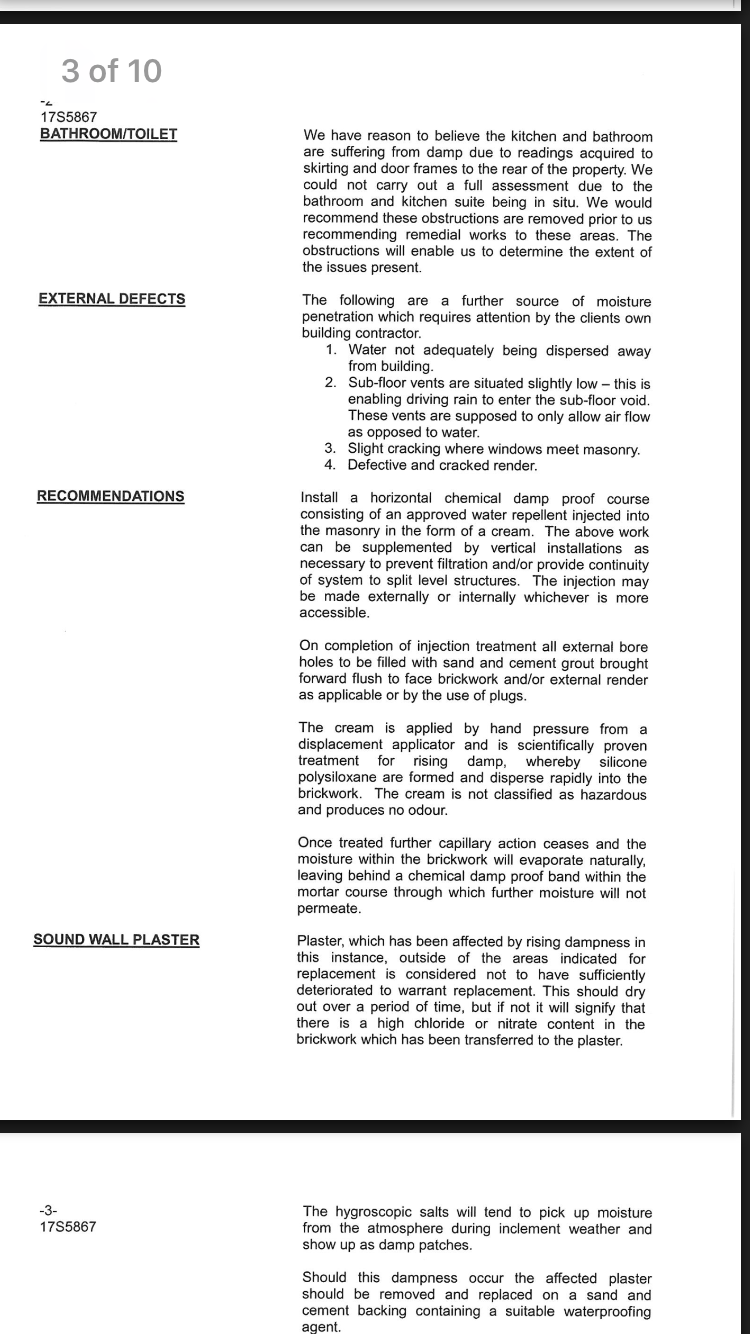

What 'treatment' has been applied here? What did the damp proofing company do? Why did they do anything? (i.e. what was your original problem, and what did they claim was the problem?)
Here’s part of the report. As you can tell, we were advised of the issues with the external defects, so it’s my fault I guess for not following that up.
Can I still get these four points done? Is it extortionate to do so? Have a baby due in february and this is pretty worrying.
the dark patch might be a cold corner with water penetration. it doesnt look like condensation but its early days after the plastering. what was uused to plaster that wall?
post a picture of the outside if you can.
is ther a c/breast nearby?
The report is a mess.it contradicts itself an talks rubish like strip the bathroom an kitchen to have a lookatthe walls.never heard of kitchen suites before.
youve taken a hit from these d/heads dont take another from the massive plasterin quote.

What's behind the damp patch?
Your report talks about water not being dispersed properly and sub floor vents too low... have you got concrete/paving outside?
Does this touch the house wall or is there a gap?
If your house is victorian, then it's unlikely to have a cavity, it might be that damp proof course (DPC) has been bridged (i.e. covered up) this can allow damp to get past the DPC.

I would go with both of the previous posts. Whoever wrote that specification doesn't know what they are doing, and it's likely that the pathway has been raised up outside.
When you treat rising damp, you hack off the plaster inside, drill and inject the silicone cream in to the mortar course, not the brickwork, apply a cement render with a waterproofer in it making sure it's washed sand not building sand, and then plaster as per normal. You don't leave the old plaster on there, as it could take a year to dry out, and the wall will stay damp until it does. Furthermore, if you leave the plaster there, then the damp can creep up and over the chemical DPC via the old plaster itself. Their last section on sound plaster is a contradiction, because if any plasters damp, then it need treating, and if it's not in the affected area, then it won't be damp.
Points 1 to 4 need dealing with, but without further indication and pictures of the outside, then it's difficult to asses, but I cant see them costing too much.
If you haven't paid them yet, then don't, and if you have, get them back in, and tell then to get it sorted, otherwise you want a refund.
The works you have had done by damp company are pointless unless the damp source has been identified and rectified, and if rectified then the damp work is again pointless as there is no damp issue.
In short you have been ripped off by another damp company cowboy.
You need a surveyor who specialises in damp problems to get a correct diagnosis.
You can’t diagnose damp in the building structure by testing the timber [as in your report].
