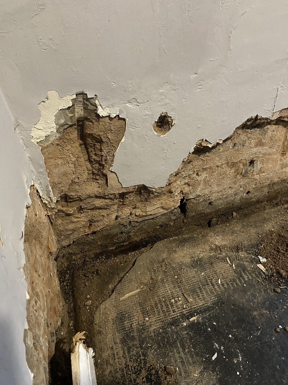

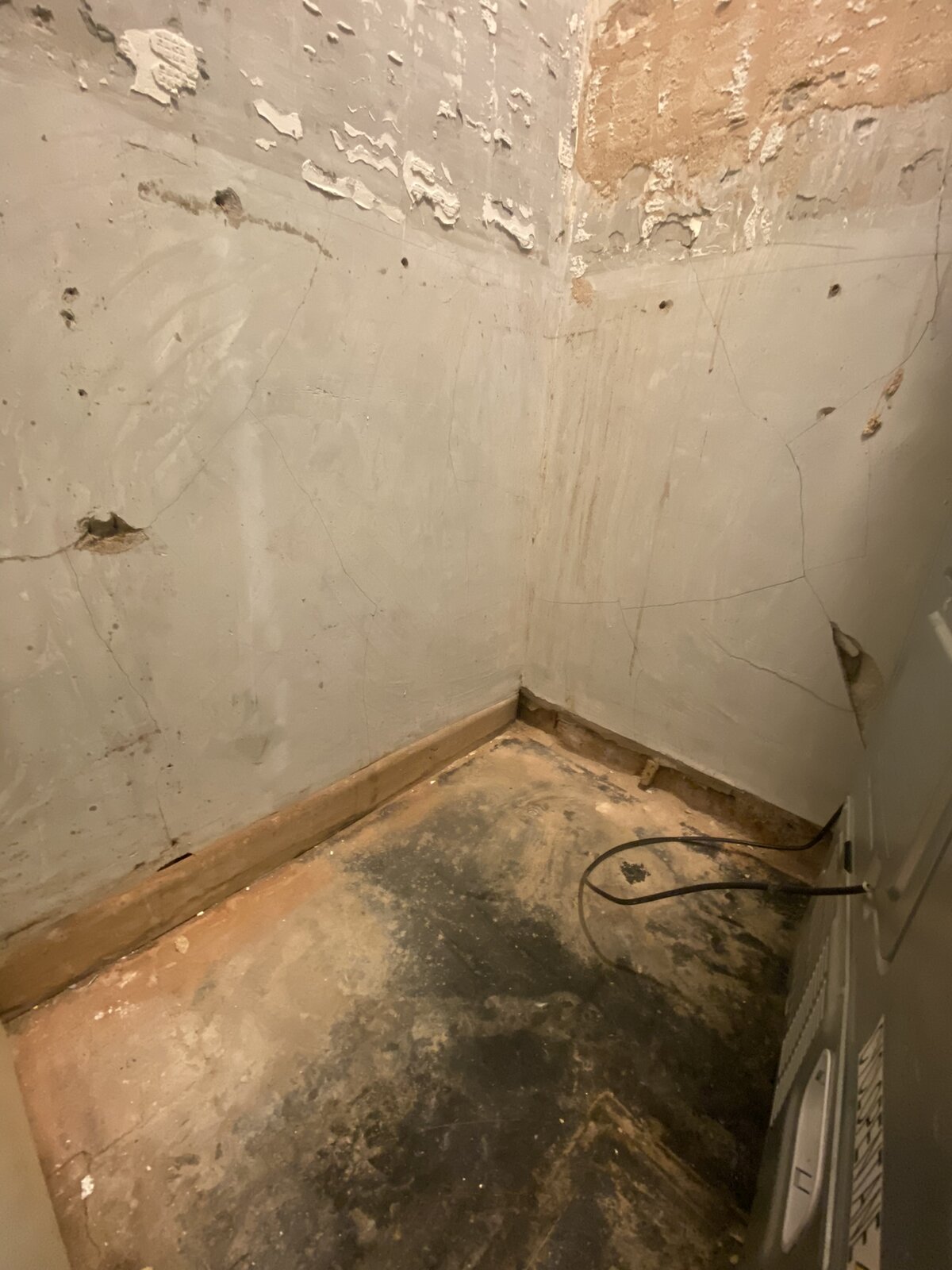

I'm wondering the best way to tackle what I think is rising damp. I am wanting to level the floor so what would be the best option to deal with the gap around the edges?
The floor is concrete with a couple of inches of bitumen which has an inch gap between the wall all the way around.

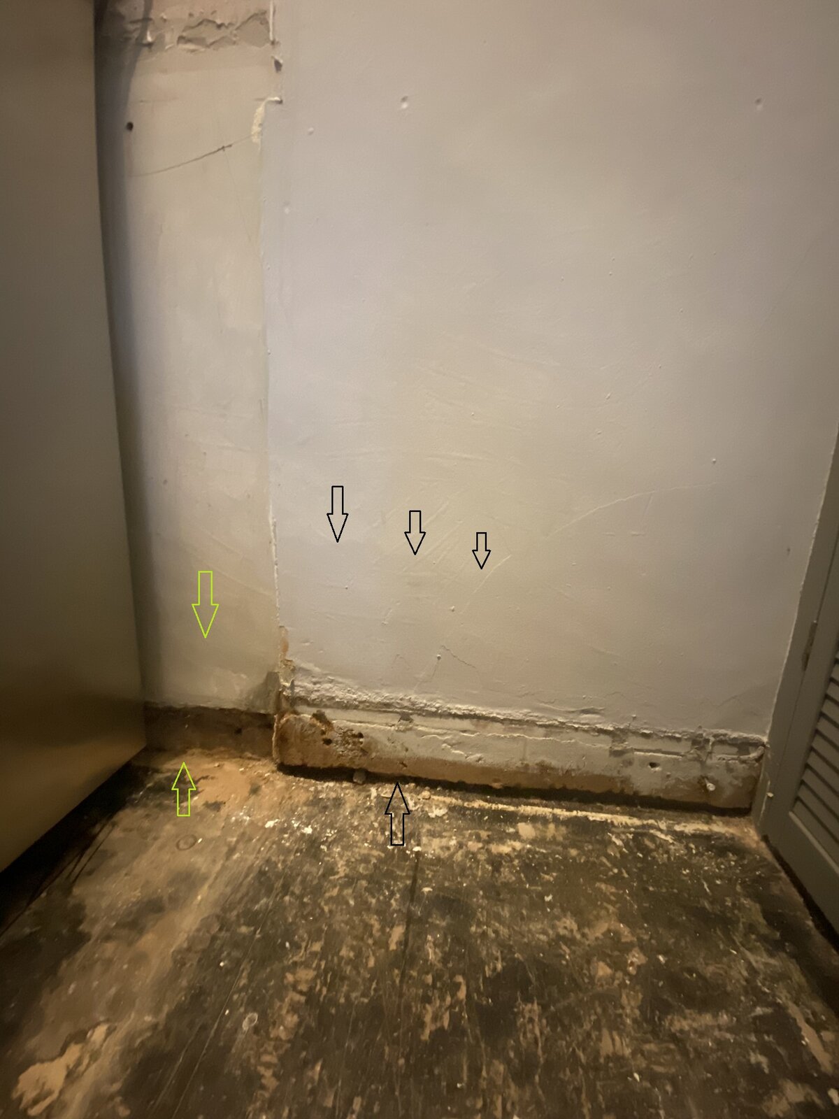

The damp is on every wall to around a foot in height apart from behind the cabinets where the walls arent painted. Behind the cabinets, there is still a gap between floor and wall but it is bone dry.
This is where I've removed one of the cabinets, black arrows point to damp and green arrows the areas are dry. The line of damp stops exactly where the paint finishes.
All this area is very dry including the old skirting board

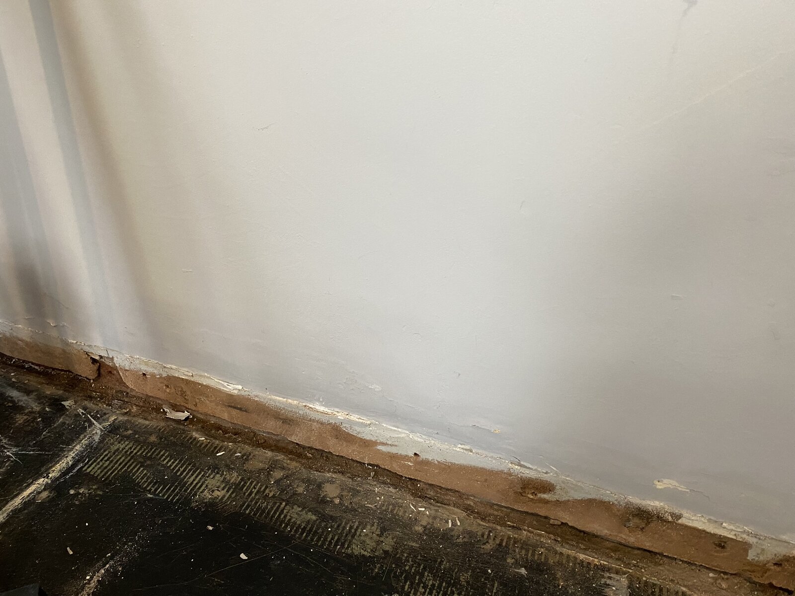

The rest of the walls are all damp to around a foot, I've removed the damp skirting boards

you dont appear to have a DPM under the concrete?
the bitumen was applied as a Damp Proof Membrane. Its not worked.
A previous, failed attempt has been made to inject chemicals into the wall(s).
The wall plaster in general appears to have failed.
Is the outside ground level lower or higher than the kit floor?
Can you post pics of the outside of the walls?
Knock off all the plaster to a Ht of 1m - or remove all the kit wall plaster floor to ceiling.
Remove any wood wall plugs that were used to fix skirting.
Dont touch the corner beads.
Rake out the gap and fill with sand & cement.
Render the wall to 1m high with a 4:1 mix of sand & NH lime - use Limelite finish on the render.
Stop the render about 50mm above the floor.
Spread a liquid membrane across the floor - check that its compatible with bitumen and SLC?
Bring the floor to level with SLC.
Given the state of the floor there's no guarantee of success - guaranteed success would require the concrete cracked out and a new pour on a DPM.
