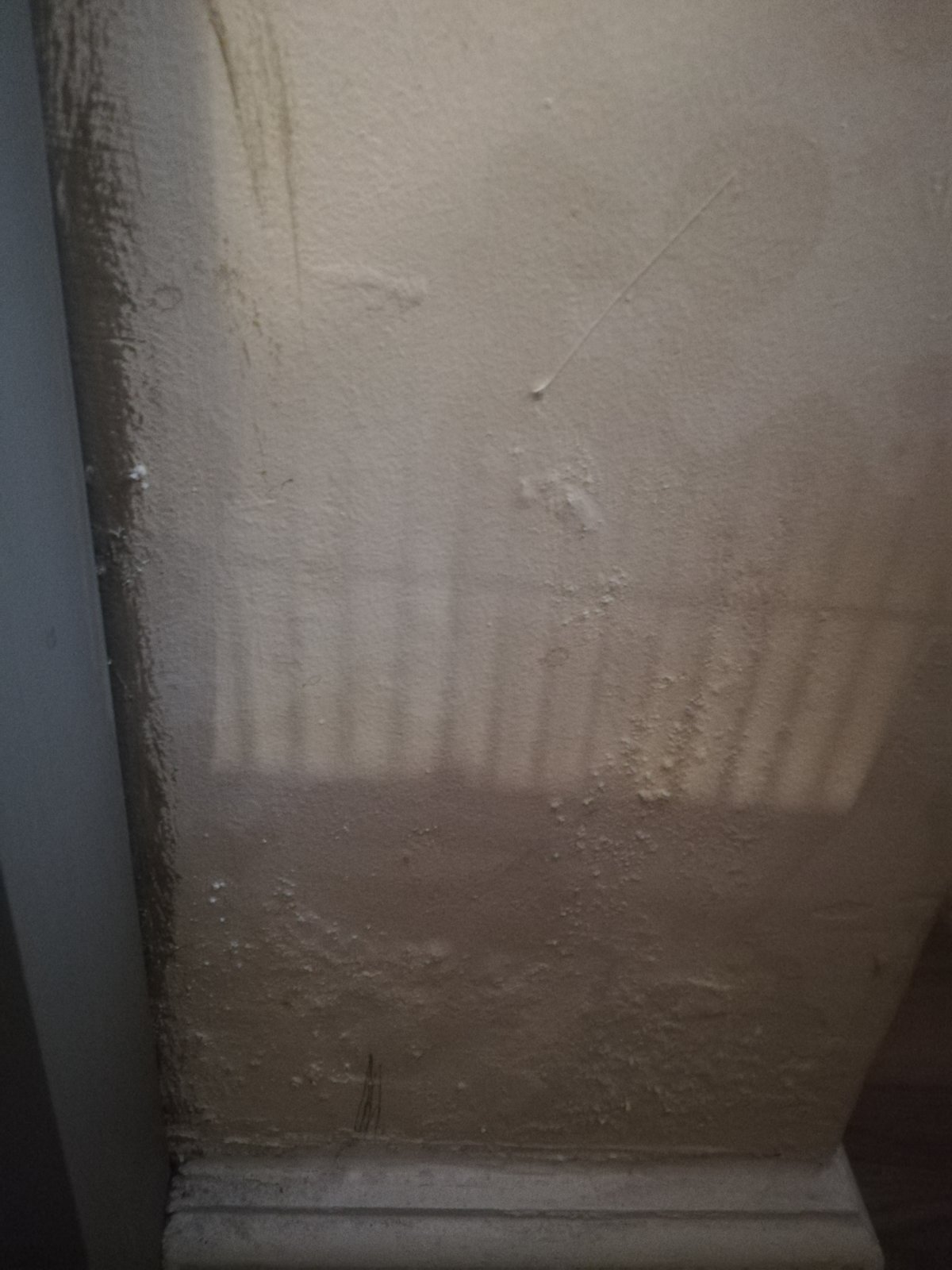

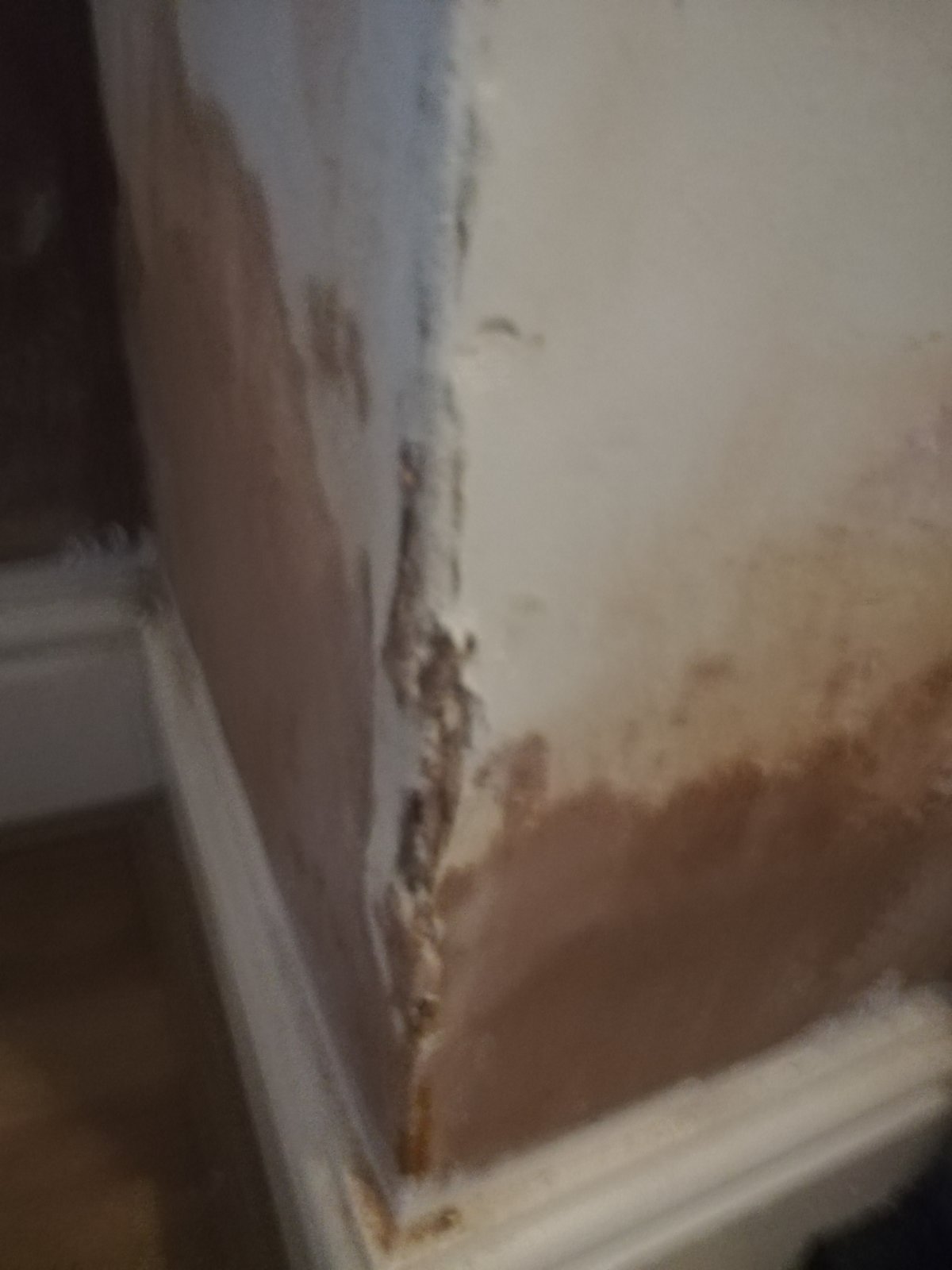

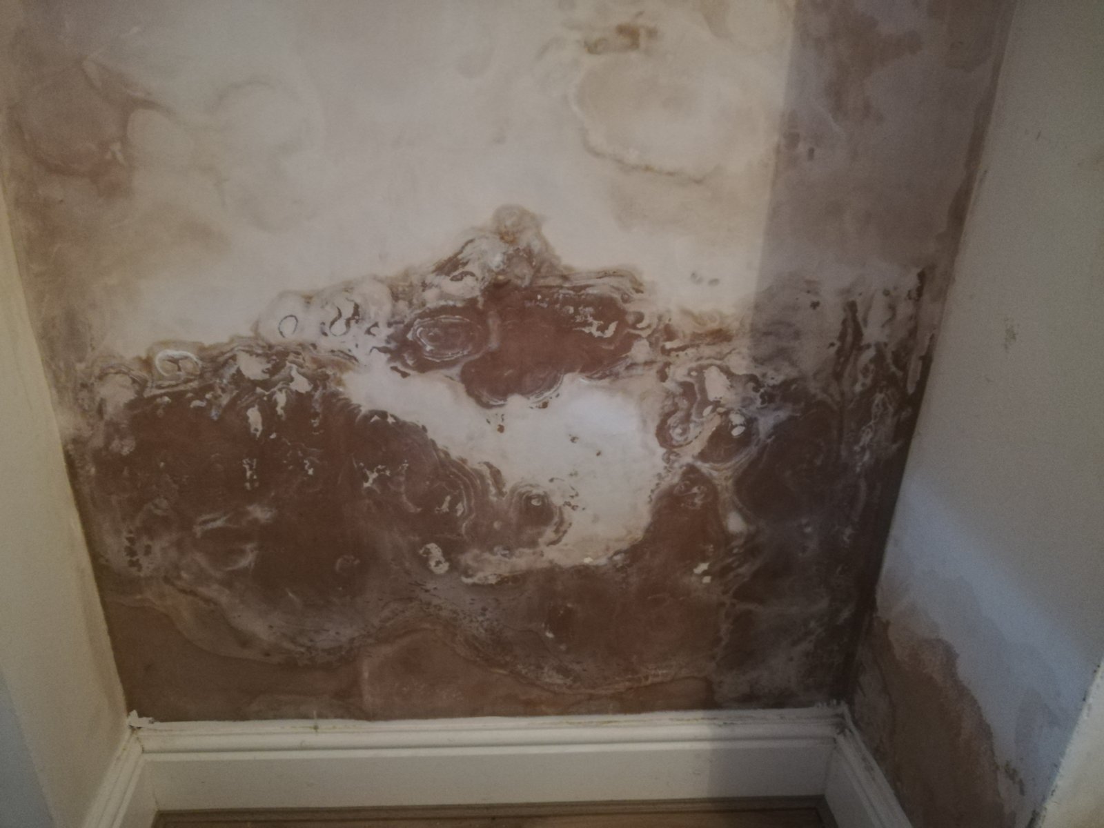

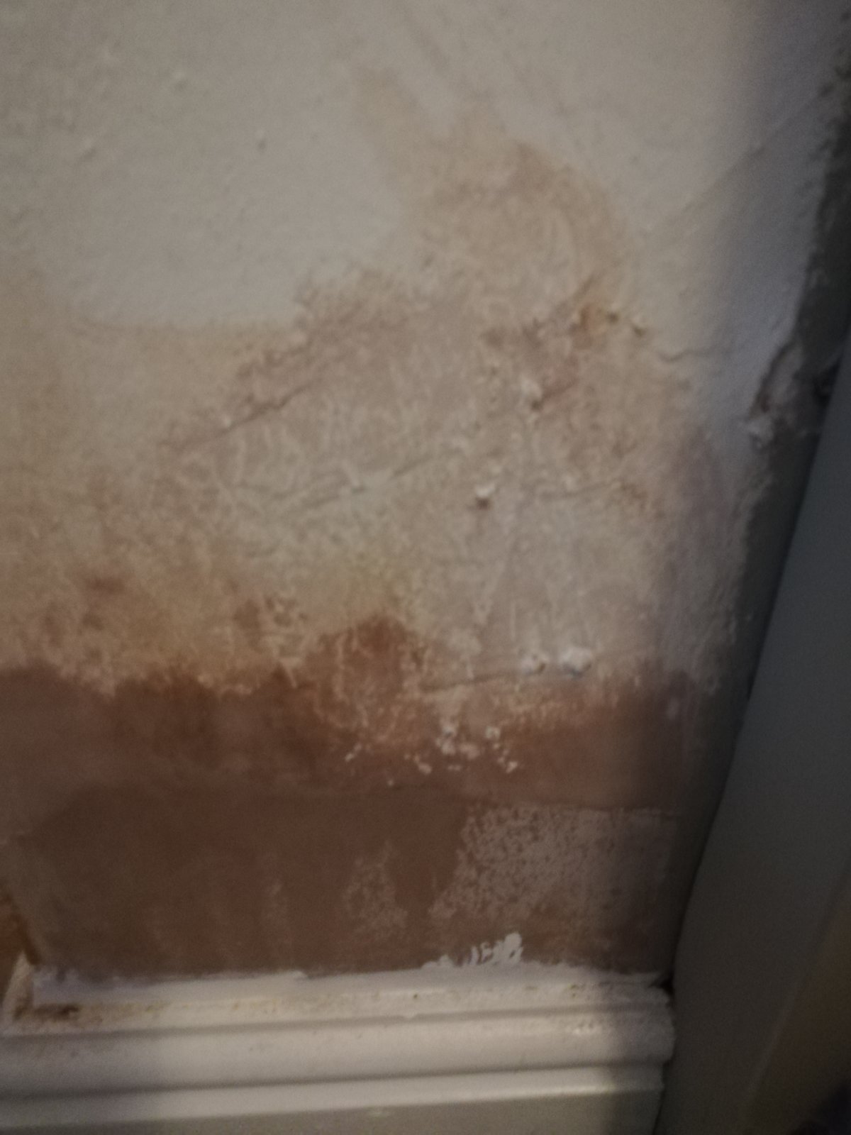

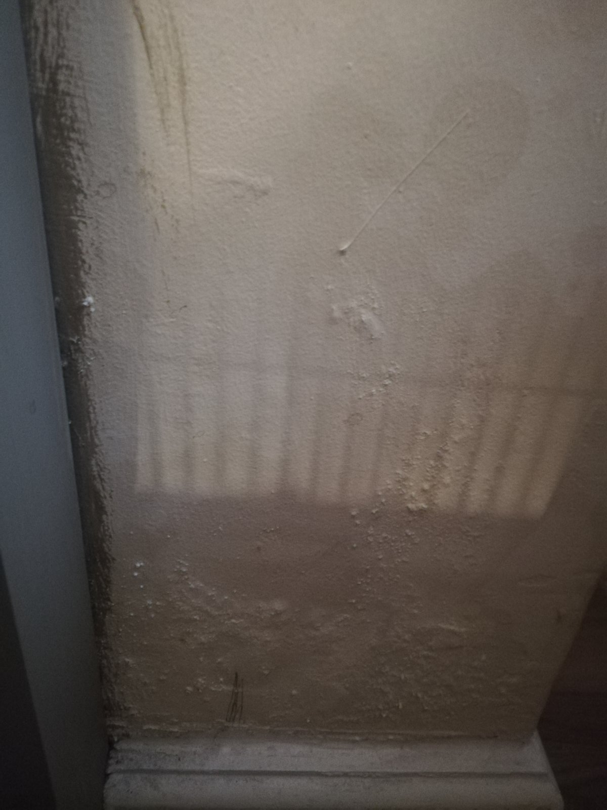

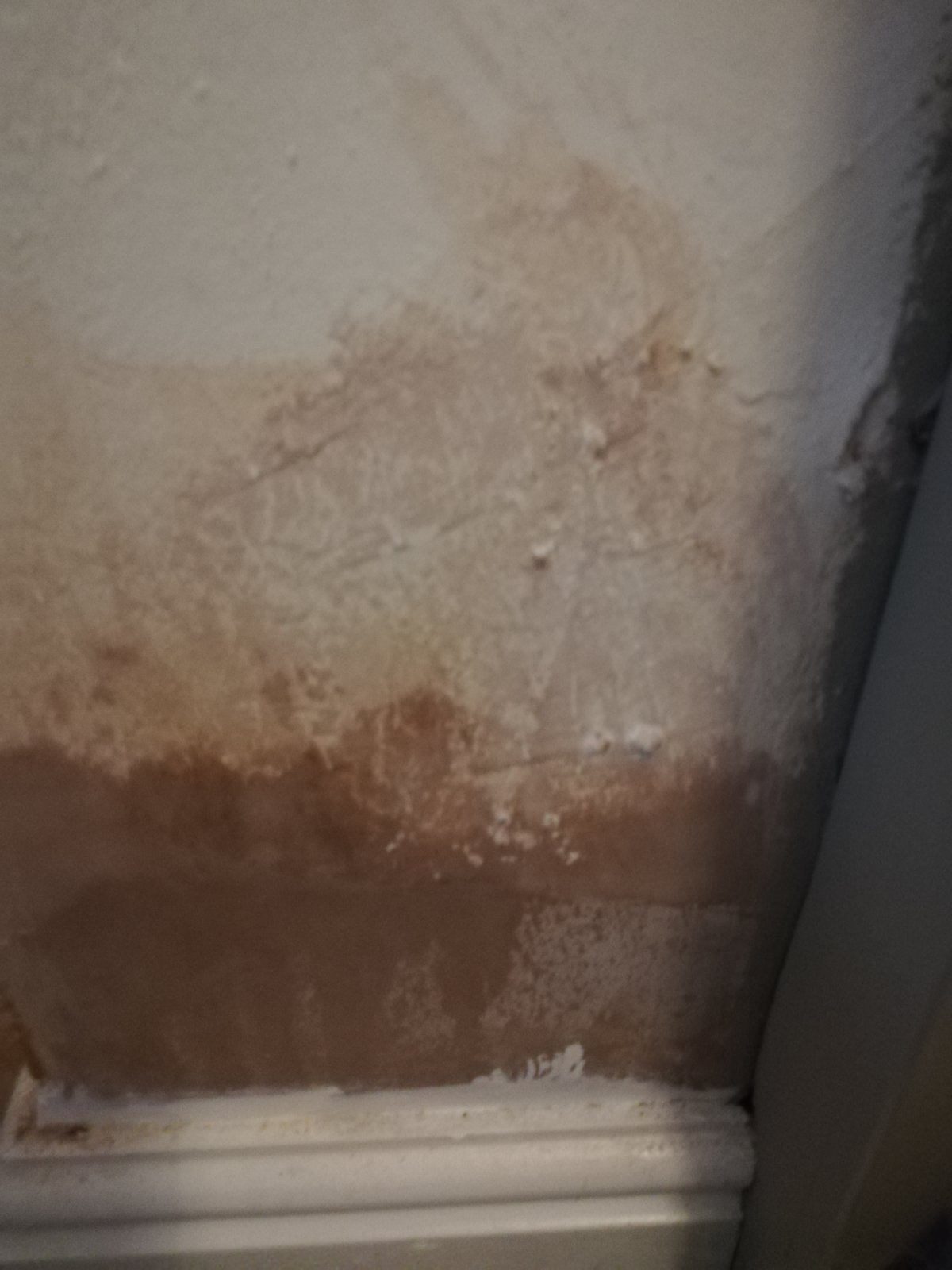

Thank you everyone for your replies. The cowboy damp contractor who won't come back and have a look at the problem did not hack the plaster off. He took all tbe skirts off and said he would come back in 6 months and re plaster. When i contacted him he gave me an extortionate price to re plaster so i went with a plasterer who was recommended. He said as the damp and salts were still coming through he didnt think it had worked and said the plaster should have been hacked of before injection. So rather me waste more money he hacked of and re plastered the alcove next to chimney breast which was the worst. It was for 3 months then its returned with a vengeance the damp on the internal wall backing onto my front lounge has also got worse and has now spread onto a wall that backs onto the hall. Thats the first time ive seen the damp there ill post some photos

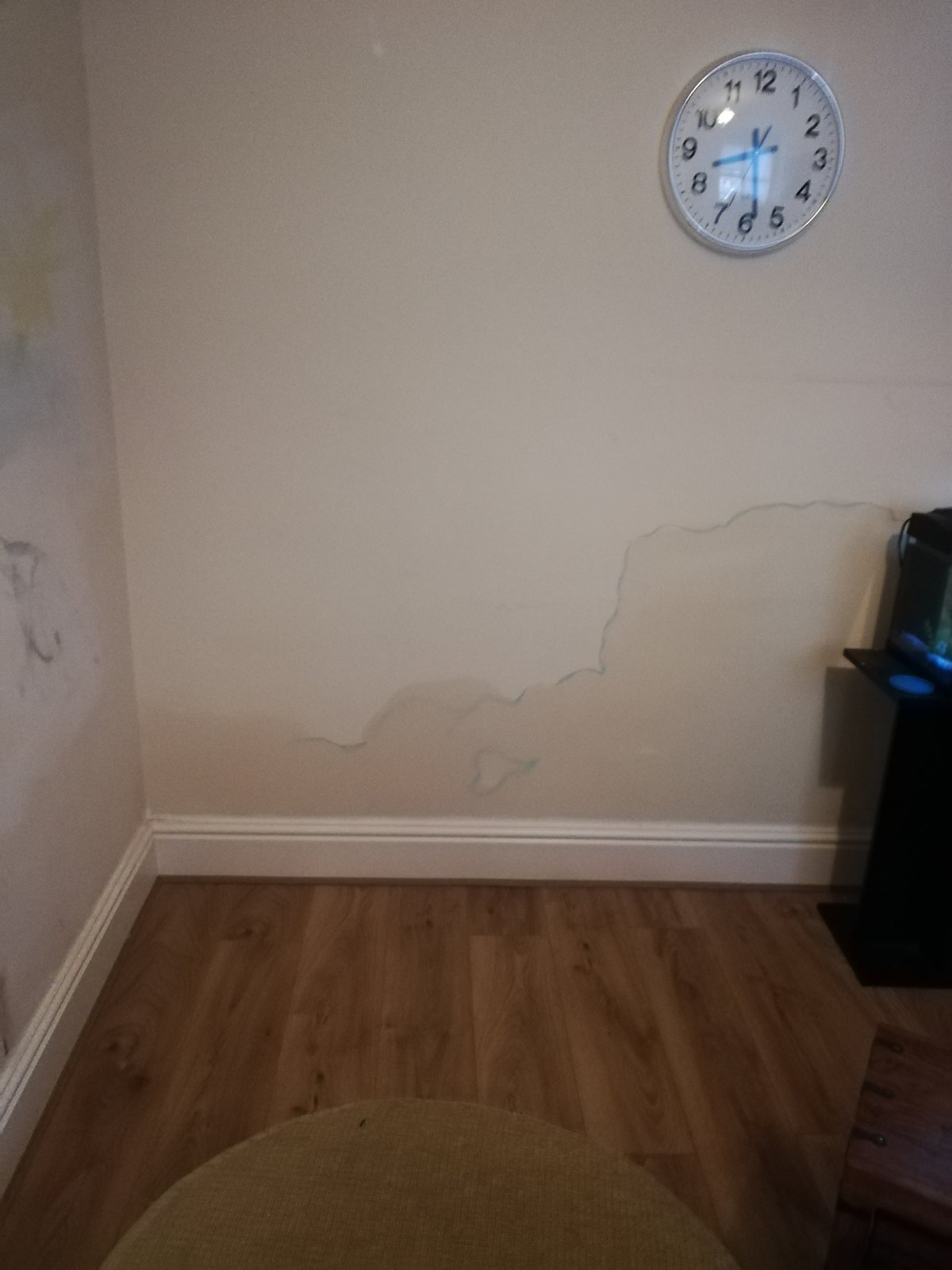

This is the wall that backs onto my front lounge. You can see water mark. Ive drawn around it and its now spread onto wall on left if photo that backs onto my hall

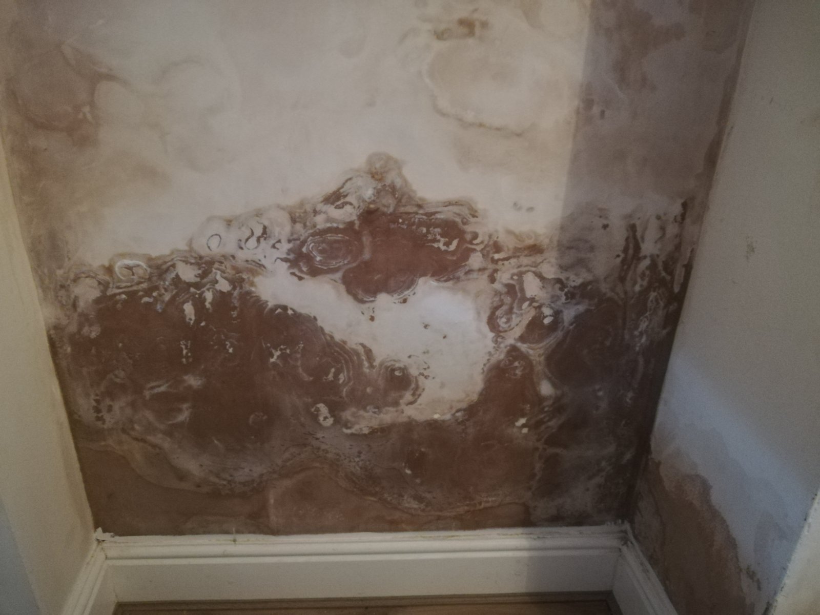

This wall is the alcove that is the left side of the chimney breast it is a party wall with next door and is at a right angle with that other wall. Next doors ground level is much higher than mine.

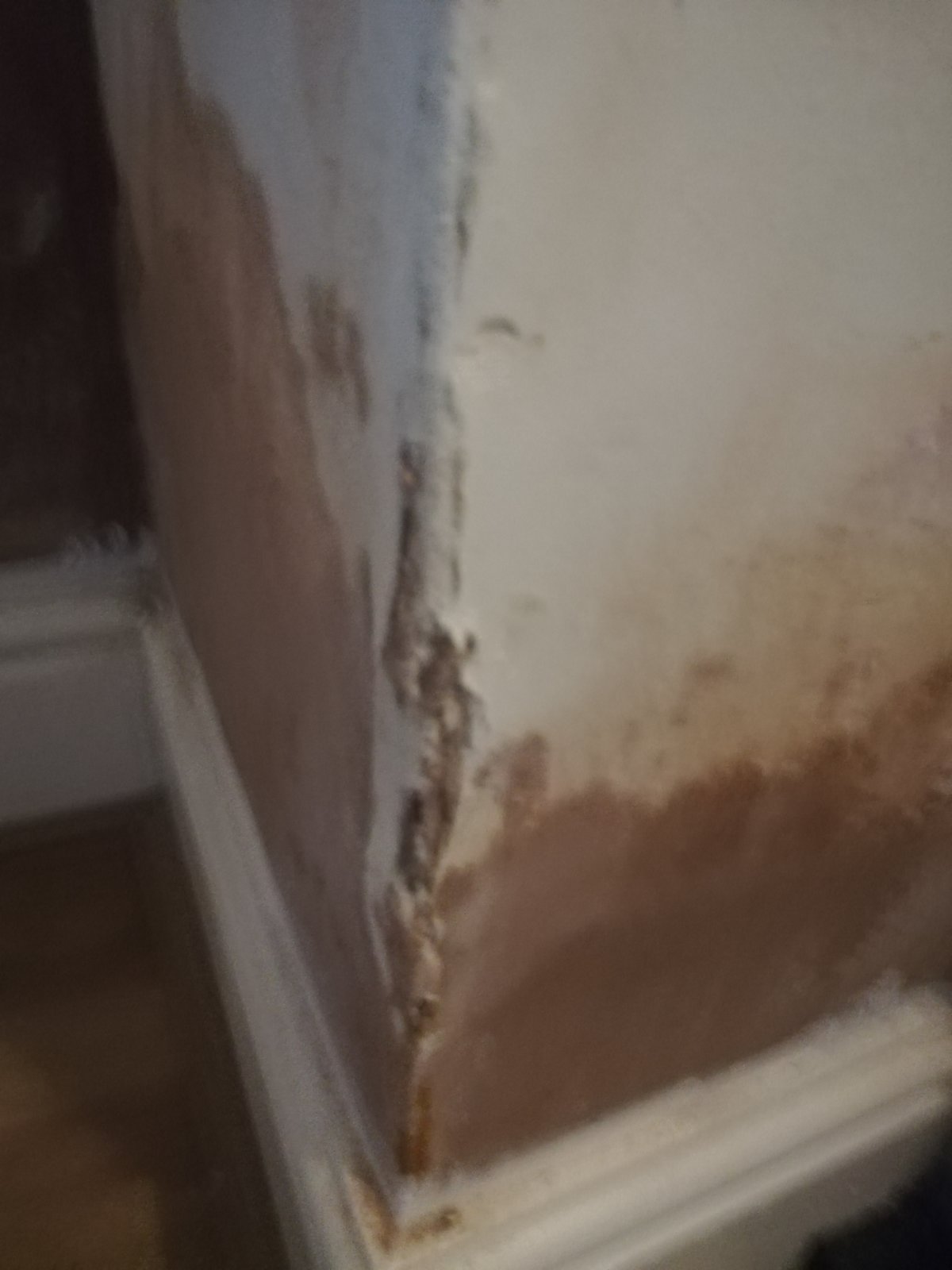

These are all around the chimney breast. Ive just had a new roof 3 weeks ago and all new lead around chinmey and he filled any gaps between the two houses. But its got worse but we have had a lot of rain. I have also just had my back garden level reduced as it was much higher than the bouse hoping this would help.

Have you got a water meter?
also please show us the soilpipes, rainwater pipes, drains and gullies around your house, and any manhole covers.
It is especially important to see any sunken, cracked or patched paving or concrete.
Also any paving or ground that is higher than the house or sloped towards it.
These points are because damp is water, and the water must be coming from somewhere. Find out the source of the water, and fix it, and the damp will stop.
In an old house, the drains and water pipes are probably leaking.
John, the OP said the damp was on an internal wall, and presumably because it's a Victorian terrace, she has neighbours either side of it. Would paving, drains, gullies etc outside effect that far in? She also said that she's lowered the garden, so paving shouldn't be higher.
Yes i have neighbours either side. But one side the level is much higher and this is the damp side
That's true, but I bet the watermain does. They often run under the hall floor to the kitchen at the back.
