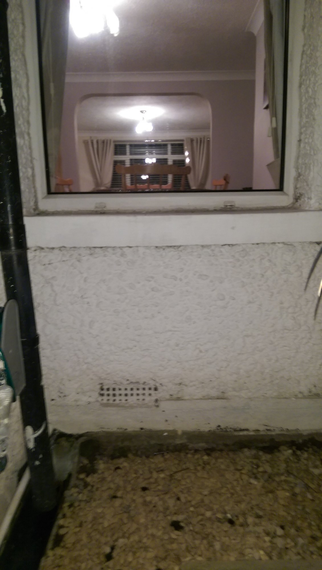

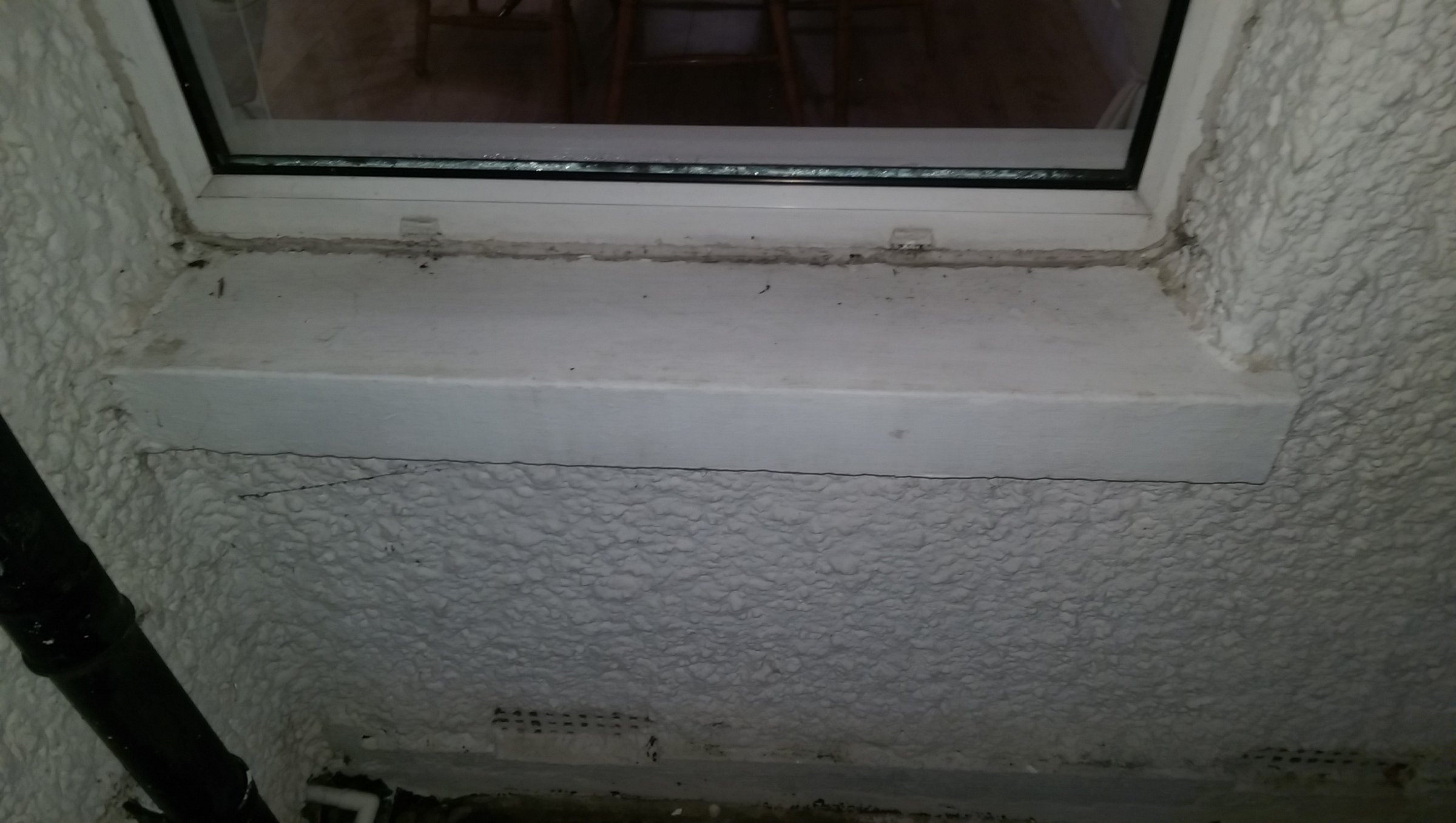

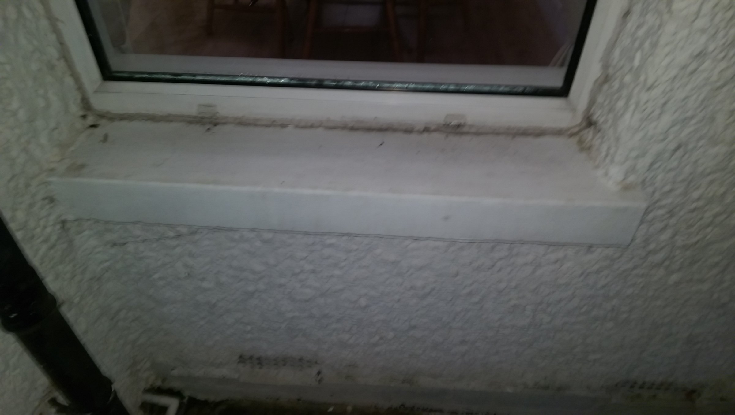

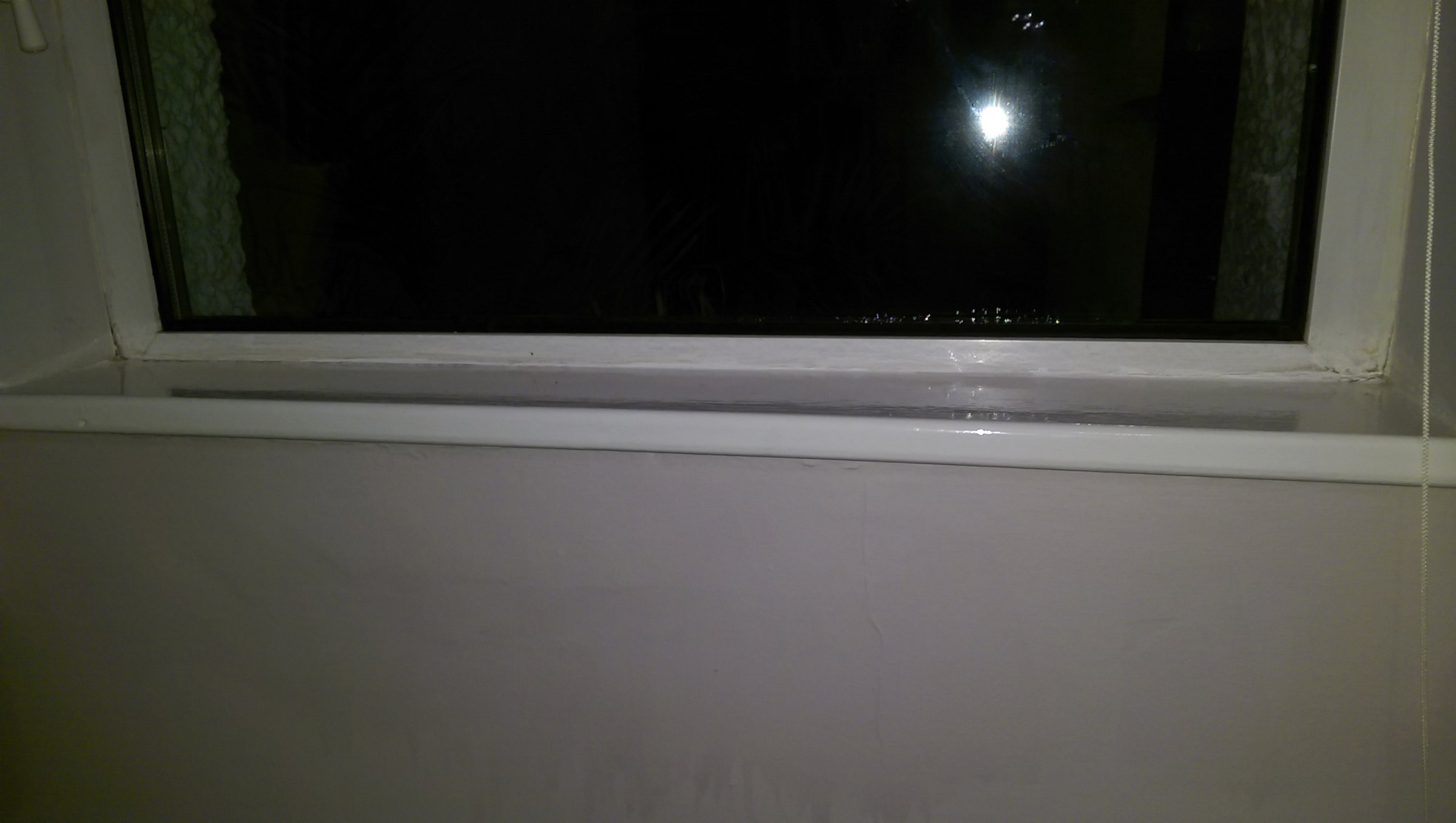

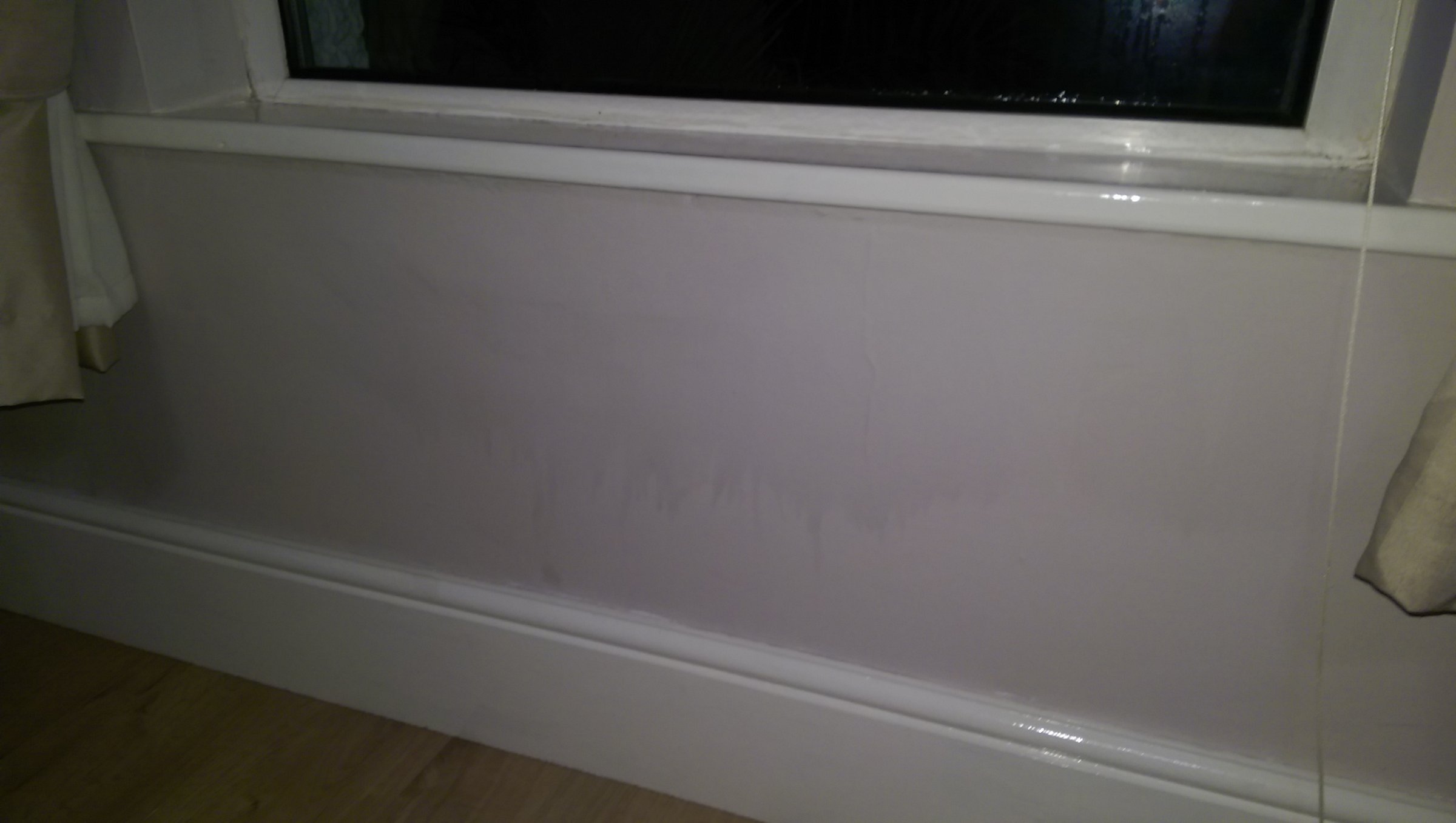

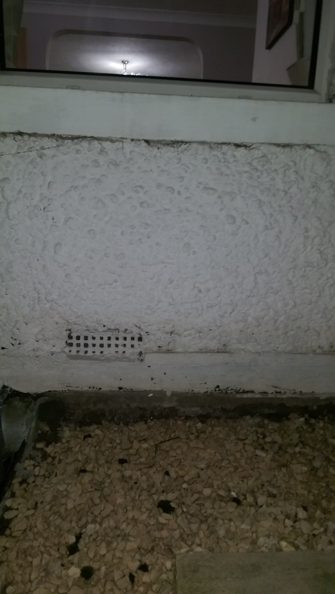

I had a damp patch under a ground floor window around a year ago. I re-sealed around the window in question, it dried out OK and I re-painted the wall a few weeks ago, so seemed to be problem solved. However, got up this morning to find a damp patch had appeared directly under the window. Only thing I can think is that last night was the first hard frost I have had this winter, but not sure why that would cause it? Any ideas? The patch is not in exactly the same place as the original problem, so it isn't the old one that has just started showing through the new paint. Any help appreciated.
photo would help, inside and out (showing ground level and position of DPC and airbricks).

Thanks for your reply - I will take some pictures when I get home this evening. No, not a bay and a small amount of condensation.
Thermal bridge just due to lack of any real insulation, and general crappy UK building methods (solid materials bridging the cavity around windows).

Hmmm, maybe that's it then. We are running a dehumidifier though. Bought it a couple of months back, as we have a couple of other problematic areas (musty smelling low-level cupboards in the kitchen and peeling paint on the inside of a window recess the other side of the room from the one in the photo). Doesn't seem to have improved things a great deal, but there's not a lot of other ventilation - no trickle vents in the windows and I don't think there's a way to retro-fit them. Currently no extractor in the kitchen, so maybe that would help.
