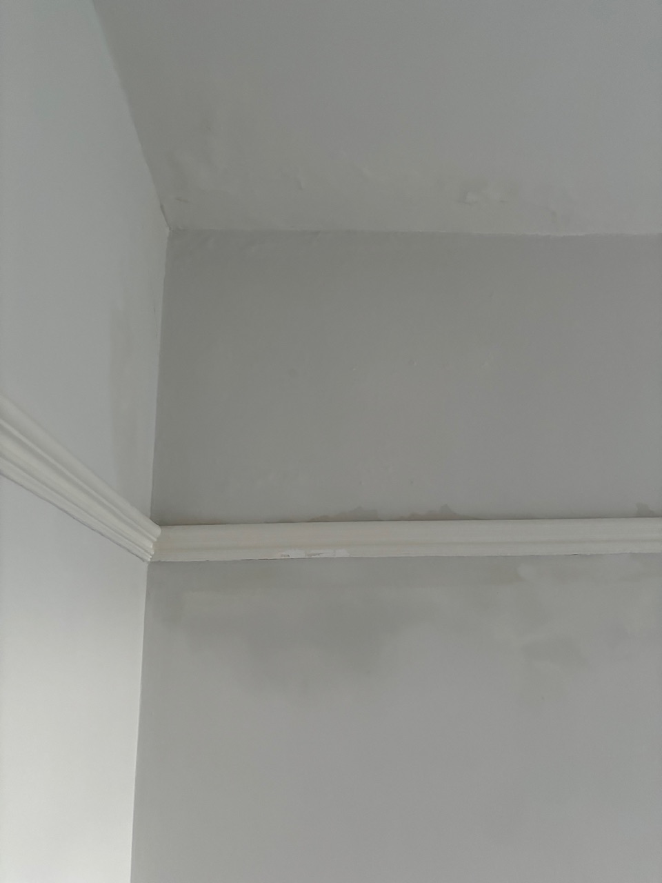

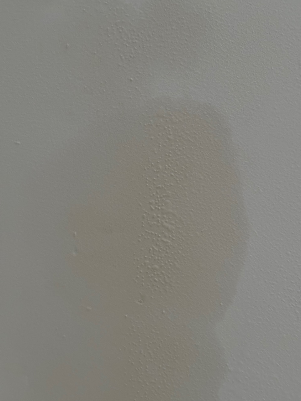

Hi,

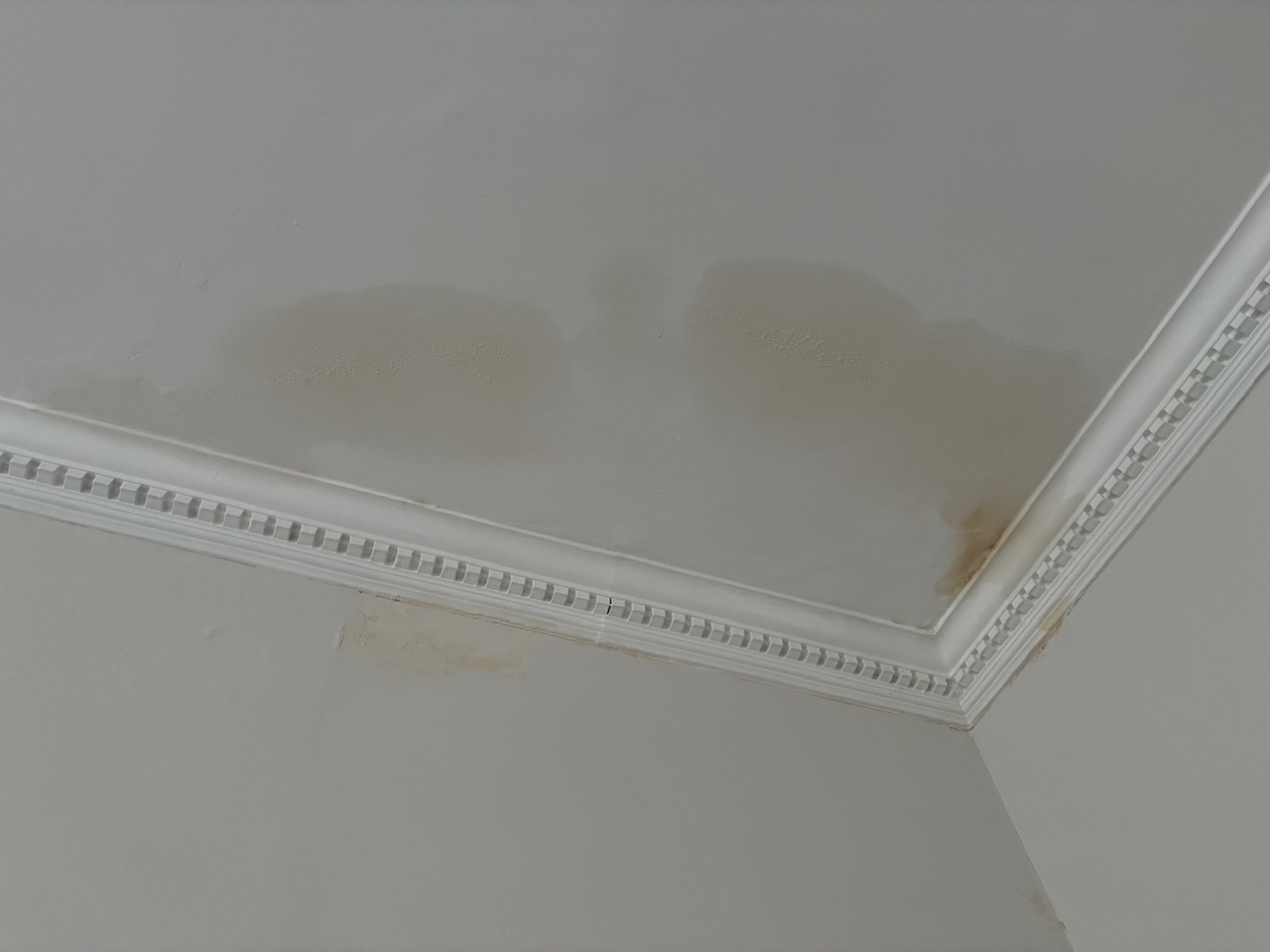

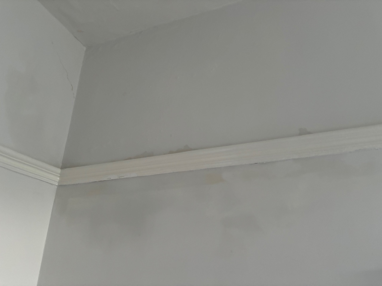

Hoping you can help guide me with some of your thoughts with a damp problem I’m having in two upstairs bedrooms off the chimney.
This seems to have been more of a problem in one room than the other for some time although in our other room the paint was cracking around this area which makes me think I just haven’t been seeing it as much. However since scraping the paint off and repainting the issue is infinitely more noticeable.
Our two bedrooms no longer have fireplaces in them but do have vents which if closed I know can sometimes cause damp. If the vents were open but had a chest of drawers in front of them (not blocking entirely but in front of) is this sufficient enough to cause an issue?
I’ve been up in the loft and the areas in question are covered by insulation which is cold but isn’t obviously wet. The laths and plaster also show no obvious signs of water and there aren’t any obvious water trails to that area.
We’ve had a couple of roofers who’ve both said the most obvious thing is that the chimney needs repointing which we’ve booked although I’m just concerned about the issue persisting after this is complete.
Would you agree with this looking at the pictures of our rooms or is there something else I should be looking at? Is there anything I can do in the mean time as the issue just seems to be getting worse.
Apologies if any of these questions are beyond stupid. Although I’m comfortable with most things this is something I’ve never looked at.
Thanks again.

Damp from a chimney, will most obviously show in the discolouration of plaster of the chimney breast, rather than on ceiling plaster. An exception might be, where the chimney stack dog-legs in the loft, so drips can then drop on the ceiling.

That’s what I thought. In one bedroom it’s very obviously on the wall but here it’s on the ceiling mainly. Would you mind explaining what you mean by dog legs in the loft so I can check. The only dog legs I know are on the golf course!

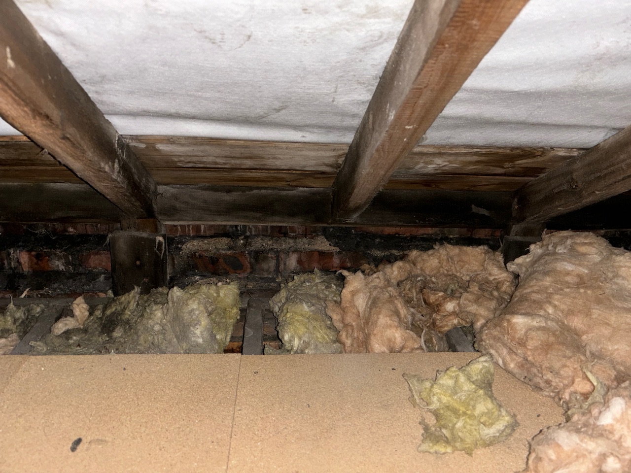

Some chimneys rise vertically, all the way up and out through the roof. Some go up vertically, then the upper part can be offset/not directly above the main vertical part. If enough water were to leak down that offset upper face, it might then drip onto your ceiling.

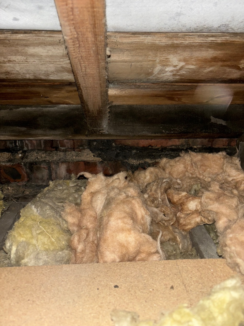

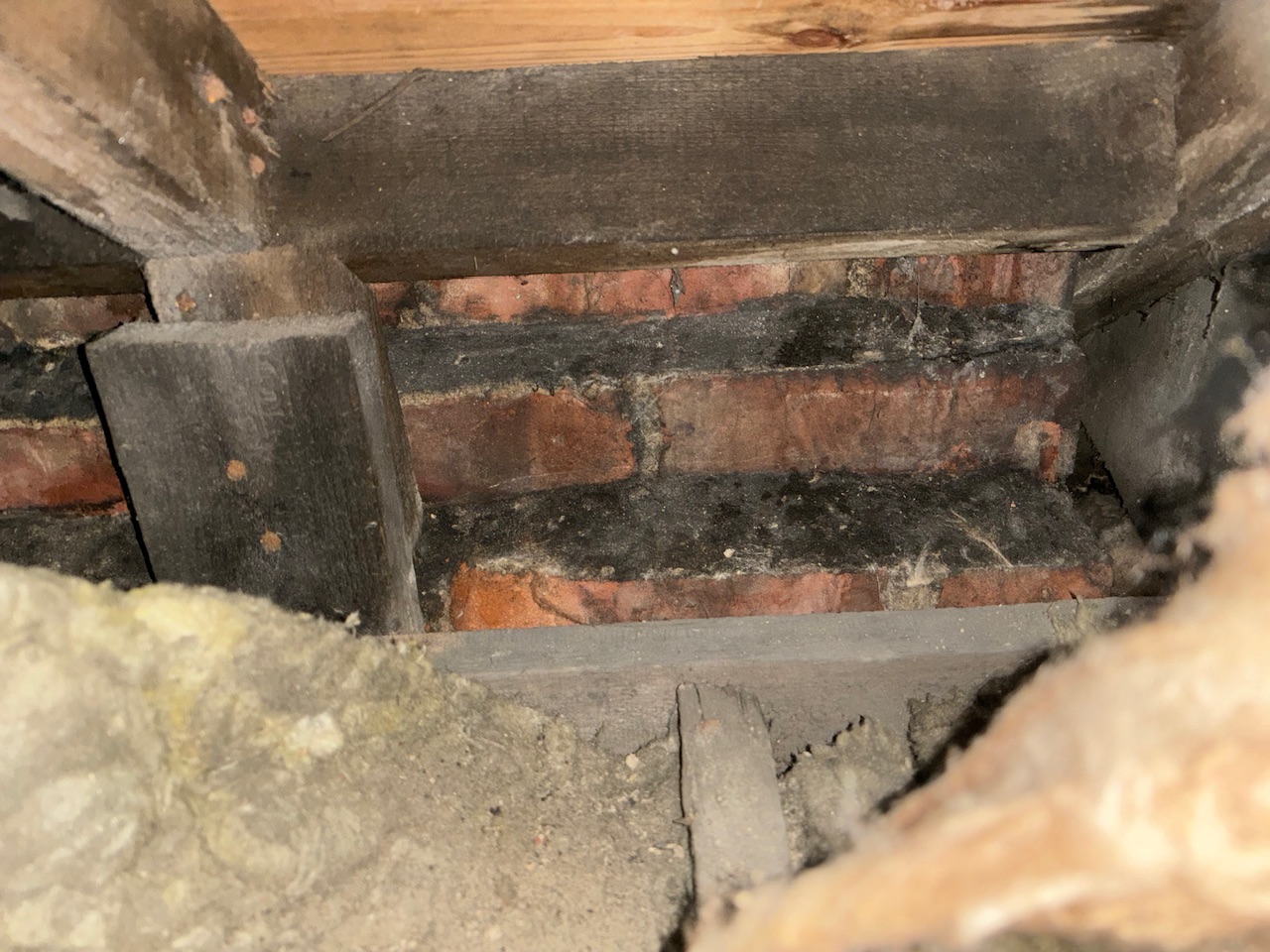

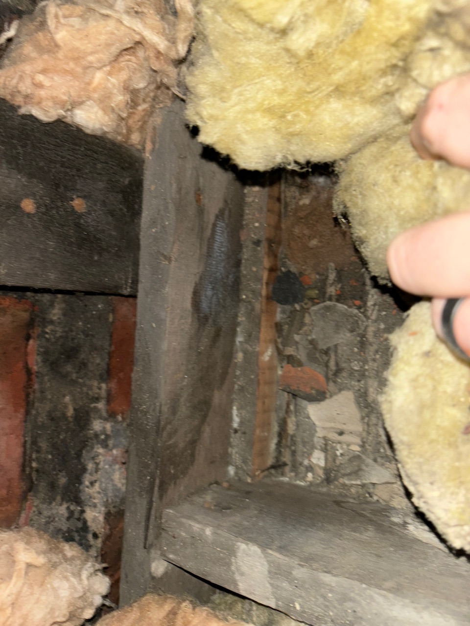

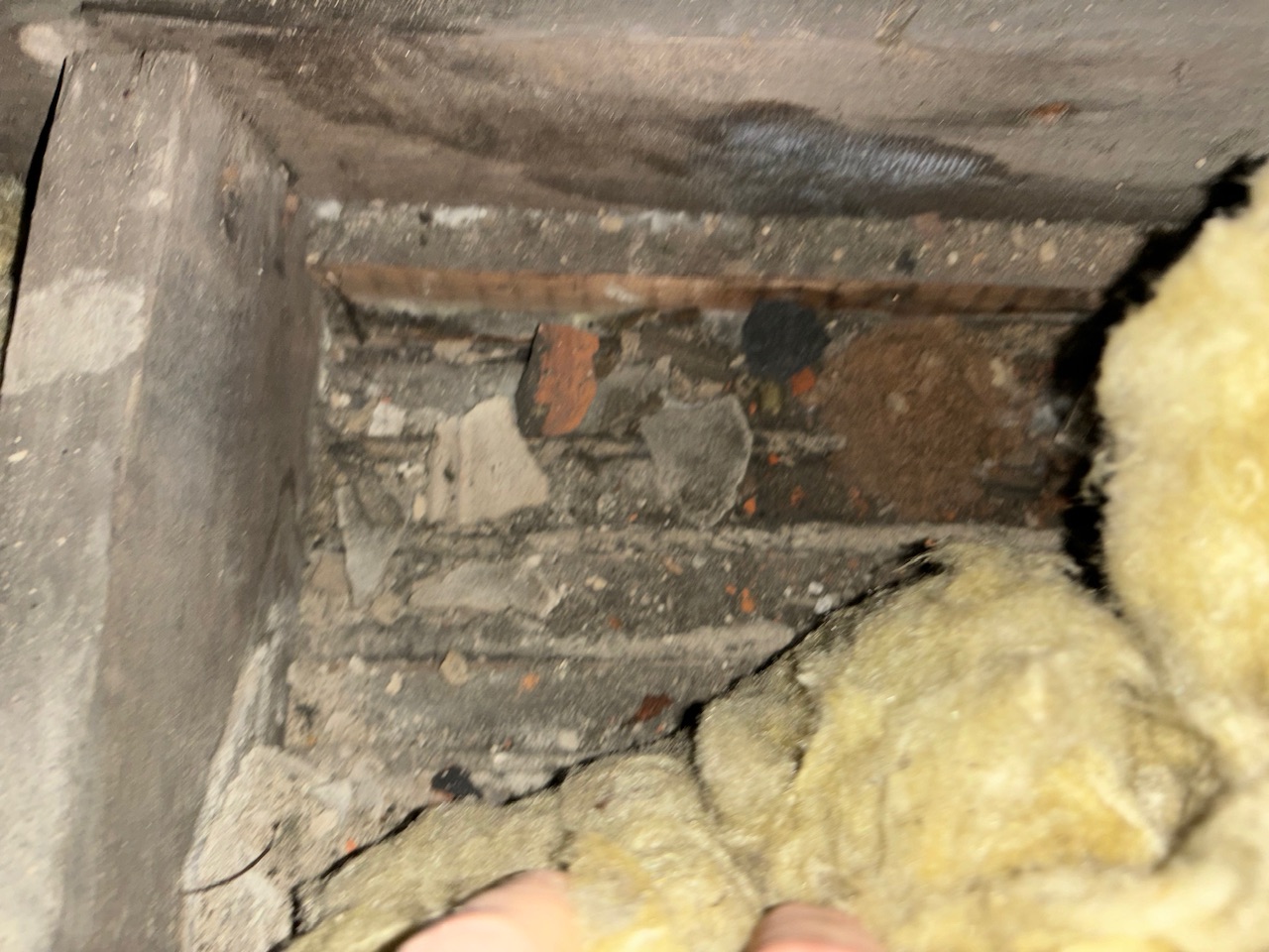

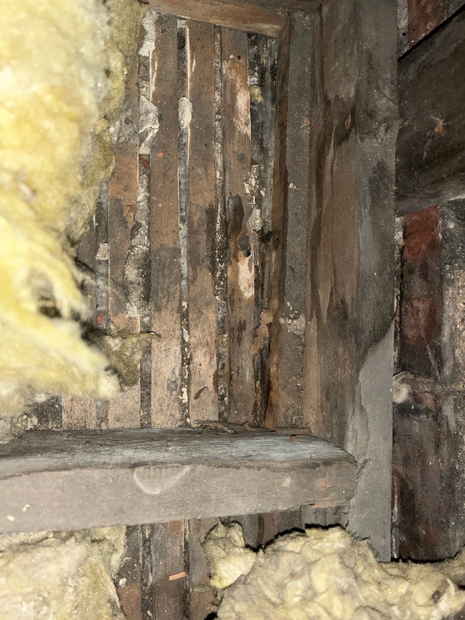

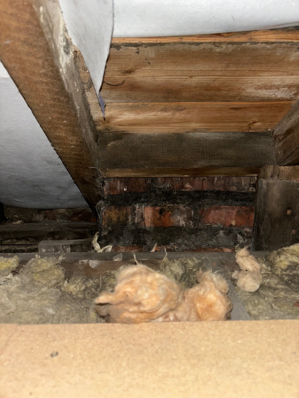

I’ve taken some pictures in the loft to see what you think. I hope that’s okay. (No light up there so forgive the flash).
I tried to take pictures of the stack and also the back of the ceiling of the room I was talking about. Admittedly some of the insulation does feel somewhat damp (or cold it’s hard to tell).

Photos of the chimney stack flashing (especially the back gutter), and also the flaunching will be a great help?
Whoever next goes on the roof should take pics.
Pointing is rarely a cause of stack or chimney breast leaking.

Maybe I've spotted an issue with the pics showing the back gutter boarding and membrane.
Another, probably minor issue, is that the trimming rafters and trimmer have been, unusually, supported by short props.
A few bob well spent is to have all your flues (four?) swept - even the boarded or unused flues should be swept if your unsure of their condition. An appliance with a SS liner is another matter.
