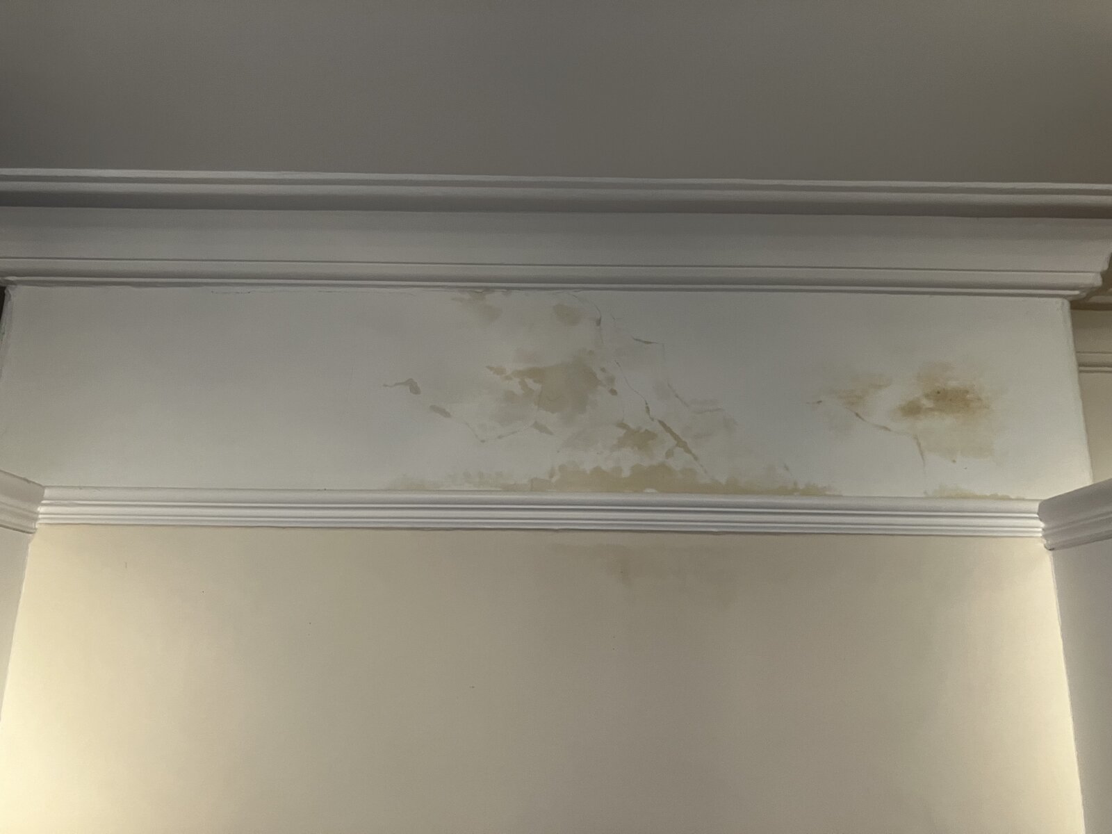

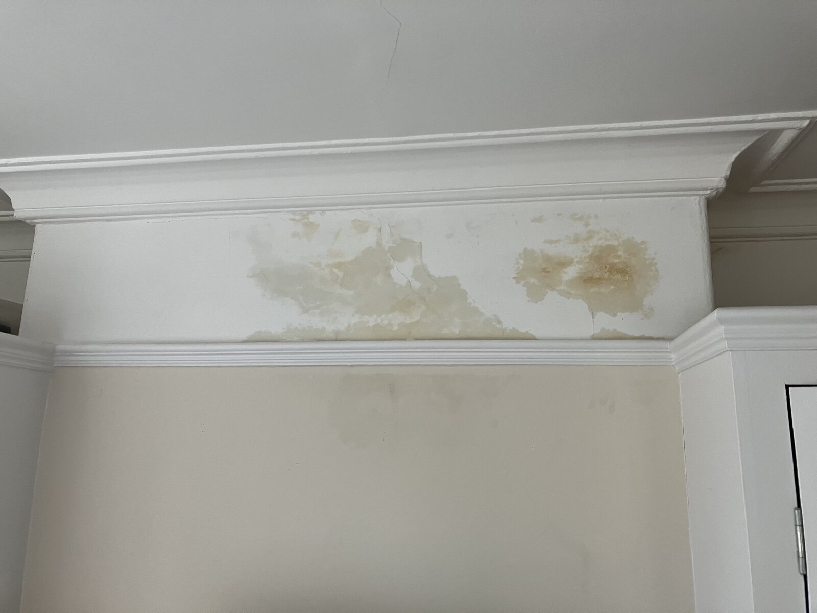

Since then, we've had plenty of rain and we've had damp marks develop on the chimney breast in our bedroom - I've attached a photo of this (1490)

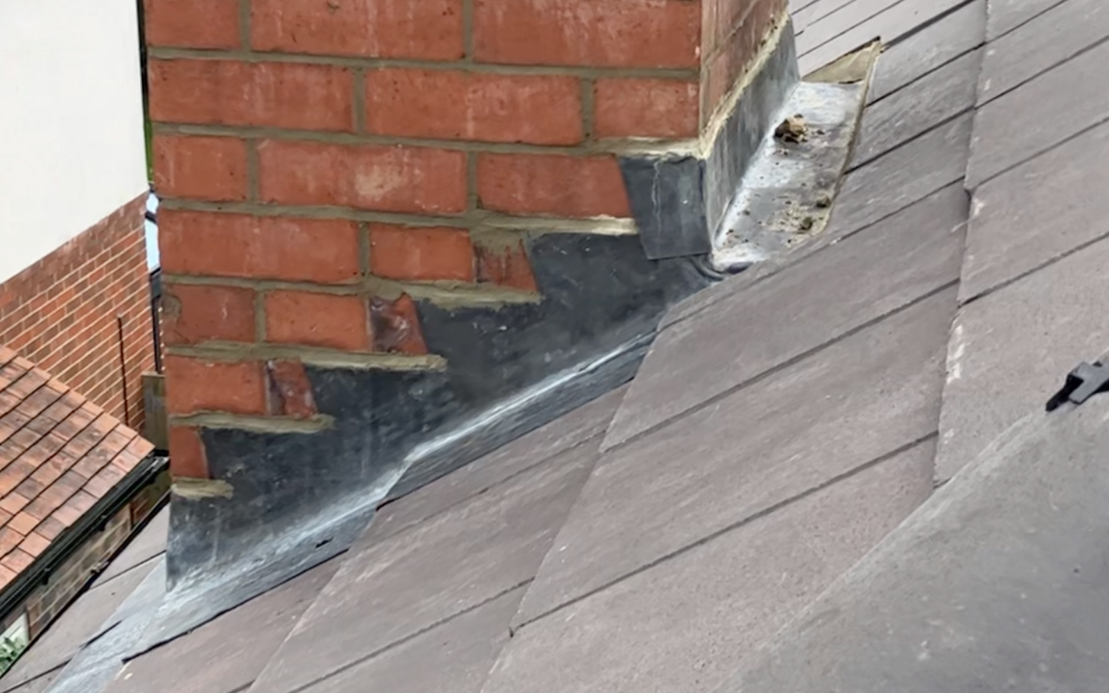

I have been struggling to engage with the roofer who did the original work, so I got an alternative roofer round. He said that the flashing has been done incorrectly on the chimneys for the roof tile that's been used.
I then took a photo of the flashing and sent it to the tile manufacturer, who agreed it hadn't been done right and said soakers needed adding due to the flatness of the roof tiles that have been used - I've attached photos of the flashing (see 1348 and 1349 below)
The roofer who did the original work came round yesterday, peeled back the flashing and essentially said "there is no evidence of water getting beneath the flashing, the roof is all fine. Moist air must be entering the loft from the house then condensing on the chimney and running down into the bedroom beneath. You need to insulate the floor of the loft better and less moist air will get up there".

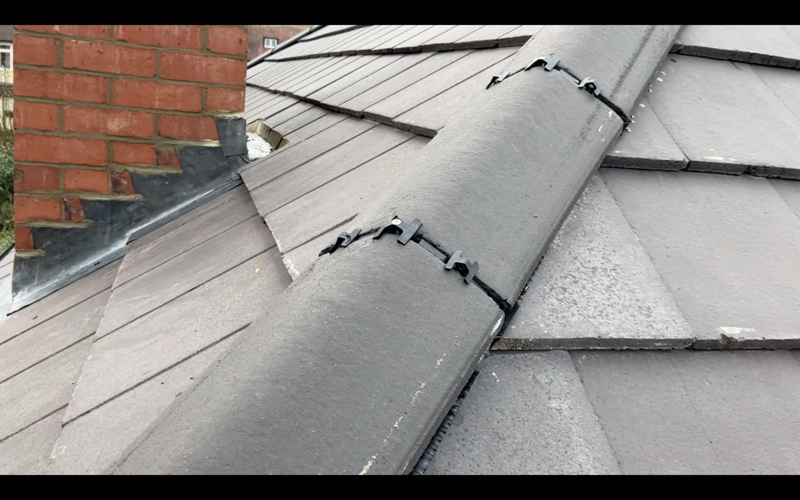

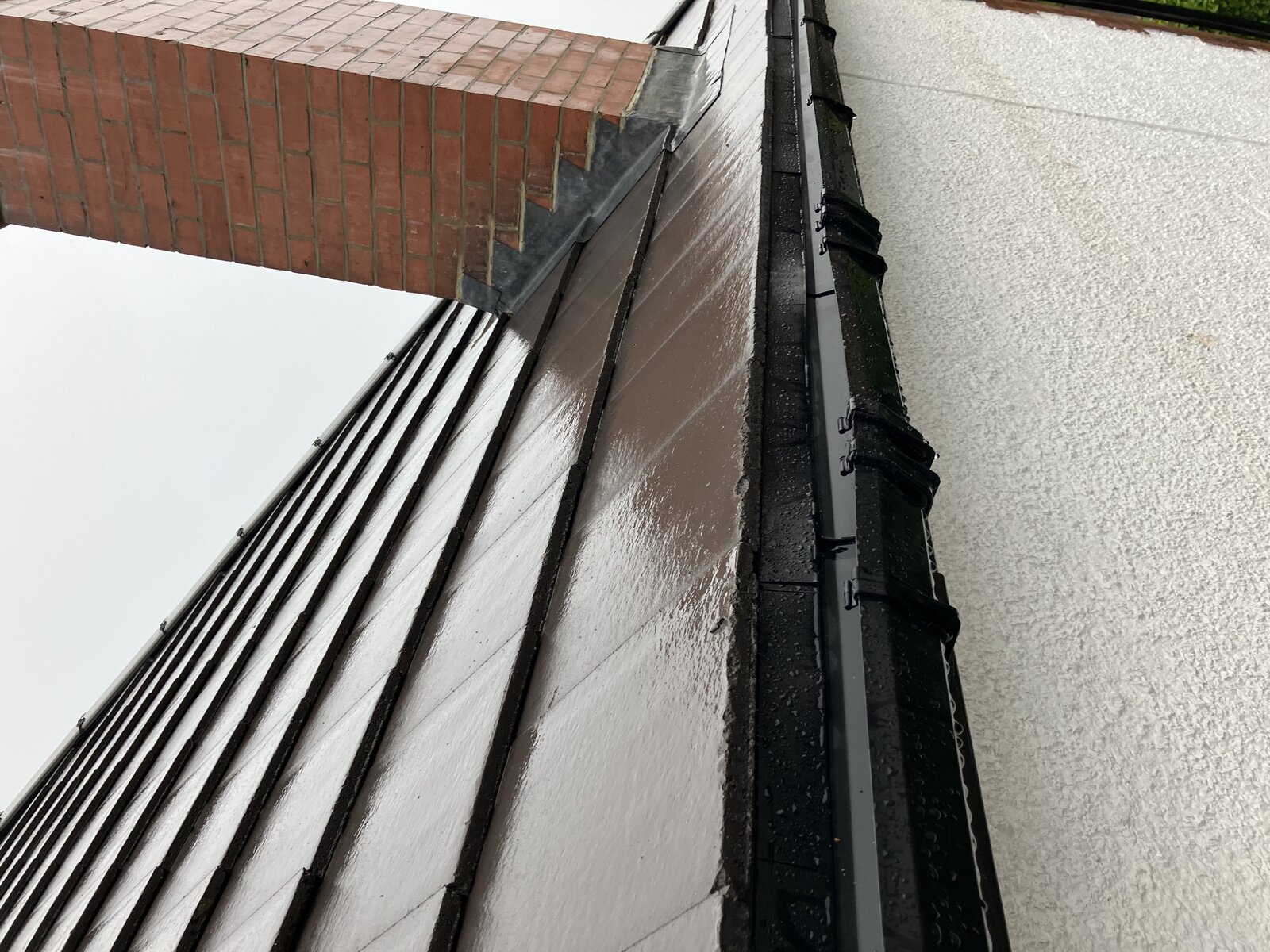

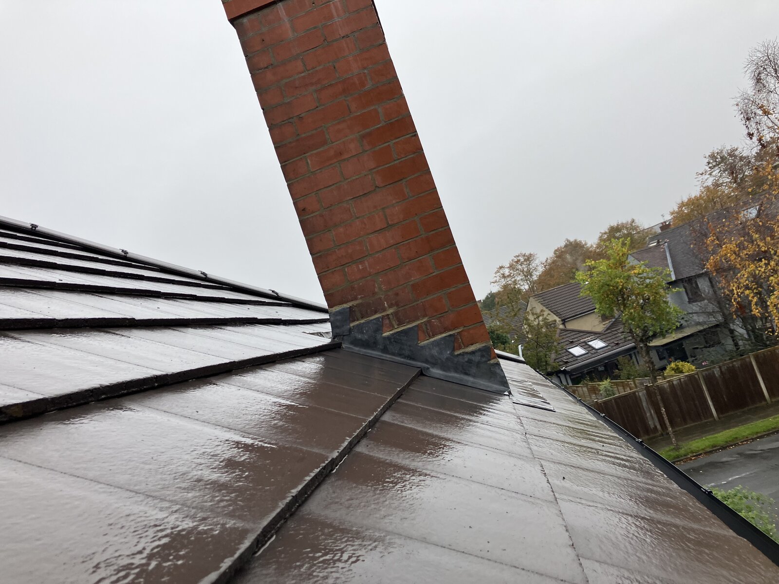

Hi all
The damp marks on the chimney are getting worse by the day. Attached below is:
* A picture of the damp marks this morning
* Two pictures of the back gutter
I've also taken a video of the back gutter that capture more aspect of the back gutter here. Apologies it's a bit wobbly - I was up a ladder with my phone sellotaped to the end of a pole!

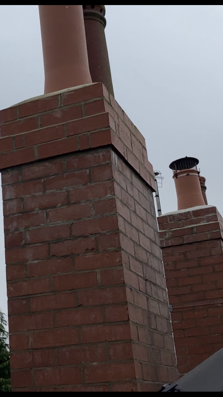

While I was up there I noticed that the pointing on the stack was darker in places and there were streaks on the chimney (as part of the re-roof the roofer re laid the top few courses of the chimney and repointed the entire thing). I'm not sure if this could be related to the issues? I've therefore also taken a video showing the full chimney stack here.

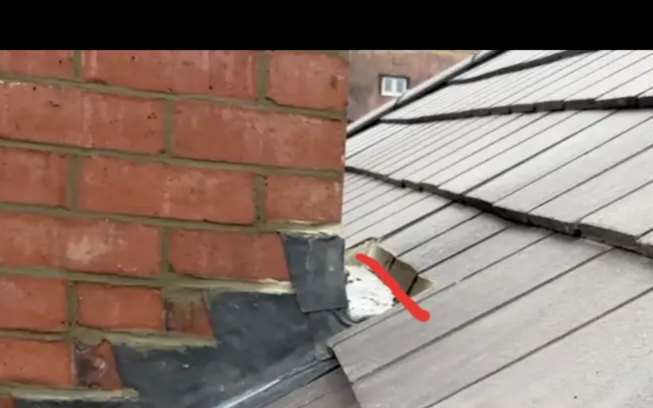

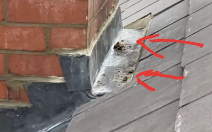

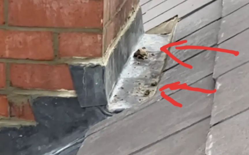

My 2 pennies.
Your problem is where I marked in red.

Hi Woody
The side of the chimney breast that is showing the damp marks is the side that Johnny has marked up in red.

Thanks @johnny2007 - can you see something in particular that makes you think that?
Yes, there's a nice valley there where water can get under the lead.
They should've used tiles on top of the lead there so water would've run to the side of the back gutter.
Unless I am seeing it wrong from the pictures, it looks like they just used some mortar there.

One additional question: the roofer repointed the chimneys at the time of doing the roof. I’ve attached a picture of them below. What are people’s views on the pointing? Look ok? I ask because the different shades look a bit unusual to my untrained eye. Could this be a source of the problem? I don’t think the chimney was painted with storm dry when it was worked on. If I did this would it protect both the bricks and pointing?

Can't judge the pointing from that picture because it doesn't look like new pointing.
Did you see them doing it?
It's extremely unlikely that would be the source of damp.
Anyhow, I know it's unnecessary but I use brick seal on my chimney and redo it every 5 years.
That's because when I rebuilt it, the bricks didn't need any tool to be lifted.
They were just there held by their own weight.
They get a lot of battering from the weather up yhere.

I didn’t see them do it but I think they did - I definitely paid them to! Yes im thinking sealing it would be a good idea
If you get up there it will be obvious if they've redone the pointing or not.
But as said, I don't think that's the source of dampness.
As noticed in the other thread someone mentioned the flashing is the problem and I agree.
You will have to get up there and lift the back gutter flashing and the tile course above the back gutter, and see if the roof felt is arranged properly then re-set the felt, the back gutter and the tiles.
With those tiles soakers are needed at the chimney stack sides not extended cover flashing.
Take a hose pipe on the roof and water test everything as you go.
The pointing is a bit of a red herring. Its bad but its not the problem.
