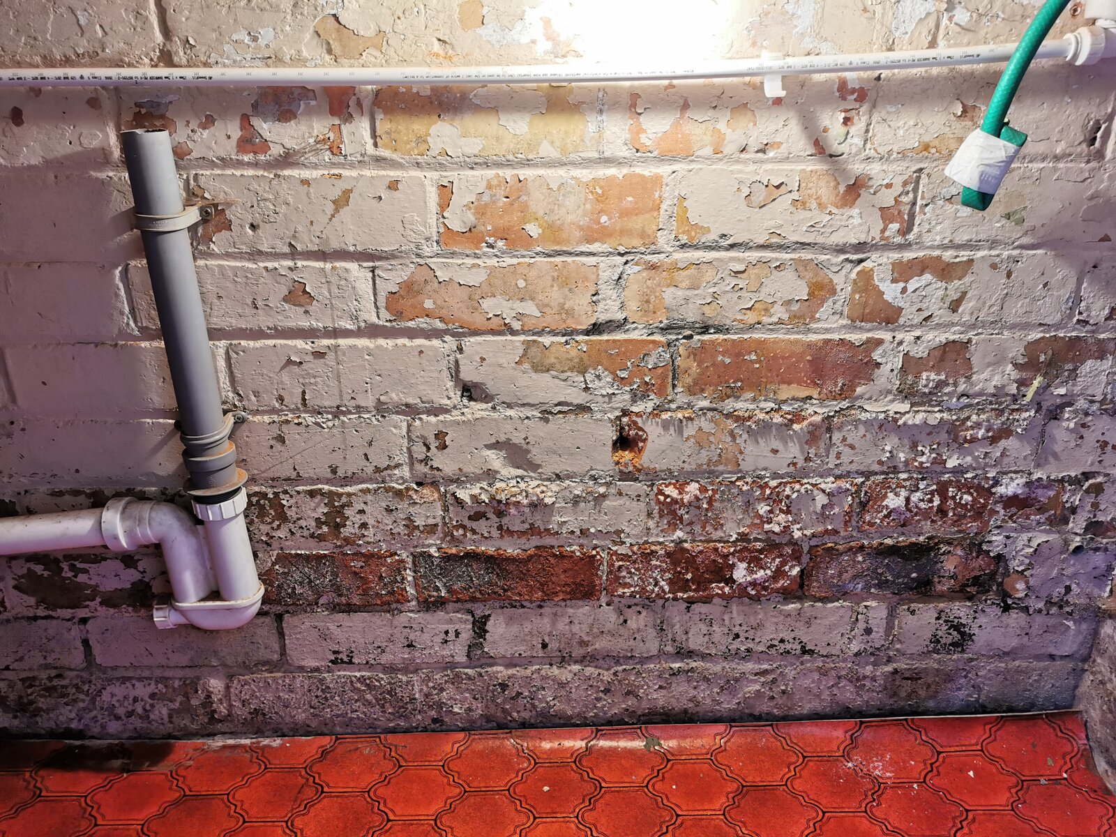

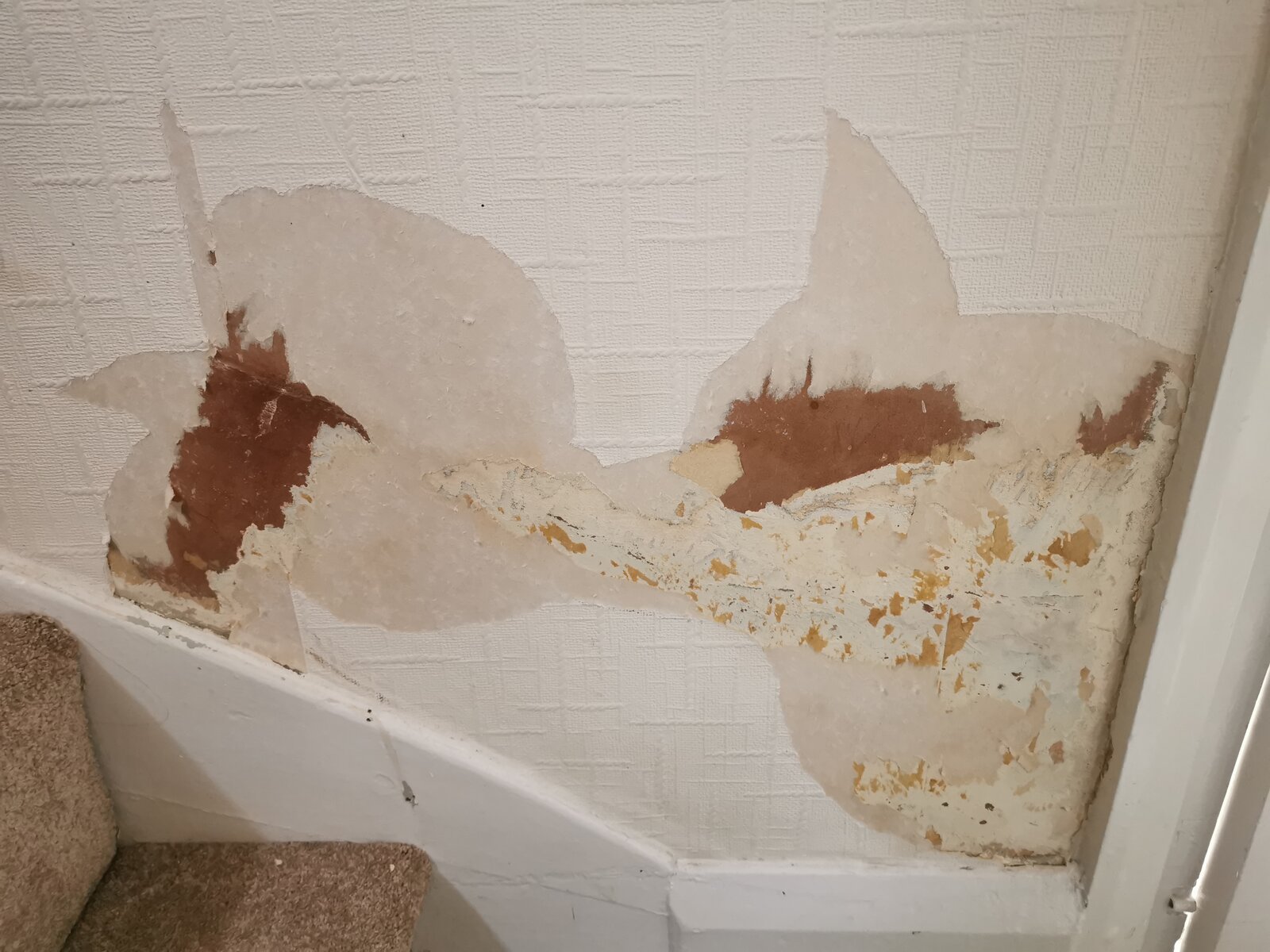

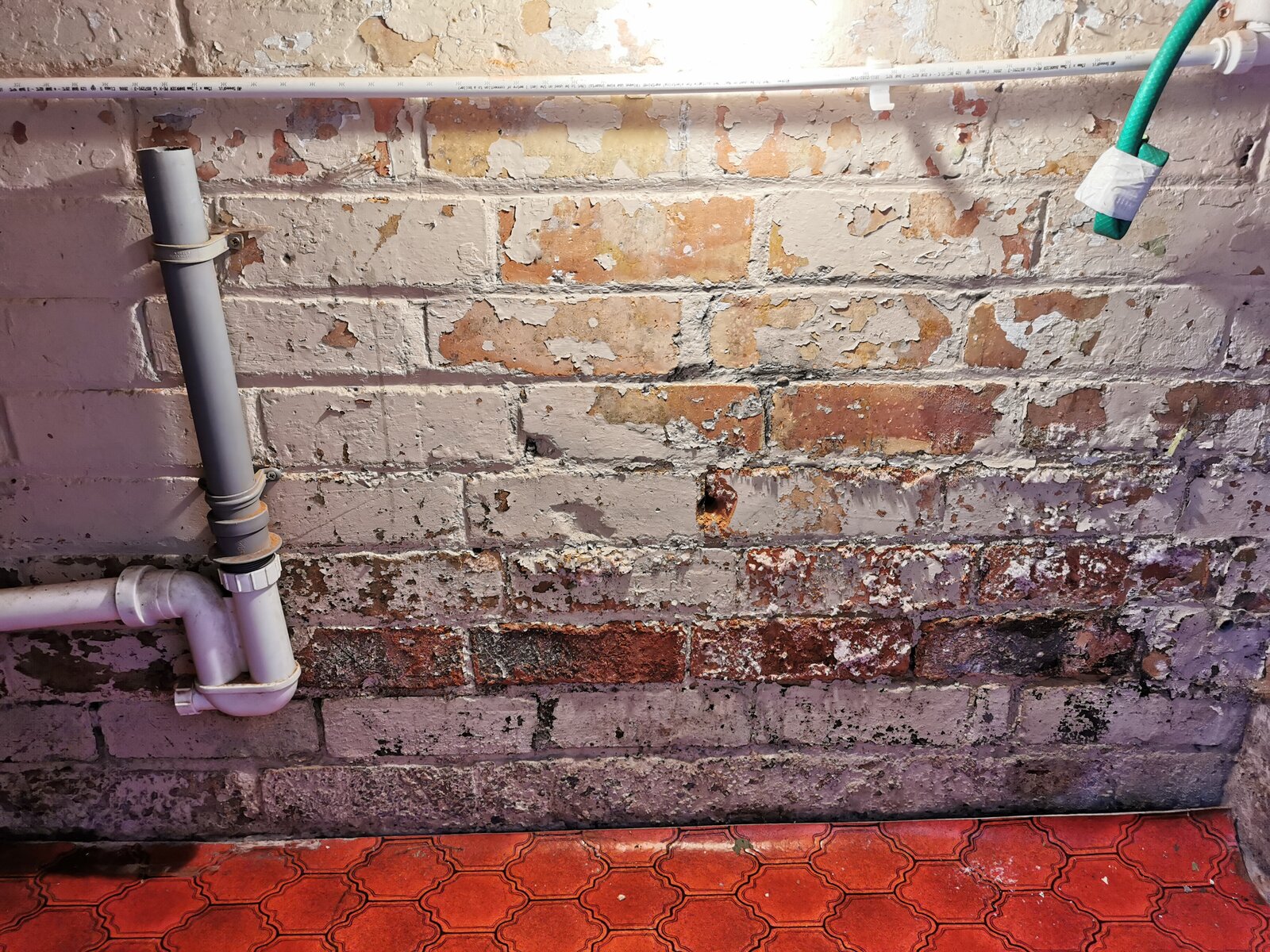

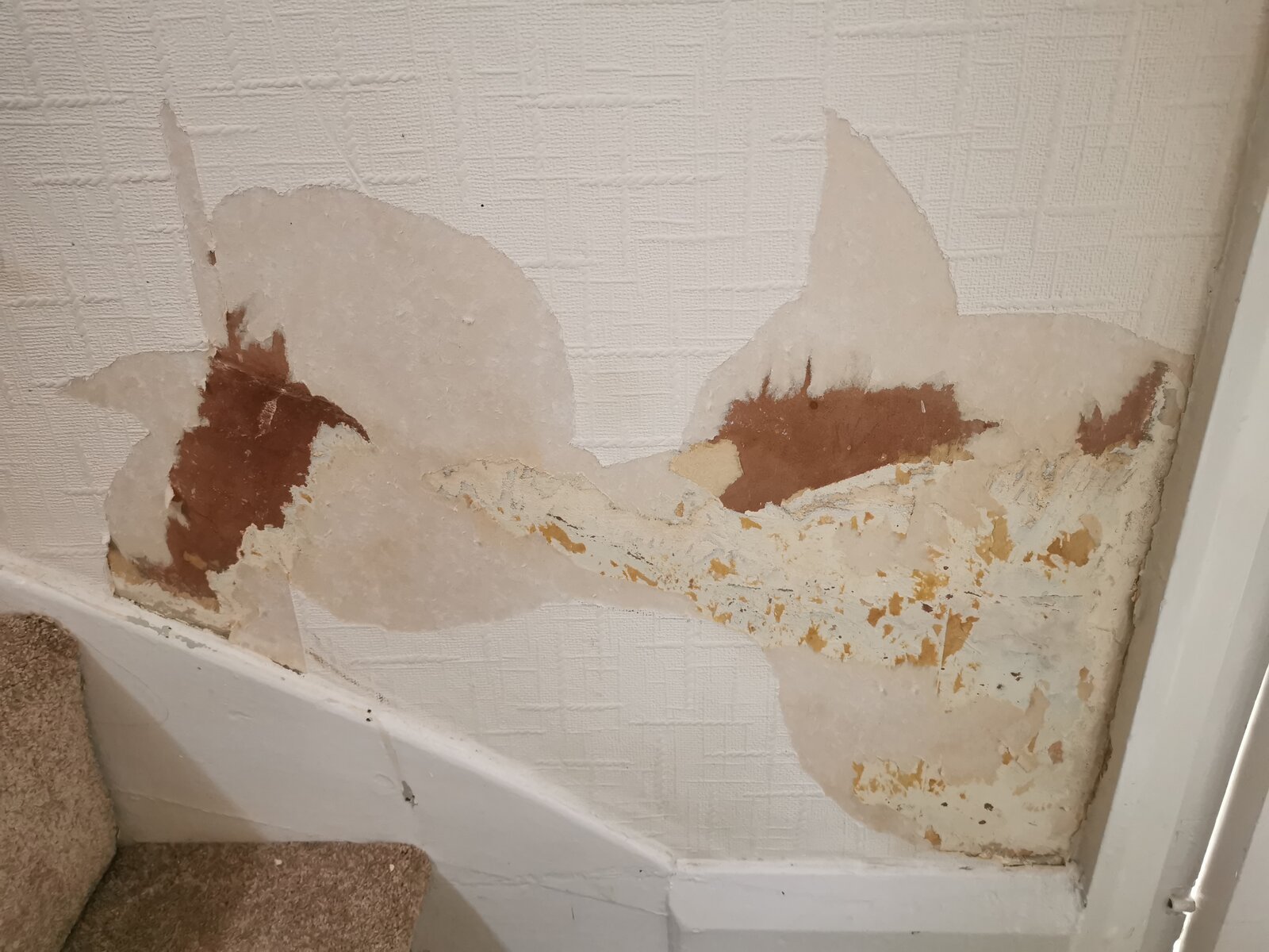

We are renovating our 1930s semi which we've just moved into. We have a patch of damp on an adjoining wall to our coal shed. This is under our stairs. I've tried to attach photos showing the damp plus the coal shed wall this correlates to the other side. The damp isn't mould, but is tacky and damp plaster.
I have done some googling and feel this could be rectified by removing the plaster down to brick, putting a dimpled membrane on the wall, battens, and insulated celotex/kingspan plasterboard, before replastering.
My only concern is with the coal shed wall. Its flaking, there is residue, and I think its pretty humid in there. Would a stormdry masonry cream be appropriate to apply on this?
