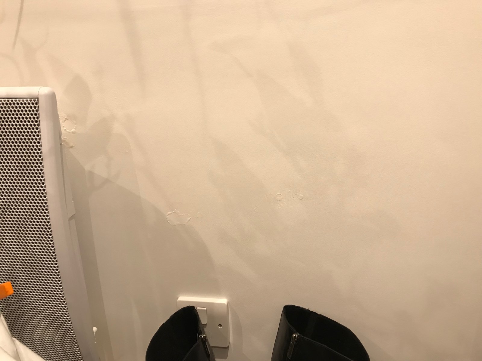

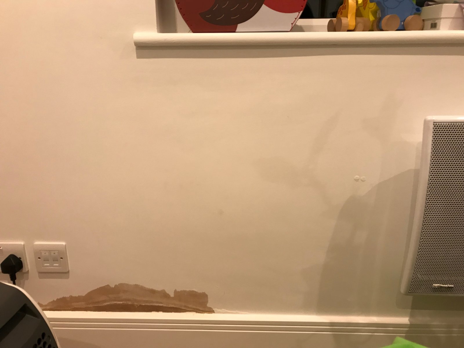

Hi, this is a bit complex so ill try and keep it brief!
- Wall had obviously suffered damp when we moved in 2 years ago
- Since then we have had the house externally insulated, new windows installed (pushed to edge of walls), and room re-skimmed.
- Ground level outside the affected area is about 3ft below internal floor level
- House is solid 9" masonry, with no cavity
Unfortunately there is one fairly large damp patch, and also where the fixing points for the old radiator was the paint has lifted, as well as a couple of other areas underneath the window.
Everything to the sides and above the window is dry.
My theory so far is it is a roof defect, and water is getting in and then running down the outside wall of the house (pebble dash) behind the external insulation, and stopping where the old base rail height was, and from there it is coming through the wall.
I have had a roofer out, but I am far convinced he was any good, and the water ingress continues.
I am finding it harder to explain why the spots where old fixings underneath the window into the wall have had the paint lift, through a new layer of plaster.
And advice greatly appreciated, as I am really lost on this one!

It's less likely to be roof related if the problem area is below a cill.
It's more likely related to the frame/cill or render below it, or is an issue with internal humidity as is common with external insulation placed over external render.
Does this appear or get worse after rain?
Thanks Woody,
The room shouldn't be very humid as nobody currently sleeps in there and we don't dry washing inside. In fact I have been de-humidifying the room to try and control the big damp patch.
It most definitely gets worse after rain - it only began just before Christmas when there was heavy rain and very strong westerly wind. Since then both have continued, as has the problem.

Got to be the window if it's not the roof, Windows have drainage holes, are you sure they come to outside? It's not uncommon for them to be siliconed up causing the water to fill up and overflow somewhere it shouldn't.

Looks more like you have a drainage channel on that window (rather than specific holes like on the window in the LHS of the pic).
Do the oversills go right to the back of the drainage channel? Is there any chance that water from the drainage holes could be going underneath the oversill (in between the oversill and the existing sill)?
If it has happened more frequently during a strong wind it could be that the wind is blowing water on the sill back into the drainage slot and then going under the oversill, to the edges of the existing sill, then off into the wall?
I had external insulation fitted a few years ago, and was concerned about this exact problem (the fitters just shoved plastic oversills into the drainage channels). In the end I had a separate company replace them all with aluminium oversills (which were much thinner), stuck down with CT-1, and sealed at the edges. Still not ideal - the only 'real' solution IMO is for them to have fitted undersills instead of oversills.

If the center of that damp patch lines up with the widow jamb, then that's a suspect.
it certainly is, directly in line on fact. The window company have been to take a look, and wonder if they forgot to silicone the join between the sill and the window.
In answer to nebjamin, the sill is the proper one for the window - the windows were in fact fitted after the insulation (lack of budget before insulating), but your point is similar to the possible issue.
So when the window company come back, they are going to seal the gap between the sill and window. The window is face drained so they think this will be fine.
And then we see if the wall dries out.....!
