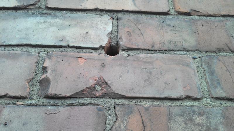

We did have cavity wall insulation put in about 12 months ago and I have only recently noticed that one of the holes the cavity wall guys drilled was missed when they were filled in. This hole is on the outside wall which is suffering from the damp/condensation patch in one corner, could this be the cause? e.g. cold air in cavity causing inside wall to be cooler than expected resulting in condensation forming?

The hole you refer to, it's probably only 20 to 30mm( irrelevant) - a little plug of sand and cement will fill it.

I didn't discover the holes until around November/December just gone and the weather hasn't been great so was leaving them until this time to fill in. They are quite high up the holes, above head height so aren't immediately noticeable. They are pretty large about 1.5 cm diameter so about the size dann09 mentioned are these holes really irrelevant or could they be allowing colder air into any gaps in the cavity and thus causing the issue? I am reluctant to remove bricks.. pretty novice DIY'er but would the way to do this be to use an angle grinder? My father has told me removing bricks sounds easier than it is.

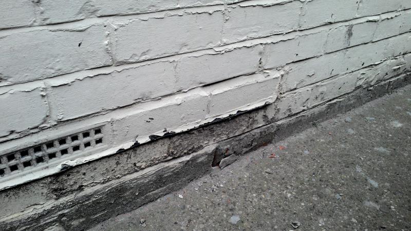

look to see that the airbricks are not blocked, and that the path is not above the DPC

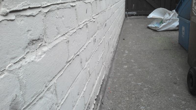

here are some photos of the wall outside and the DPC and the area where the marks are inside.
The wall has a chimney breast and the damp marks appeared in the cornrs near the chimney breast and the corners of the room (4 marks). I immediately opened windows to ventilate the room and when we got our radiator back on immediately heated the room up. 3 of the areas affected dried out but the far corner at the back of the room hasn't We haven't really had any rain here and as you can see from the photos its pretty dry.
I have tried to keep the temperature of the room at a decent level (20 celsius) indeed we aren't using our central heating anymore as the weather has recently been quite mild.
I have checked all the air bricks with a screw driver and whilst there were some bits of dried debris in some of the holes they weren't overly blocked.
Hopefully you guys will be able to identify the problem better from the photos. I also included a photo of the hole thats on the gable end from when the cavity wall insulation was put in.
You may also notice the DPC seems to stop suddenly, does this look like the DPC hasn't been fully installed by previous owners? Would you guys recommend i get this done down the whole gable end side of the property? The DPC seems to stop about a meter away from where the condensation/damp is forming inside. Would it be a pricey job to continue the DPC along the rest of the gable end?
The last image of the inside and the marks the part of the wall on the left in that image is the outside wall the part of the wall on the right is an internal wall.
does water lie on that concrete path in rainy weather, or splash up e.g. from a dripping gutter?
Is the wall on either side of that slat dpc newer, e.g. an extension?
Hi when it rains it lays on the path there is no guttering as it's a flat/straight gable end. The slat from the dpc isn't part of an extension no its part of the original structure but it looks like a previous owner filled in a window on that corner. There was a lean too shed on the side which I removed 4 years ago since then this side of the house has been exposed but never had any problems until now.
