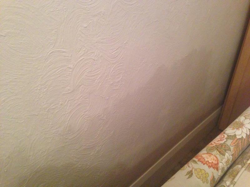

Question for you.. My mum lives in a 1930s two storey block of flats.
She's upstairs and has always had a little damp and sometimes mildew in the corner of the second bedroom (has an outside wall)
Anyway she decided to redecorate so she rubbed all the wall down (it has swirly type paint pattern on it, not full on artex but a light version if that makes sense) she applied polycell damp seal in the corner and all the way up that corner and along the wall about a couple of feet up from the skirting board.
She then applied a few coats of dulux matt emulsion after a few days.
All fine until last night the wall was soaking
Damp from bottom to top of that corner and along the area she applied the damp seal
So it's almost like it's made the problem worse!!
Any ideas why this may have happened? And anything we can do in the meantime before we get someone in to look at the cause?
The landlord had previously damp coursed the outside so not sure what's happened
But it made my mum cry on Xmas night after all her hard work
Gutting
Photos attached (I hope!)
Any advice massively appreciated
Thanks guys
Gem x

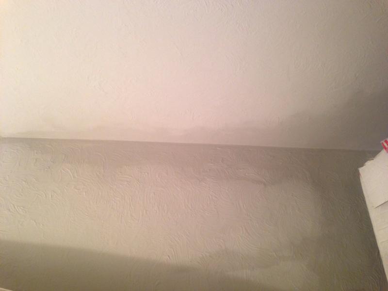

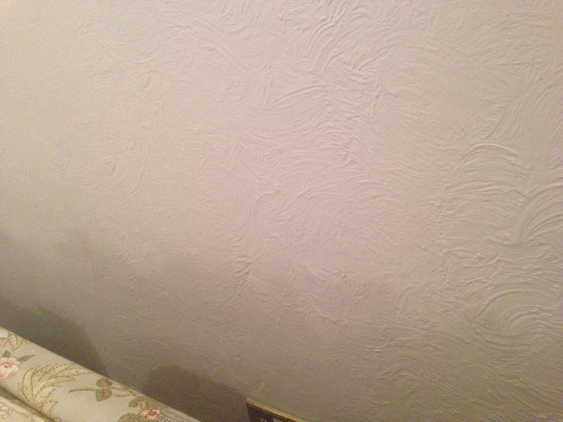

In your photos, which way is up? Sorry the damp is along the bottom by the skirting board and the end photo needs to be rotated 90 degrees clockwise with the most at the bottom and then rising up that corner.
Where is the window? On the adjacent wall front aspect so as you walk in this damp wall is to the right and the window directly ahead.
What is on the other side of the wall (e.g. gutter, downpipe, overflow) none of these just a plain flat wall - solid and not cavity walls.
None of the internal walls get it.

This wall is an outer wall
Render could be cracked outside, or gutter blocked / rain pipe leaking maybe. Landlord's problem.
Dampseal will stop damp coming through if the cause of the damp has been identified and rectified.
If the cause has not been rectified, it will not work.
