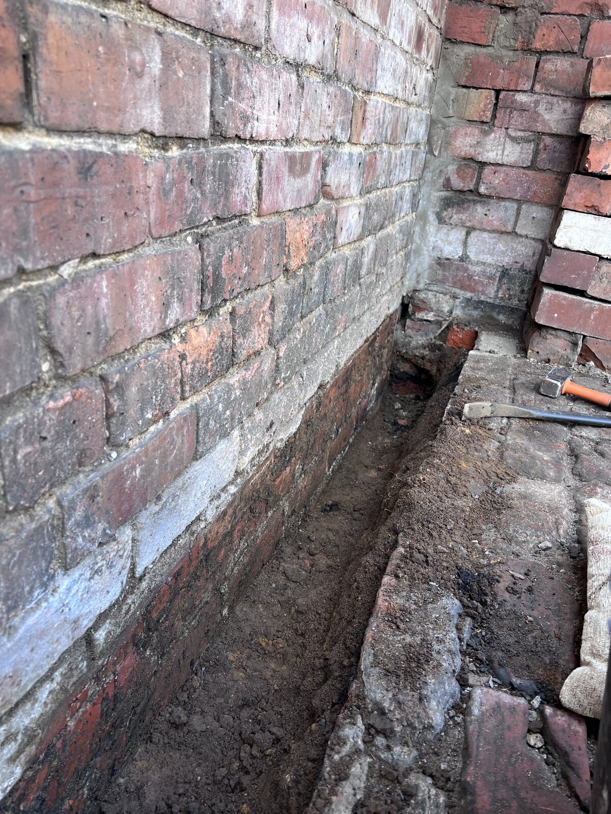

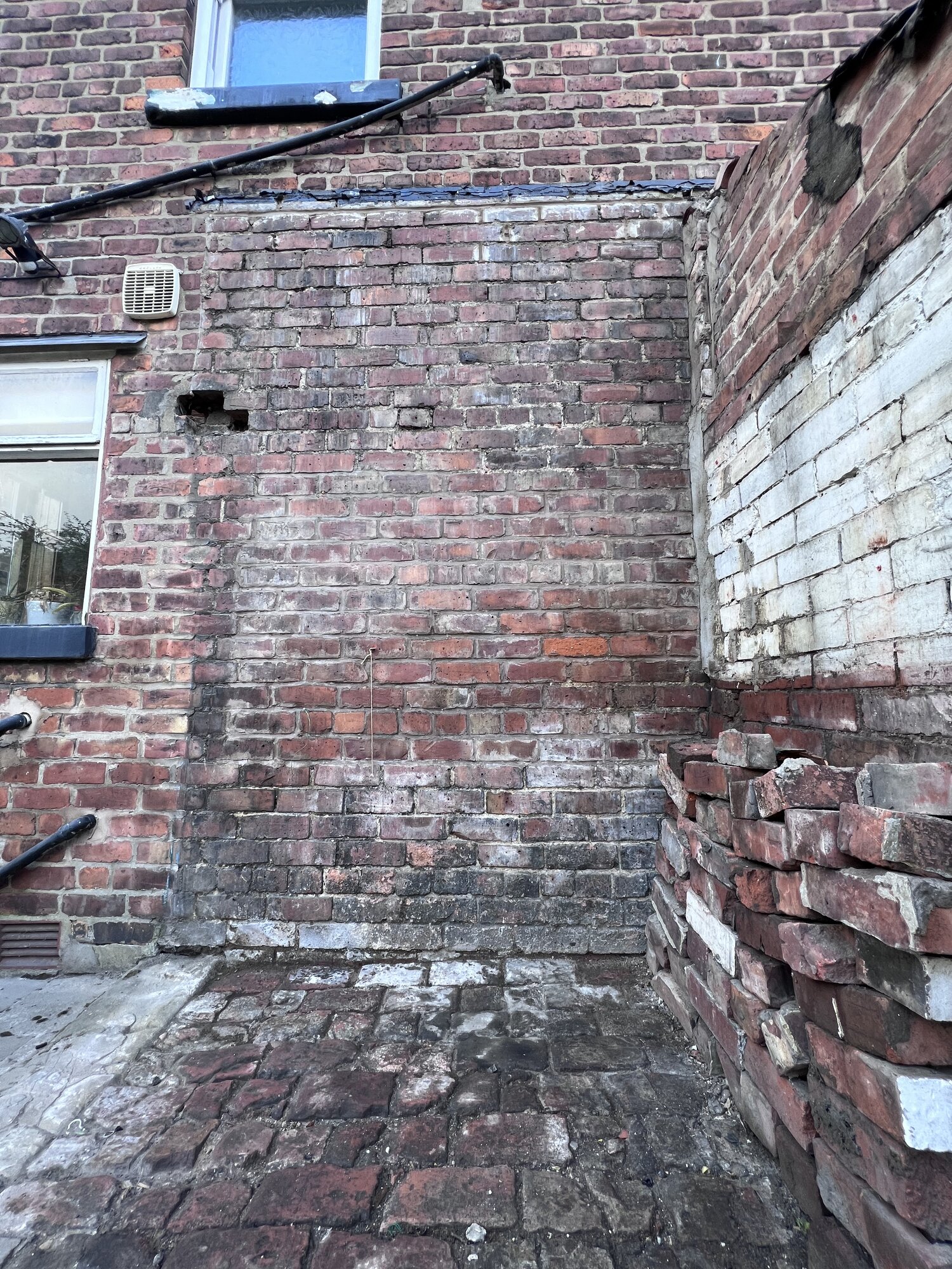

Hi all, looking for some advice regarding a damp spot in the kitchen before I call on a damp specialist.
Whilst ripping out the old kitchen in my Victorian terrace I noticed what looked like rising damp in the corner of the exterior wall and the party wall, behind a corner unit (pictures 1 and 2).
The kitchen floor is entirely wooden, with the exception of a concrete slab in the exact location of the damp spot. The slab is what I assume the old wood burning stove in the kitchen was sat on before the previous owner removed it and the chimney. The floorboards and concrete slab were covered by FIVE (!!!!) different layers of lino - it’s like looking back in time via the medium of terrible kitchen flooring.

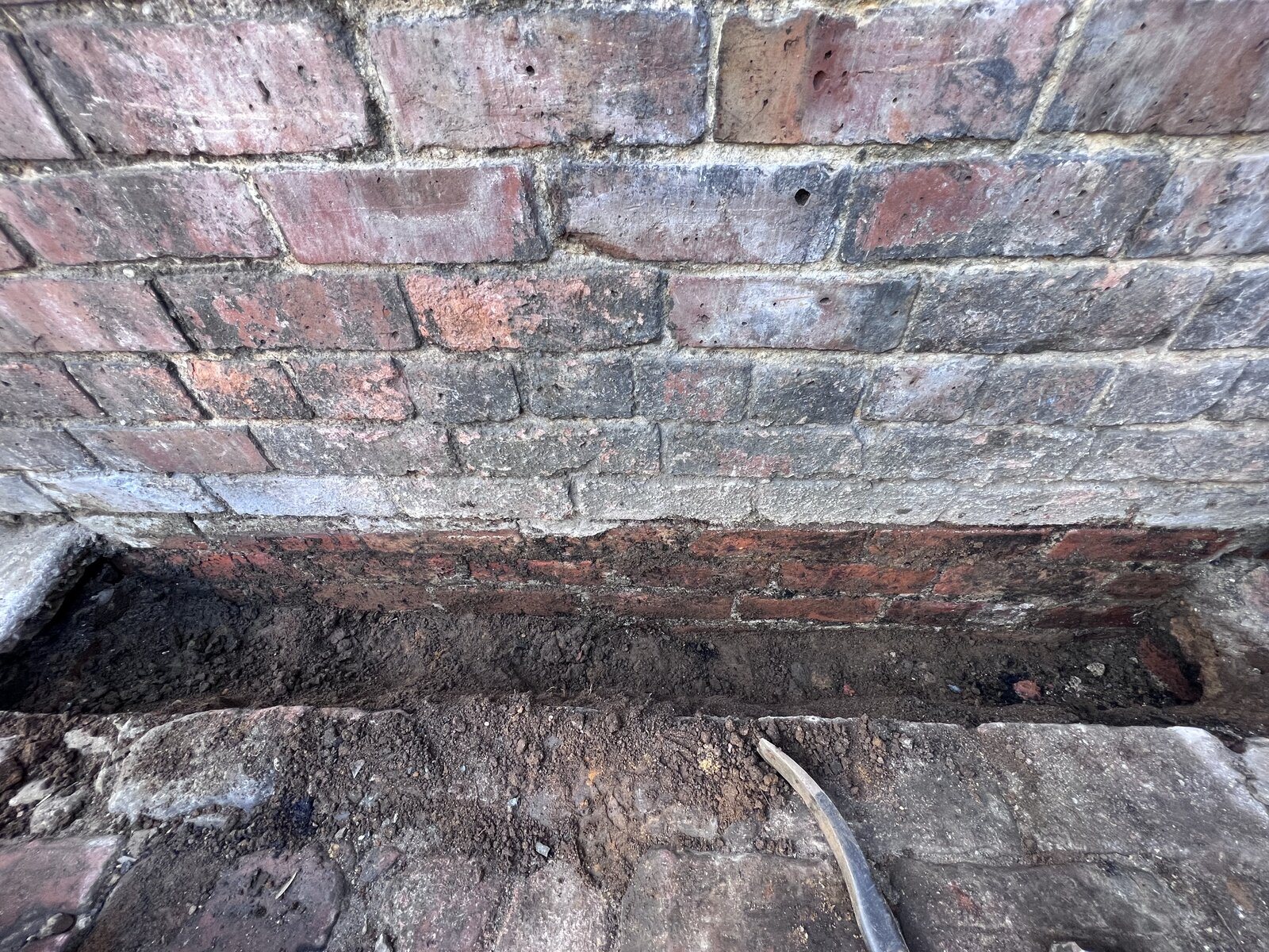

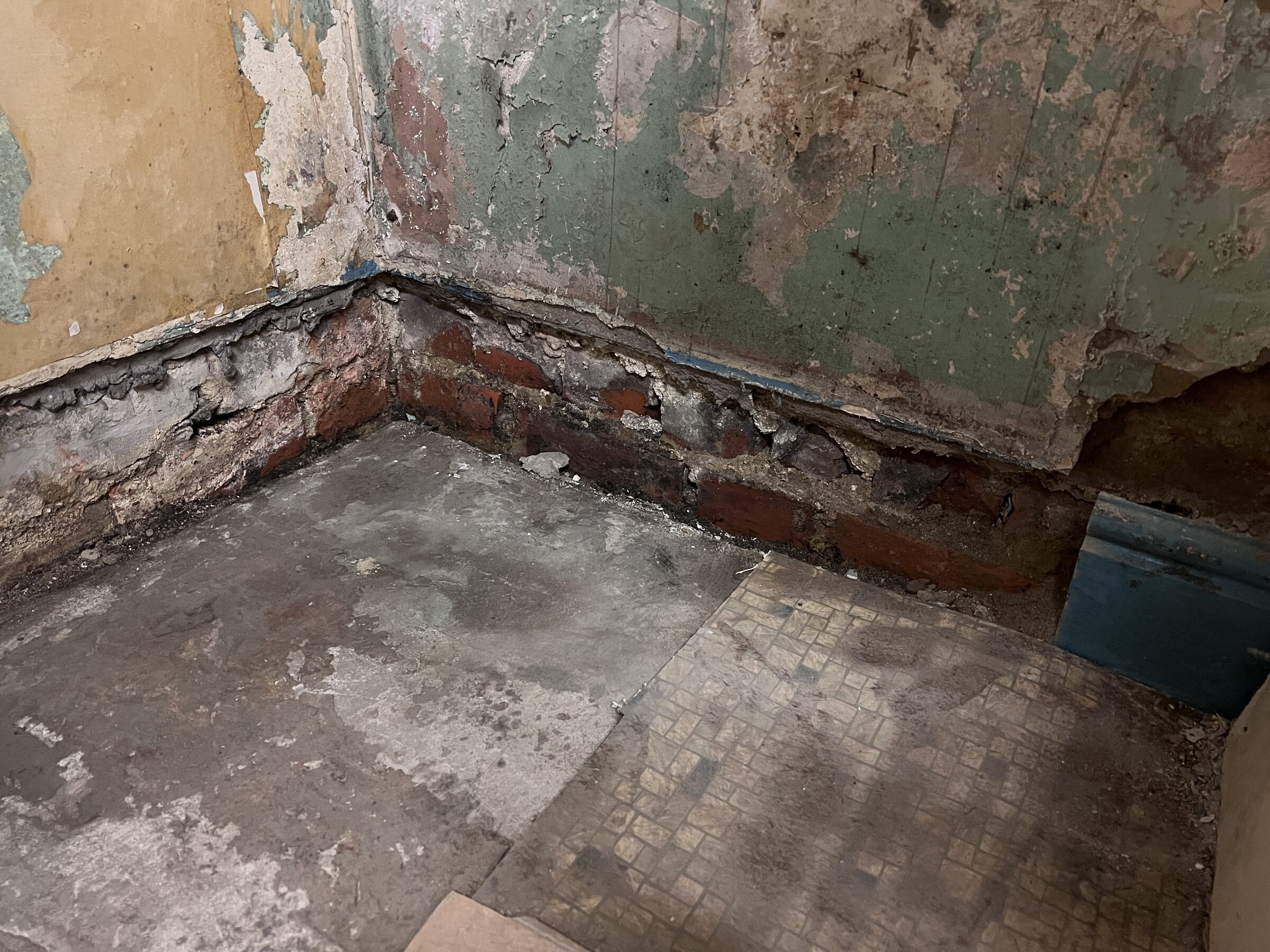

The exterior wall where the damp section is was previously inside the outhouse, which I pulled down last month so has been sheltered from the elements for most of its existence. There is some effervescence (I think?) on the exterior wall (picture 3). Picture was taken at night, can upload some daytime images if needed.
What could be causing the damp? Is it a coincidence that the concrete slab is right where the damp is?
Any advice would be much appreciated!

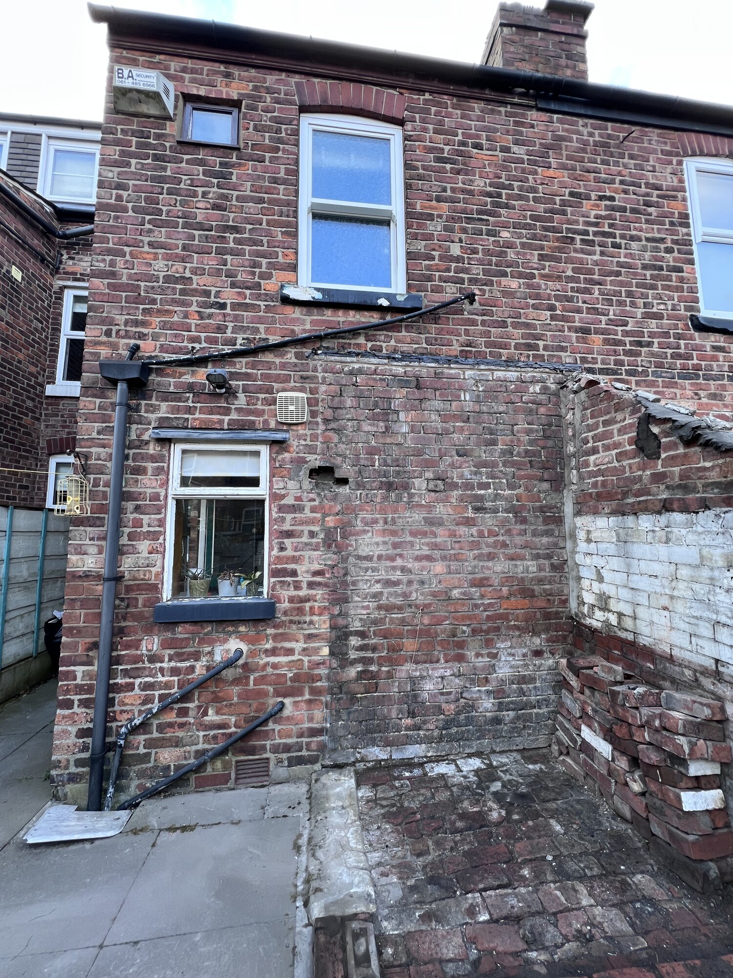

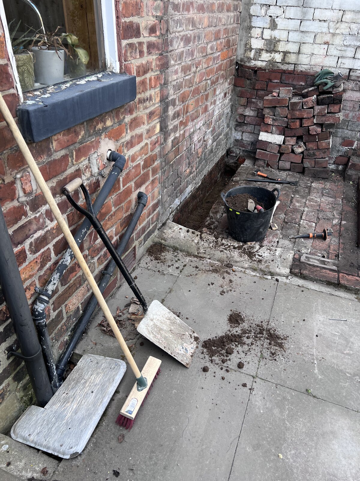

Pictures from the outside showing guttering and down pipes.
Andy
Hi Andy, pictures of guttering and down pipes attached. Walls are solid brick 9 inches thick, I don’t think there is a cavity. Hole in the wall to the right of the kitchen window is a pocket hole for the outhouse timber so doesn’t go all the way through, and wall beneath this is completely dry.
Looks like the ground is too high where the shelter was and I would advise a drain cctv on the drains/gully.
Andy

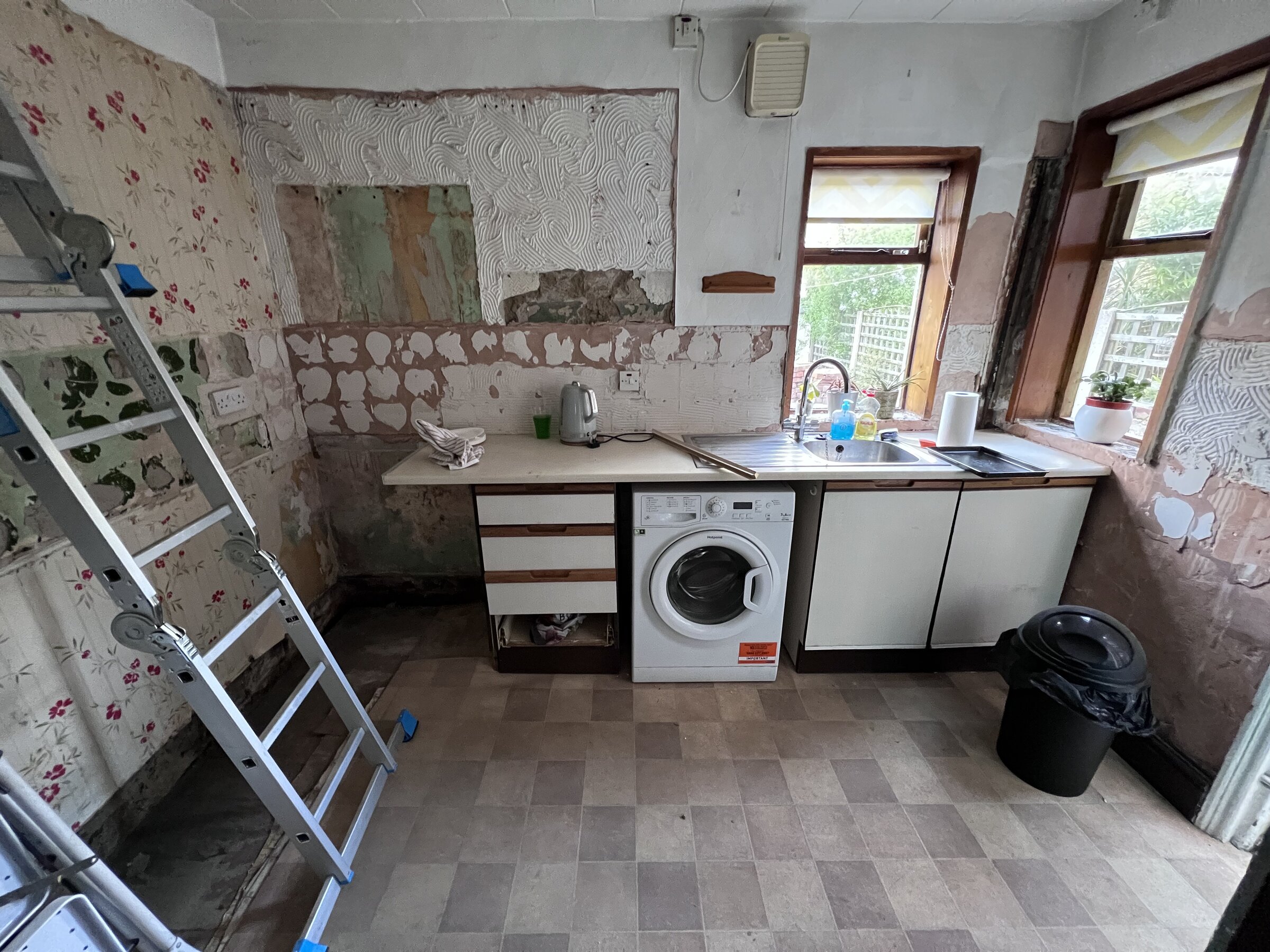

Picture of the kitchen appliances attached. No pipe work seems to run near the damp patch, it all runs down the right side of the kitchen from the boiler in the bathroom above (I’ve exposed it, to the right of the window in the picture).
Interesting re. the concrete slab possibly being there to replace rotten wood! I’d assumed given position of chimney (can be seen in pictures in my response to Herts P&D) that this concrete was essentially a foundation for the chimney which was once there.
No water meter, I’m on rates. Main water feed runs from the front of the house under lounge and dining room floor then up to boiler in the bathroom, so don’t think the water mains is leaking, but I suppose I wouldn’t know without a meter?
Noted on the PCA Surveyors - ended up down a wormhole on this forum last night, spent hours reading a thread originally posted by Softus on the topic of rising damp!
Couple of initial thoughts: i) the ground outside in the right hand corner appears to be higher than anywhere else, and may even be higher than the floor level inside; and ii) the concrete slab is likely the coldest surface in the room, so condensation is likely to accumulate there. Would appreciate your thought on the above.
Andy
Yes you’re right, pretty clear from the third picture that the outhouse brick floor is higher than the ground level elsewhere. What could a possible solution be? Dig up brick floor and pave at a similar level to the slabs, maybe install a French drain along the perimeter?

When you dig the trench for your French drain, there is a good chance you will discover water and be able to track back where it is coming fro .
Look for red worms or wild tomato plants which indicats drain leaks
Line mortar between bricks often washes away near a leak. Look at yours below ground level, you can hose out the mud and repack with stuff mortar mix. I use cement mortar below ground, even in an old house. It will not be "breathing" in the ground and will resist water.

Thanks John, I’ve now dug out a trench to a depth of 3 bricks to assess whether there is anything going on below ground. Mortar is intact and solid and no distinction between condition of brick and mortar below ground on the right side (where the damp is inside) and the left side (no damp inside).
Given no visible issues below ground and lack of Down pipes or drains on that side, would you suggest next steps may be to dig up concrete floor inside? Or wait and see whether the removal of the raised ground outside makes a difference?
For peace of mind (and given half the trench has now been dug!) I’ll likely install a French drain anyway.

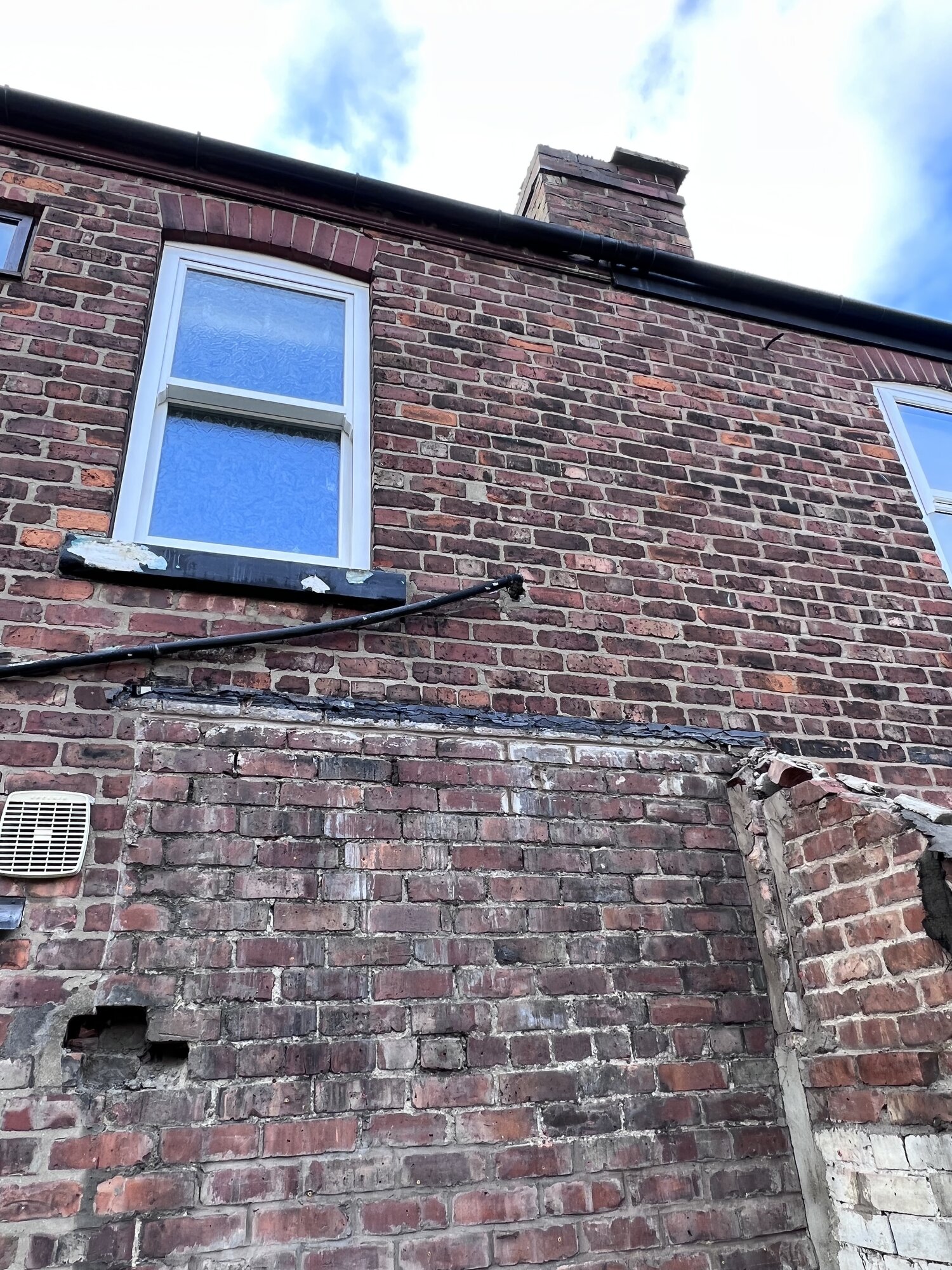

Looks to me like water has been running down the wall in that corner.
Could there have been a gutter or flashing fault?
Overflow pipe?

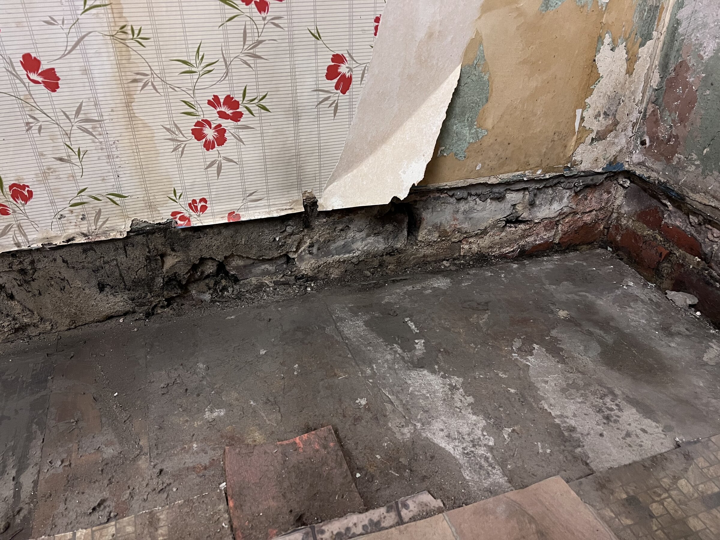

OP,
1. Remove all appliances, base units, skirtings & wall paper throughout the kitchen.
2. you need access to knock off plaster to at least 1m high where damp shows on the walls.
3. Crack out the slab & dig down to oversite level.
4. Examine for rot all wood flooring and joist tails in or near the walls. Crawl the floor if its possible?
5. post pics of any suspicious damp or rotted areas.
6. the exterior pointing on the kitchen wall & the return wall needs raking out to 30mm deep & re-pointing with sand and lime.
7. can you ID any DPC in the wall?
8. clean out the trap in the gulley.
9. remove the piled loose bricks away from any house walls.
10. clean off all mortar smears, and replace missing bricks.

In the process of extending the trench to the gulley at the mo, will then leave it for a week or so to see if it makes any difference and will update the thread if so.

Absolutely, lead flashing on the outhouse and the outhouse roof itself was knackered. The roof timbers were very rotten when I pulled the outhouse down. So it’s highly likely that water has been running down the wall where the outhouse was.
Gulley looks in decent nick, though is a bit murky and full of leaves. Probably makes sense to get someone out to inspect with a drain cctv!

Thanks Tell80, kitchen will be taken back to brick and floors ripped up to investigate further inside. This might have to wait until next weekend though! The original lime plaster has been over skimmed with a gypsum plaster, so that can’t be helping the moisture content in the wall either.
Repointing exterior walls is definitely on the agenda, but I’m getting French doors fitted in the back wall so will wait until they’re fitted and brickwork has settled before repointing.
I haven’t identified a DPC no, though I understand in these types of properties it was usually slate in the mortar below the interior floor level, so might be tough to spot?
Will keep the thread updated with progress!
