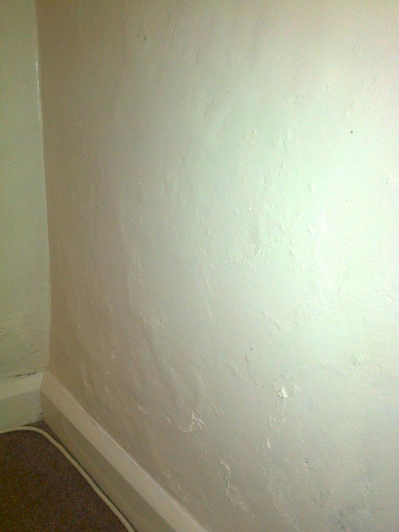

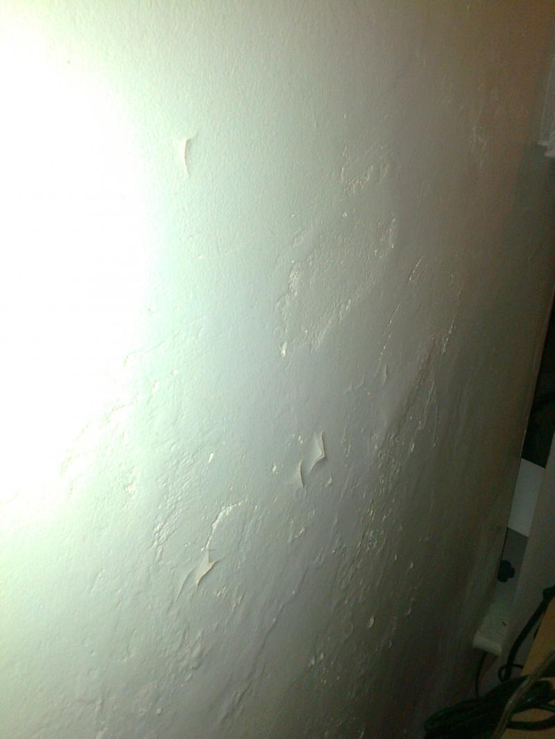

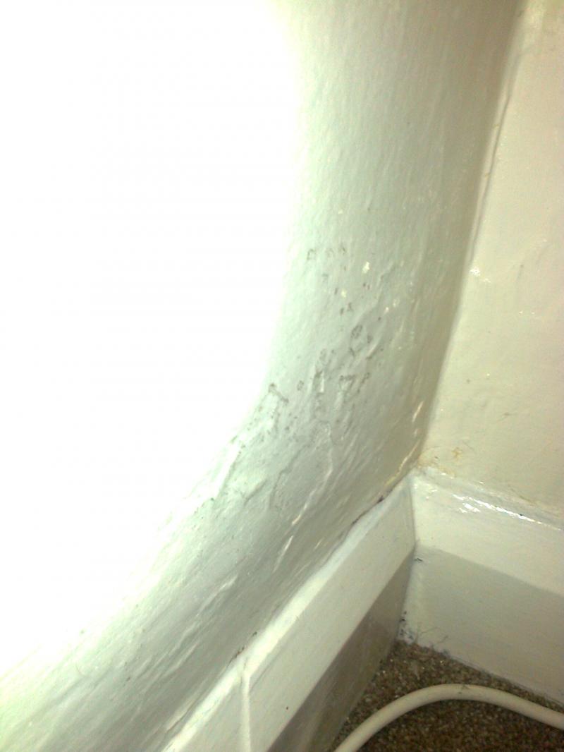

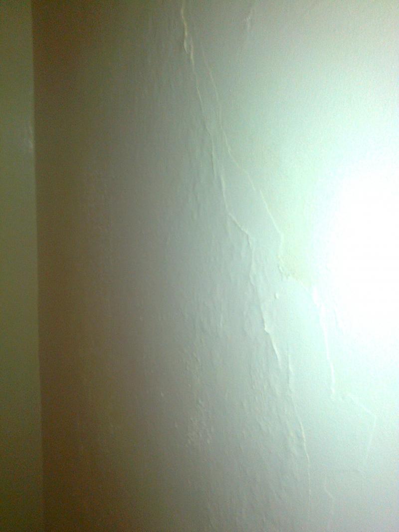

Hi All,
This is my first post so please don't flame me too much!!
We bought an old 1860's detached cottage back in August 2011 (first home), it had just been decorated and had some tanking / damp proof work done on a downstairs wall which backs onto a garden.
Recently in the upstairs main bedroom we've been getting mould growing on the walls which seems to be spreading between a corner and the window.
Also, the windows in the morning have a lot of condensation.
I've had a look around the web and seen a lot of things about dehumidifiers (already have) / increase ventilation (tried)/ heating (tried) / insulation (solid walls, layer in roof) etc etc but thought I'd show some people on here for some impartial advice before I ask a builder who will no doubt give me a quote for £1000's.
So, help much appreciated as to what to do / where to start?
Rob
It is inevitable that you will get condensation on cold windows unless the room is hugely heated ( to heat the glass) or massively ventilated to take away damp air ( and lots of heat )
I would ( and have in the past ) simply put up with daily wiping of windows/cills as the alternatives are too costly/uncomfortable. Good double-glazing is a solution.
WAll problem would probably be solved by putting up an insulated stud-wall with min 50 mm polystyrene boards ( 100 if you have space ) between the studs.
Have you got fireplaces that have been blocked - you can`t beat a working chimney for ventilating :idea:

To prevent condensation you need to increase ventilation or reduce the moisture in the air. As you are suffering from condensation in only the upper storey this points to lack of ventilation.
