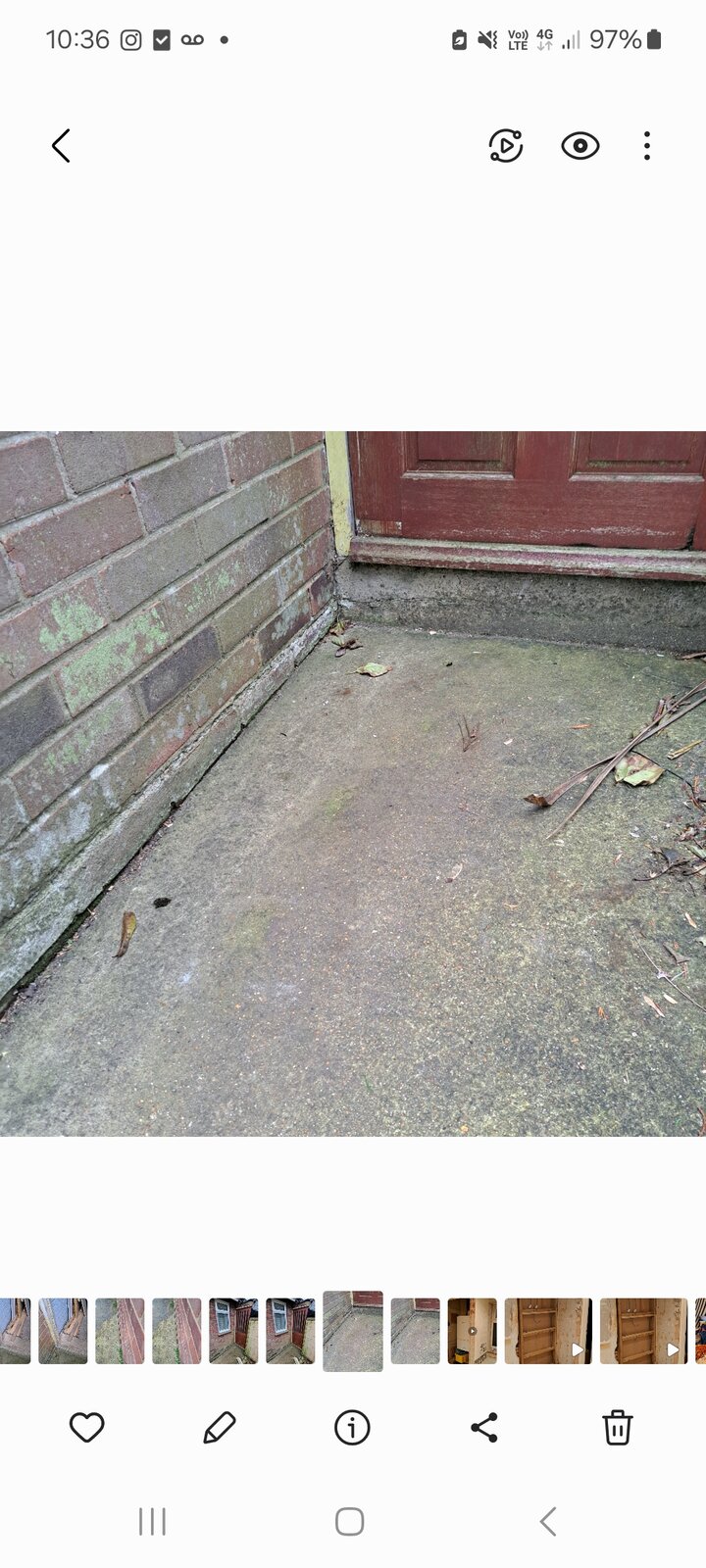

We bought our Bungalow as a project 3 years ago. The bedroom at the back corner of the Bungalow is North Easterly facing, this is the only room in the Bungalow that has damp on two internal walls.

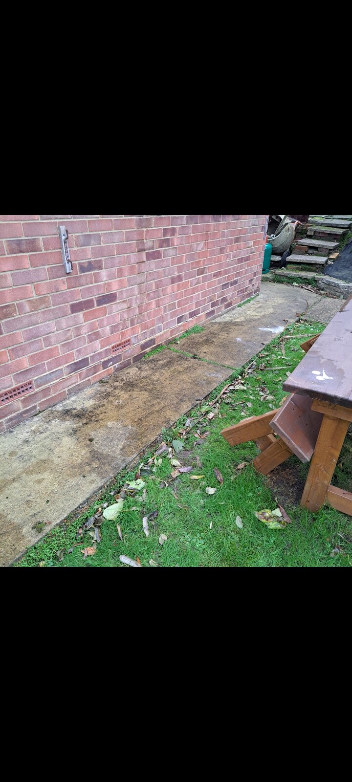

Externally there is a path, where the path meets the garage the path is about 40mm below DPC albeit it does have a good fall.
The path itself has separated from the external brickwork and has left a continuous gap of about 10mm. I'm wondering could water be seeping into this gap and collecting then breaching the brick work below DPC? The Bungalow is Timber suspended floors the cavities are clear as far as I can fathom with plenty of airbricks, the cavities aren't filled with insulation.

What's going on with the roof above the door? Is rainwater pouring onto the path from that or any other area? A gap in a concrete path below dpc should not cause damp within the building..are the cavities clear, vents etc.

Your bungalow appears to be down slope on a hillside - which suggests that you could be receiving gravity pressured ground water. Pressured ground water can move concrete paths FWIW but more important it can penetrate to the oversite below the suspended floor.
There's faint evidence of splash near the doorway area but nothing significant.
Agree with Al , what’s the mess to side of door ? Fence panel against the wall going to encourage damp ,seems to be a ground sheet on the roof.?
Yes that's the garage roof which needs completely replacing, it is possibly that water can be spilling off of it and splashing on the path.

And yes the Bungalow is on a downhill slop, quite a steep one.

What is odd is the garage floor which is concrete is below the DPC at the front of the house but seemingly higher than the dpc at the back where we have damp issues. The garage floor is level, the ground slopes away.
