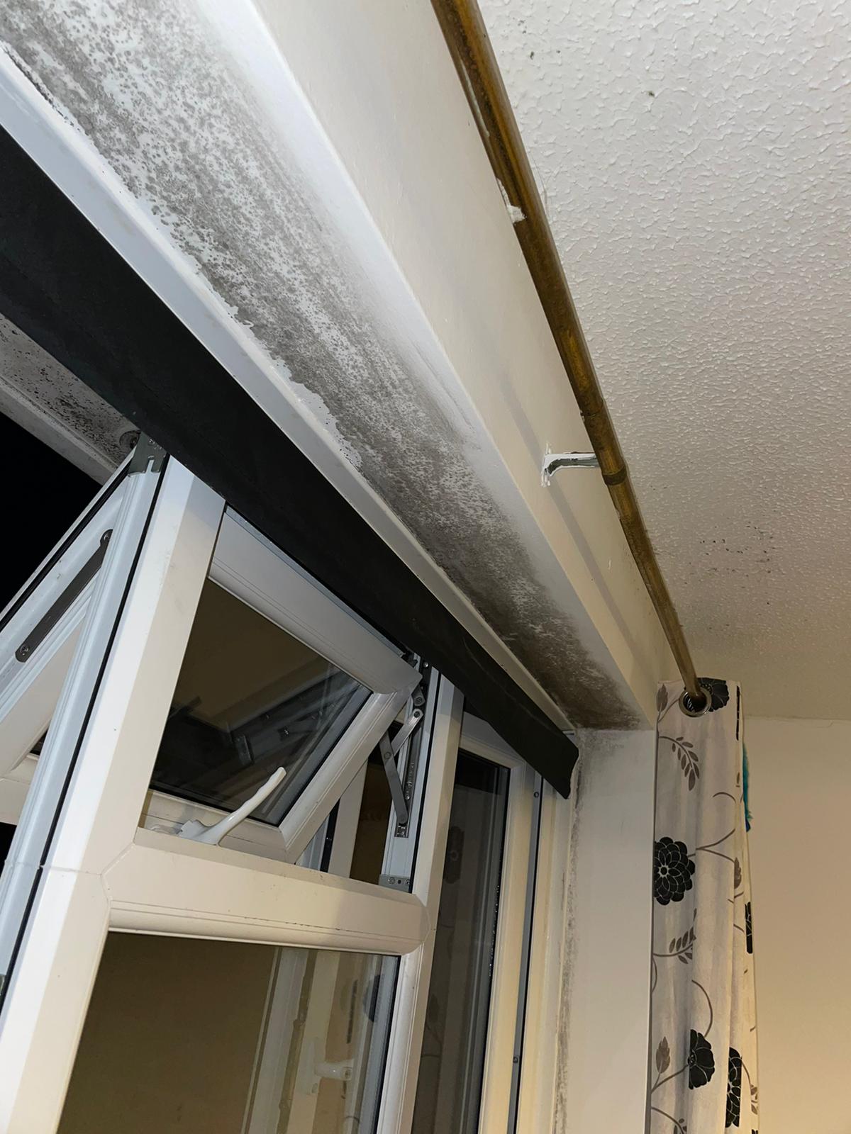

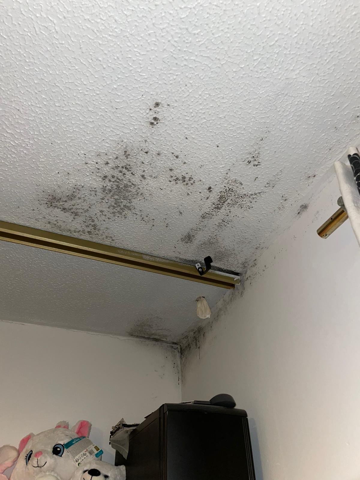

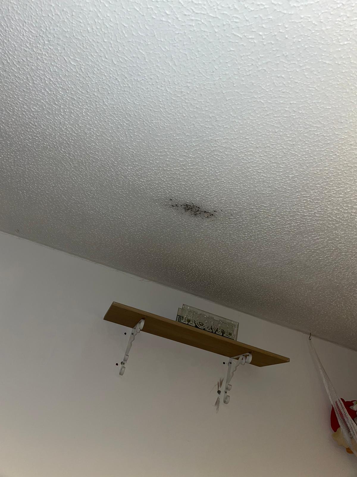

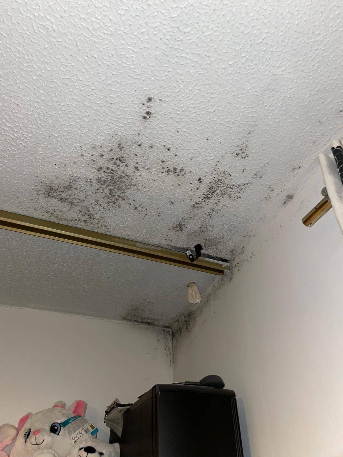

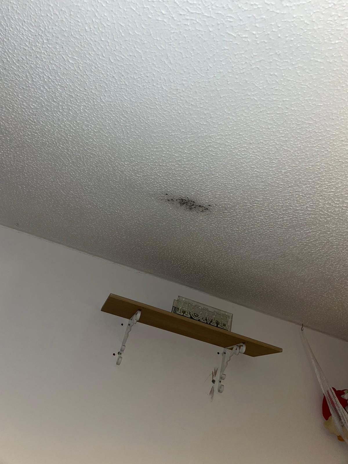

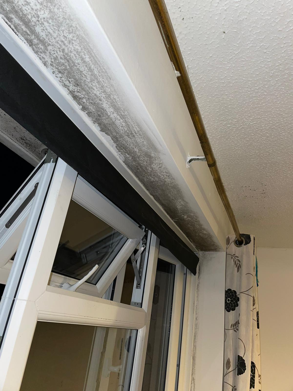

Hi have a property that has damp in the ceiling but also around the upper window cill. Can someone please let me know what they think might be the cause

Cold bridging and condensation?
Is there a loft above this ceiling, can you check if the insulation is properly in place?
They do try cloth in the hallway which connects the two bedroom and bathrooms. I will check the lift but is there away to remove the cold bridge? The bedroom with the damp on the window is directly above the kitchen also.
Do you think an extractor fan in the kitchen and also trickle vents help

I don't think there is much you can do about the cold bridging around the lintel, others may comment.
A trickle vent in that area may help, but conversely, could make the area colder and tennant's have a habit of blocking them up.
I have had specific patches of mould appear on my ceiling, when some of my insulation was displaced - it is definitely worth checking the insulation is in place and dry around those patches. You could also consider topping up the insulation - modern standards are a minimum of 270mm rockwool (or equivalent).
...as it sounds as if you are a landlord and you want to avoid these sort of issues for your Tennant's - you could look at a PIV (positive input ventilation unit) - something like this:
They are not as efficient as a heat recovery system, but many housing associations are now using similar.
