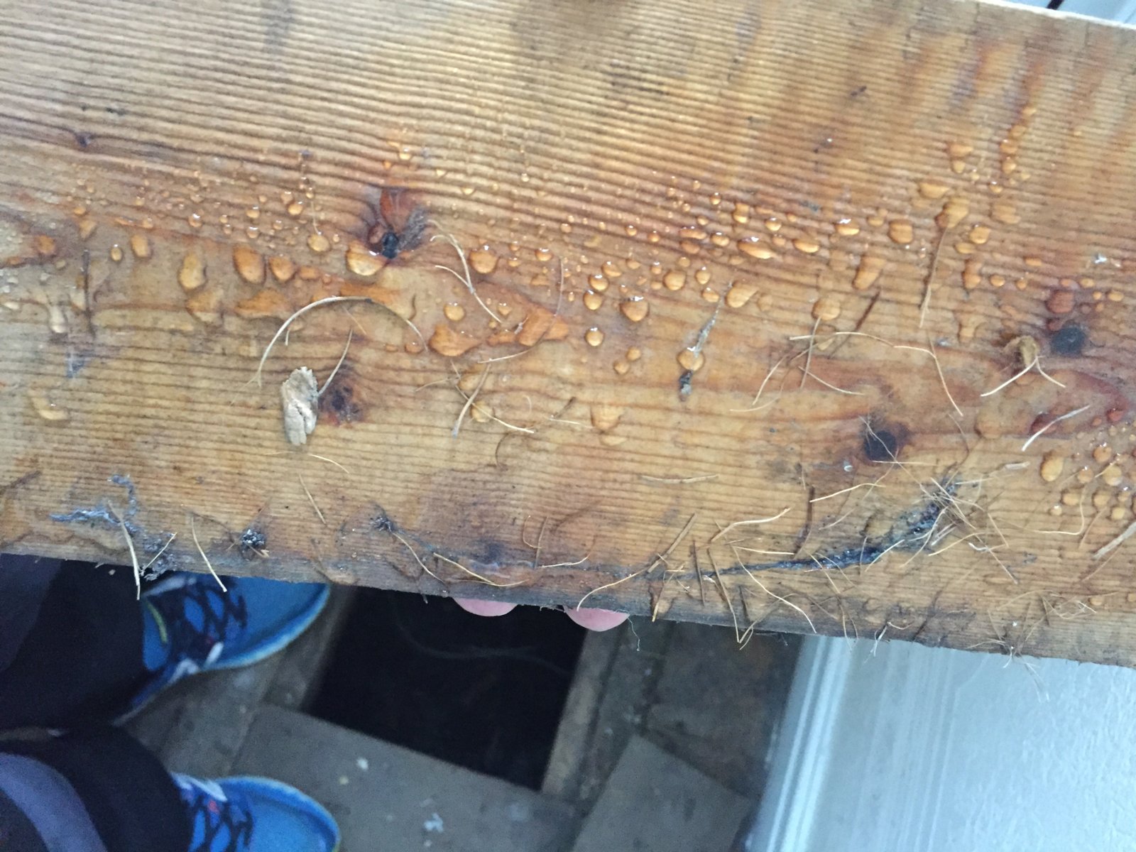

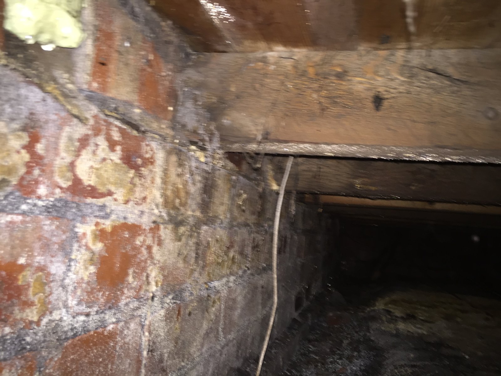

Hi I have a terraced house maybe 1930s , I can see the first couple of feet of joists from the front wall near the inspection hatch are soaking wet.
Doesn’t appear to be rotten , (I think it was also like this around 6 years ago when I bought the house)
It looks like maybe it’s had dpc injected from the drill holes.

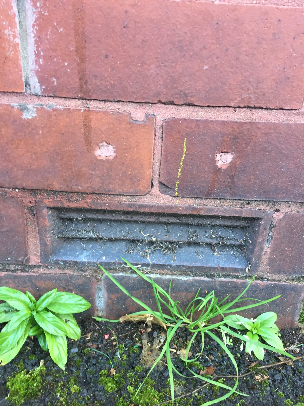

Could it be condensation ? The air bricks seem small and there’s a concrete slab extension to the rear.

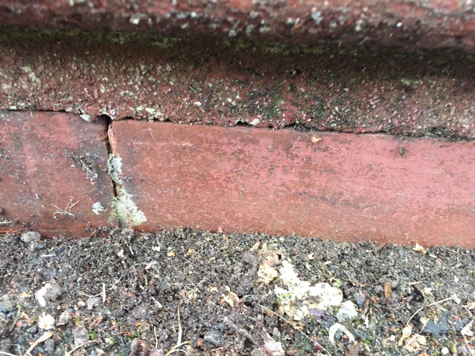

There are a couple of areas of pointing that look dodgy.
There’s a small area of expanding foam next to one of the joists under there too.
Also under the stairs near the back of the lounge can smell a bit damp.

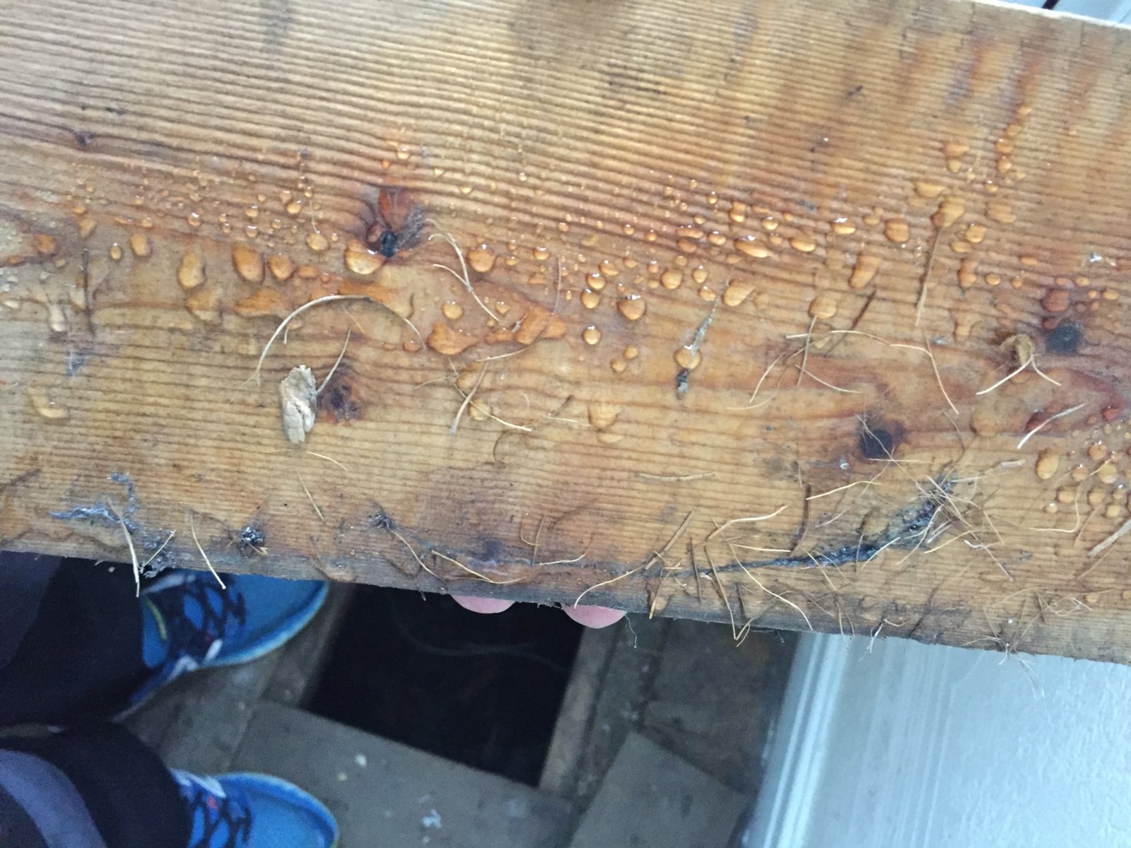

Thanks for replying, it feels wet, water droplets on the underside here’s a pic of a section of floorboard from the hatch

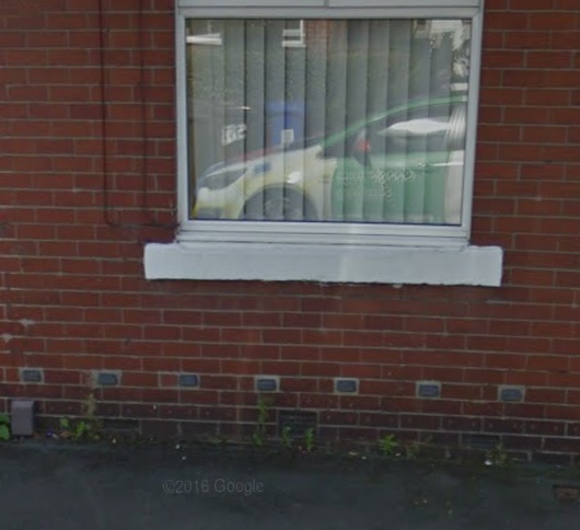

I have noticed a house further down has some different looking bricks a bit higher up, I wonder if they had a similar problem

As for the neighbours property, that row of air bricks is indicative of someone trying to get a load of air to circulate, i would bet that there is a rear extension on that property as well??

"that row of air bricks is indicative of someone trying to get a load of air to circulate"
no its not - the "air bricks" are the "Holland System" of inserts. they have nothing to do with underfloor venting.
they were sold by scammers as a cure for rising damp, and have disfigured lots of houses.
they never worked and they never will.
OP,
there are two courses of historic injection holes below the Holland nonsense in the neighbour's wall.
which would mean that the neighbours have had or still have rising damp issues.

try and find your DPC's, rake out a little mortar - perhaps there's a DPC below the air vent you show?
you need to replace all those metal vents with plastic double air bricks at about every 1.5m.
under the floor there's a massive amount of condensation showing on the soil surface, and under the T&G floorboards.
adequate through ventilation will relieve this - but you may have wet oversite soil? or even high groundwater?
the joist tails sitting in the brickwork are showing signs of rot -
you need to go under the floor, and probe all your joist tails including under the stairs, and round any fireplace hearth trimming joists.
look for softness and discolouration.
slide about on a plastic sheet.
the foam was possibly an attempt to firm the joist pocket up.

Thanks Bobasd , I think the airbricks are ceramic but don’t look like they have much flow.

Toolstation airbricks are £1.79 each .... get a free workout and change them yourself! I actually found it really hard work - even with my cheap Katsu SDS drill.

Are there any airbricks on the rear wall? either on the original property wall or in the extension?
Any idea if the front air bricks are all clear of debris and rubbish?
There are apparently peeiscopic vents that lead from the air brick and divert the air lower.
I don't think needed if not there now - if the floor level is a couple of courses of bricks up and the air bricks directly under, then that would give enough air flow. My guess is that you just need more - or some are totally blocked. In my 1930s bungalow almost every air brick was blocked up, most painted over, some covered in a concrete path, in some the damp course had collapsed and was blocking most air flow, and in all there was a pile of dirt on the inside too - result - lot's of damp, rot and mould.
