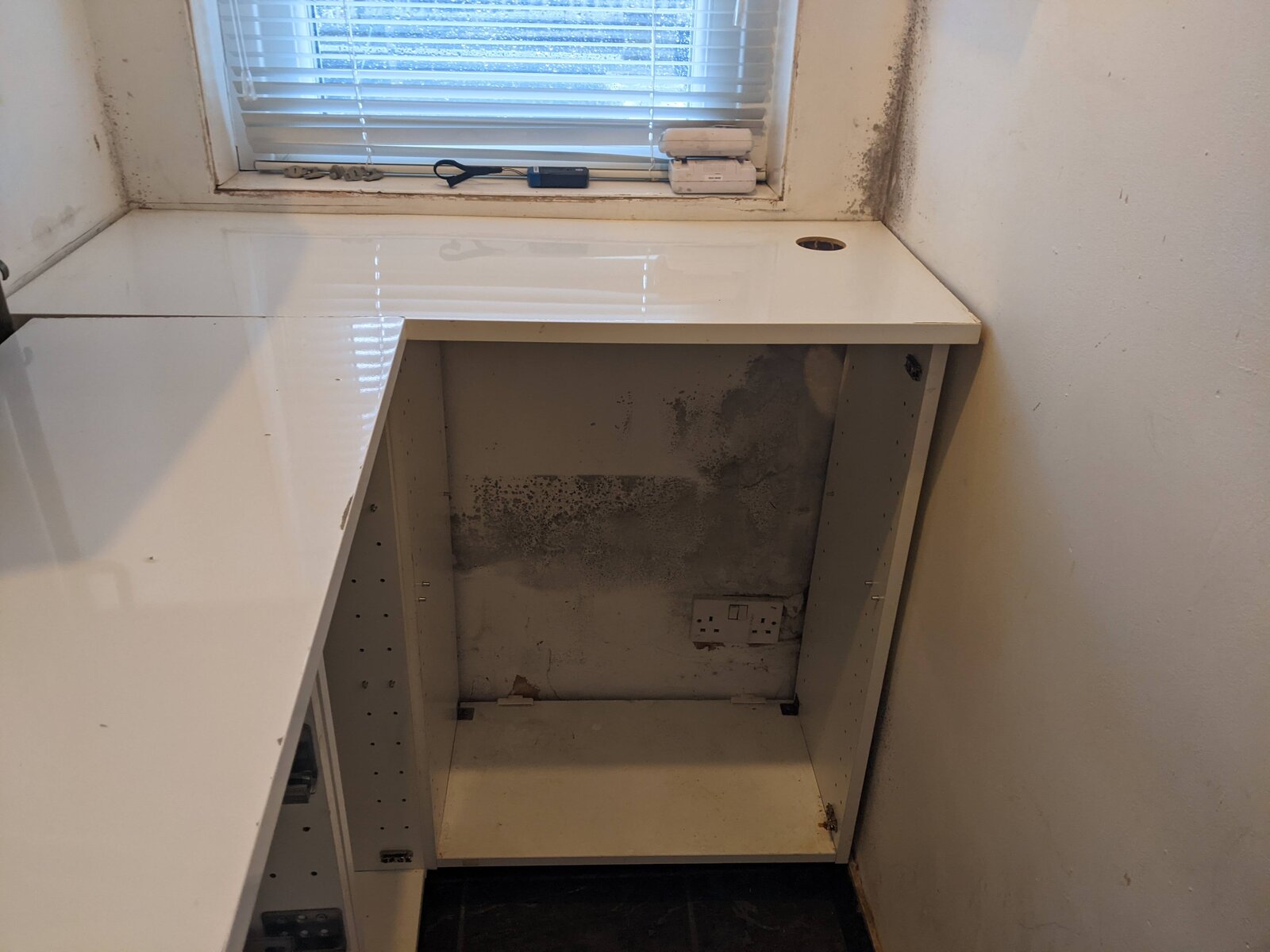

Damp/mould problem could it be related to proximity of boiler?

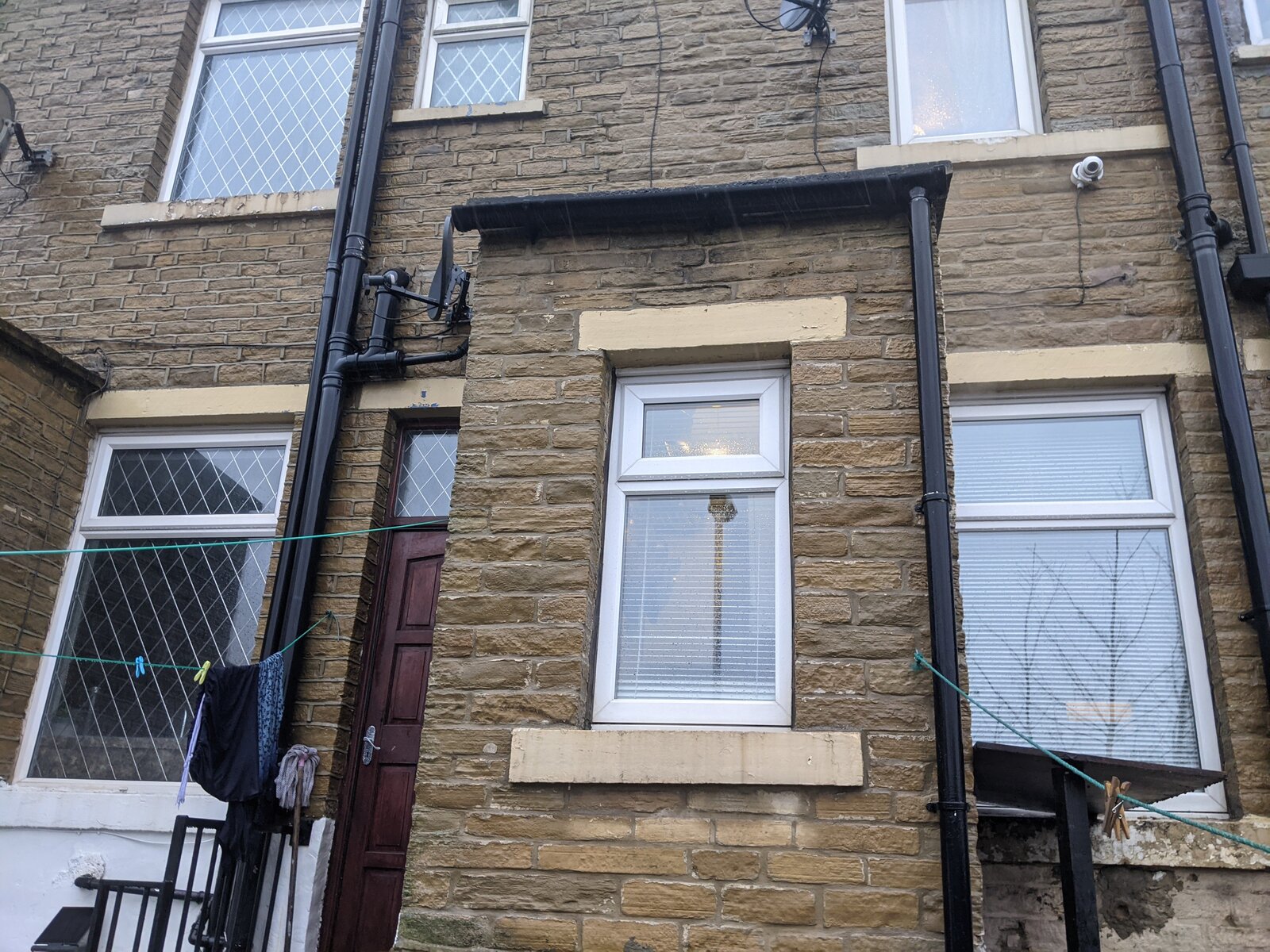

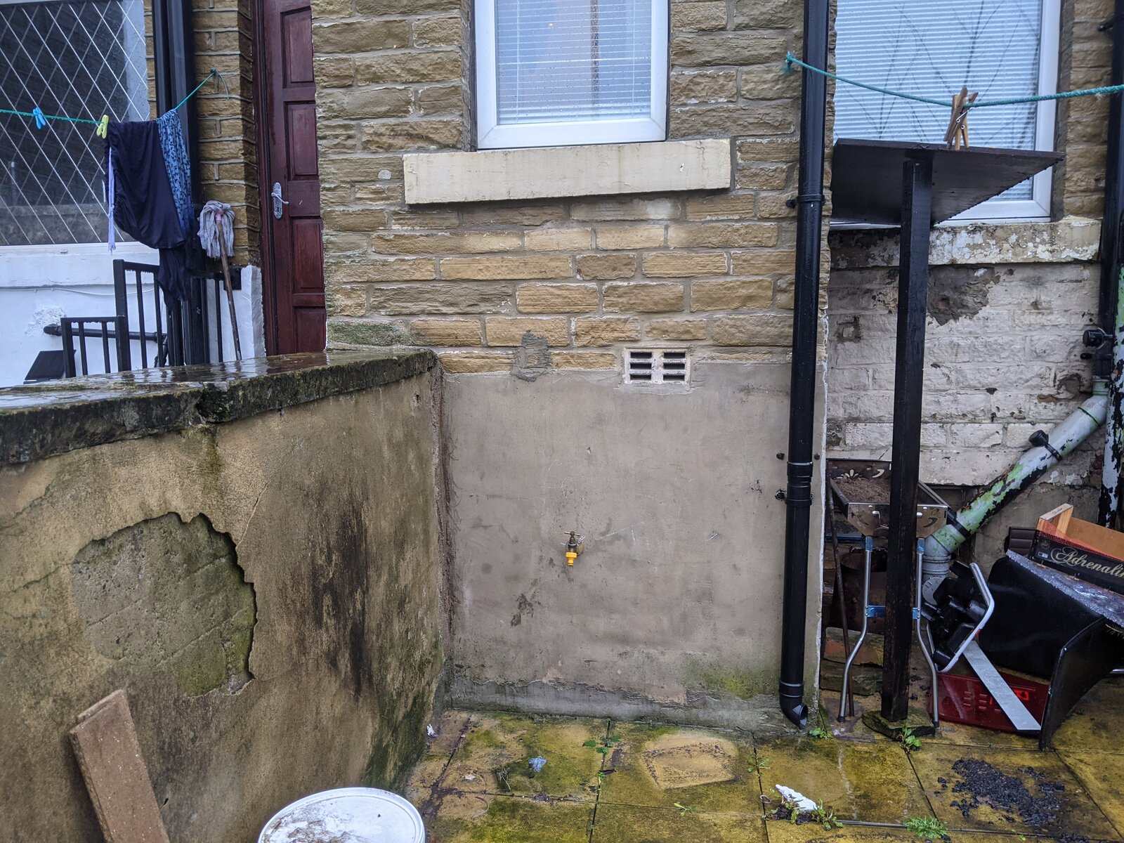

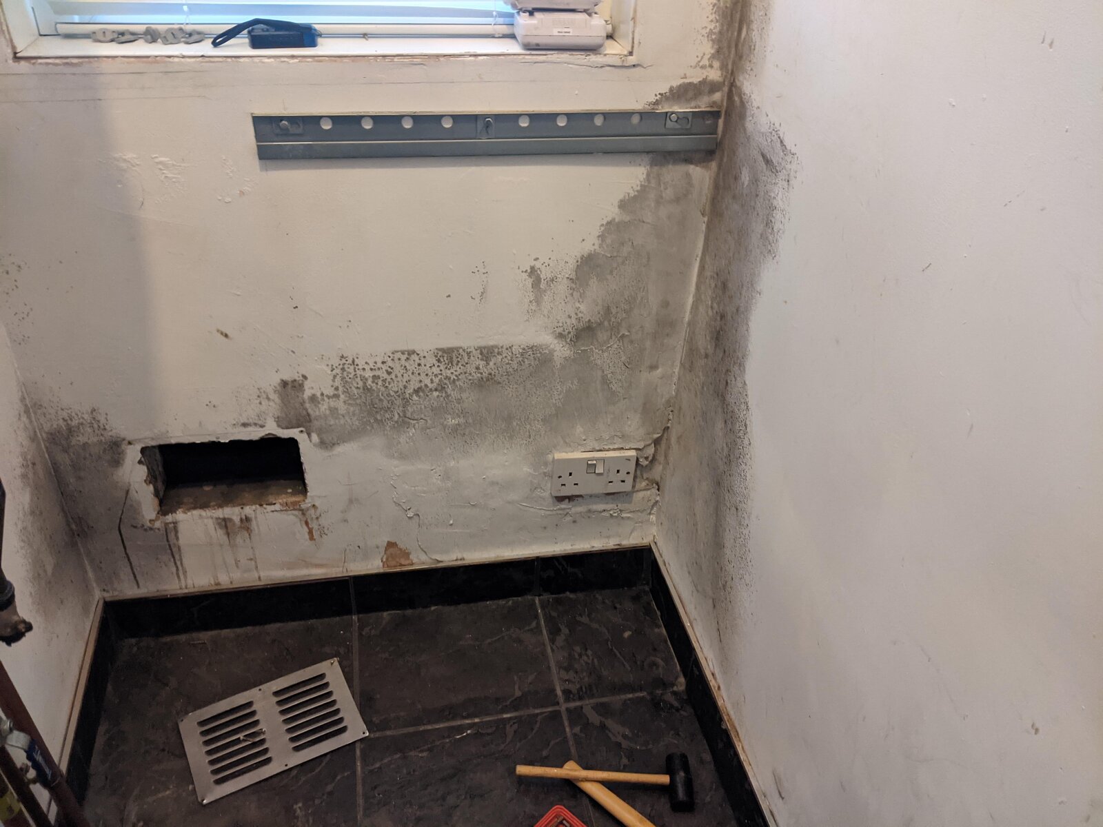

I want advice on how to tackle this damp/mould problem. We've had this problem for over a year now.. Ive painted over it in the past but the 'black' keeps coming back. By the way we cant really smell anything. The damp/mould is behind some kitchen units near the boiler but seems to be going higher. The house is quite old (about 100 years) and there is a cellar. Pictures below with some further explanation.. anyone know how I can fix it?

PIC 1 -
So I've removed the doors from the units here.. you can see the mould / damp

PIC 3 - Grill removed from vent

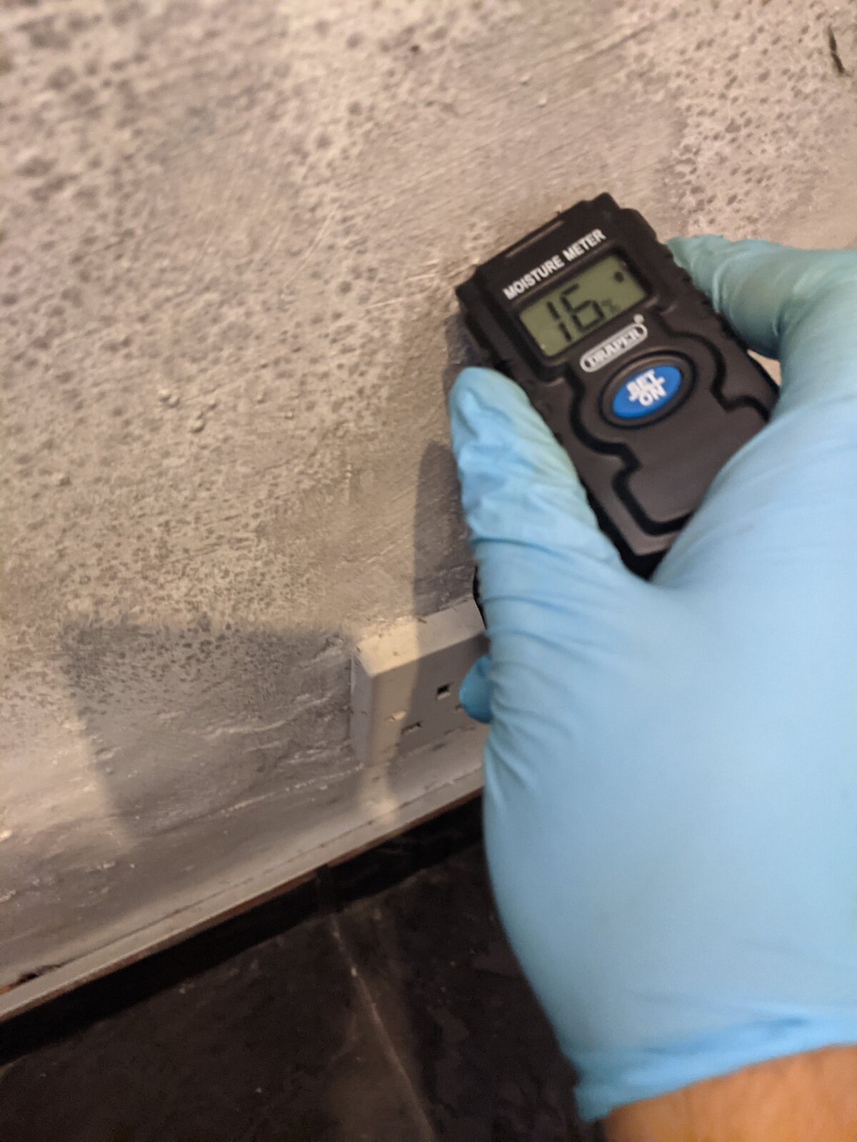

PIC 4 - moisture reading from the blackest part doesnt show any significant reading

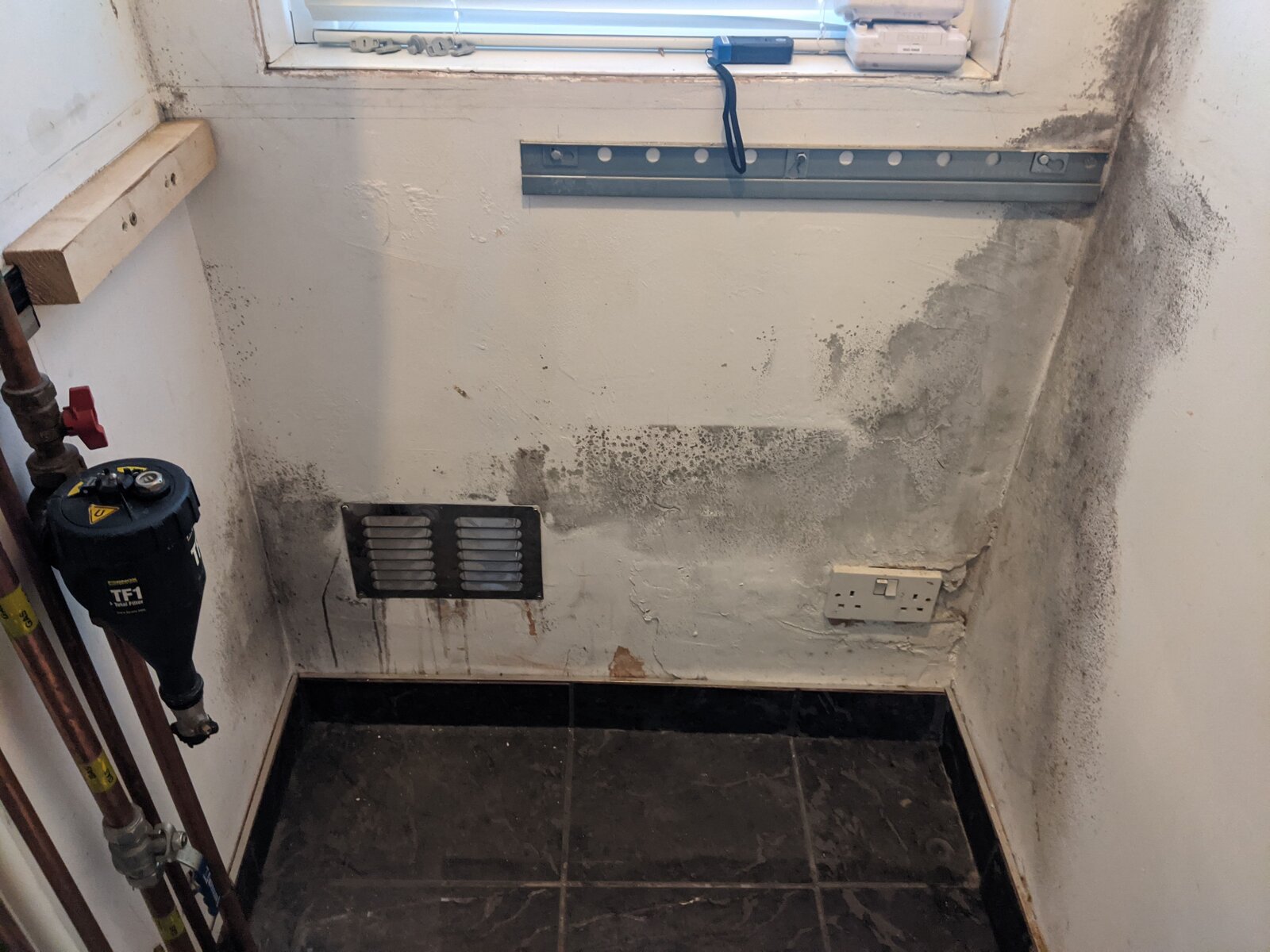

PIC 5 - Picture of cavity (taken from inside air vent)

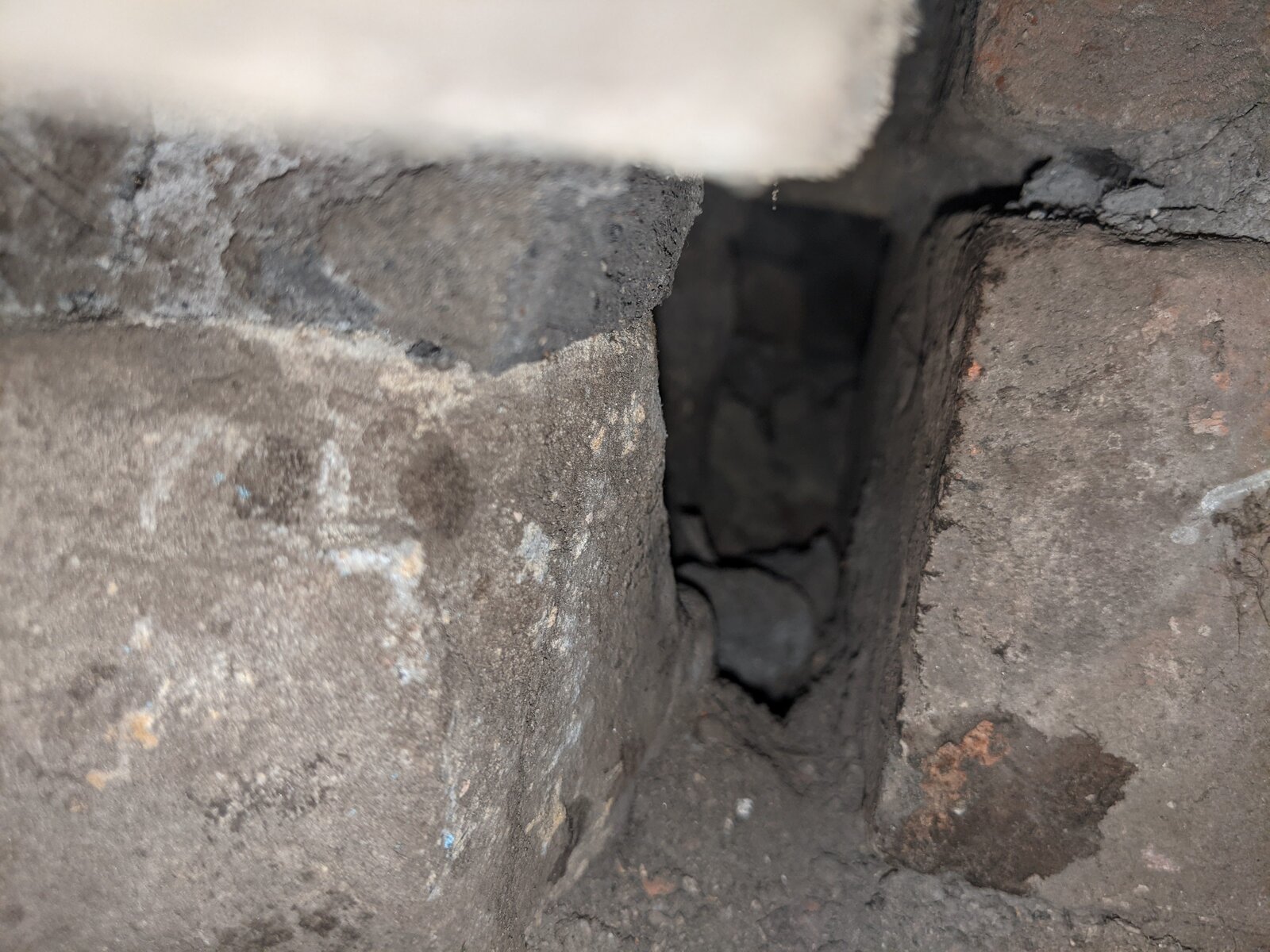

PIC 6- Cellar section directly underneath. In the past I have noticed some water in that hole area in. Not sure where that water comes from because it's raining cats and dogs outside today but it looks pretty dry to me
PIC 7 - Outside section
PIC 8 - Outside section top
PIC 9 - Outside section - roof
PIC 1

PIC 3
pxl_20210206_144042124-jpg.221834
PIC 4
pxl_20210206_150340550-jpg.221835
PIC 5
pxl_20210206_150856140-jpg.221836
PIC 6
pxl_20210206_145114427-jpg.221837
PIC 7
Outside section
pxl_20210206_144859838-jpg.221838
PIC 8
Outside section - top
PIC 9
pxl_20210206_144855533-jpg.221839
Mould is due to the result of a lack of ventilation and/or heat.
Where does the tumble drier live and is it condensing or a hose vented type that is just blowing into the kitchen?
It's a condensing dryer and lives in the same room about 3 metres away (an L shaped room)
