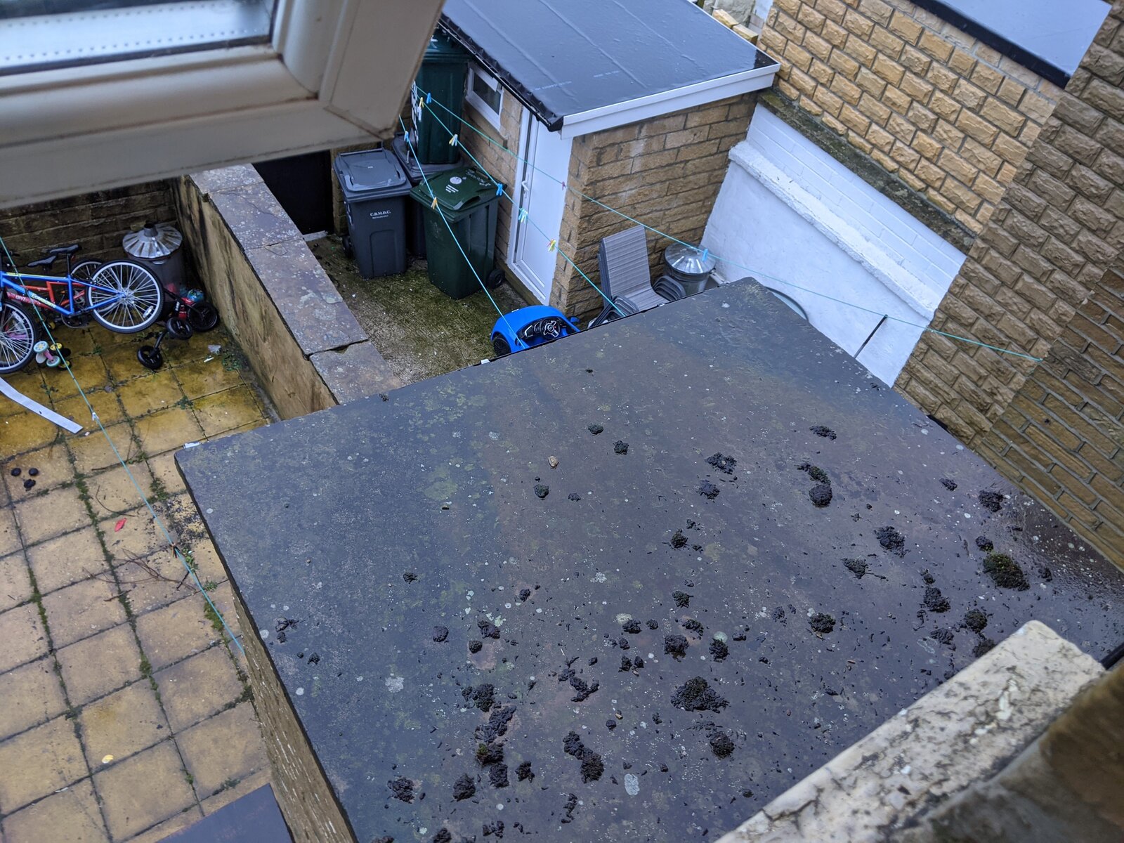

I want advice on how to tackle this damp/mould problem. We've had this problem for over a year now.. Ive painted over it in the past but the 'black' keeps coming back. By the way we cant really smell anything. The damp/mould is behind some kitchen units but seems to be going higher. The house is quite old (about 100 years) and there is a cellar. Pictures below with some further explanation.. anyone know how I can fix it?

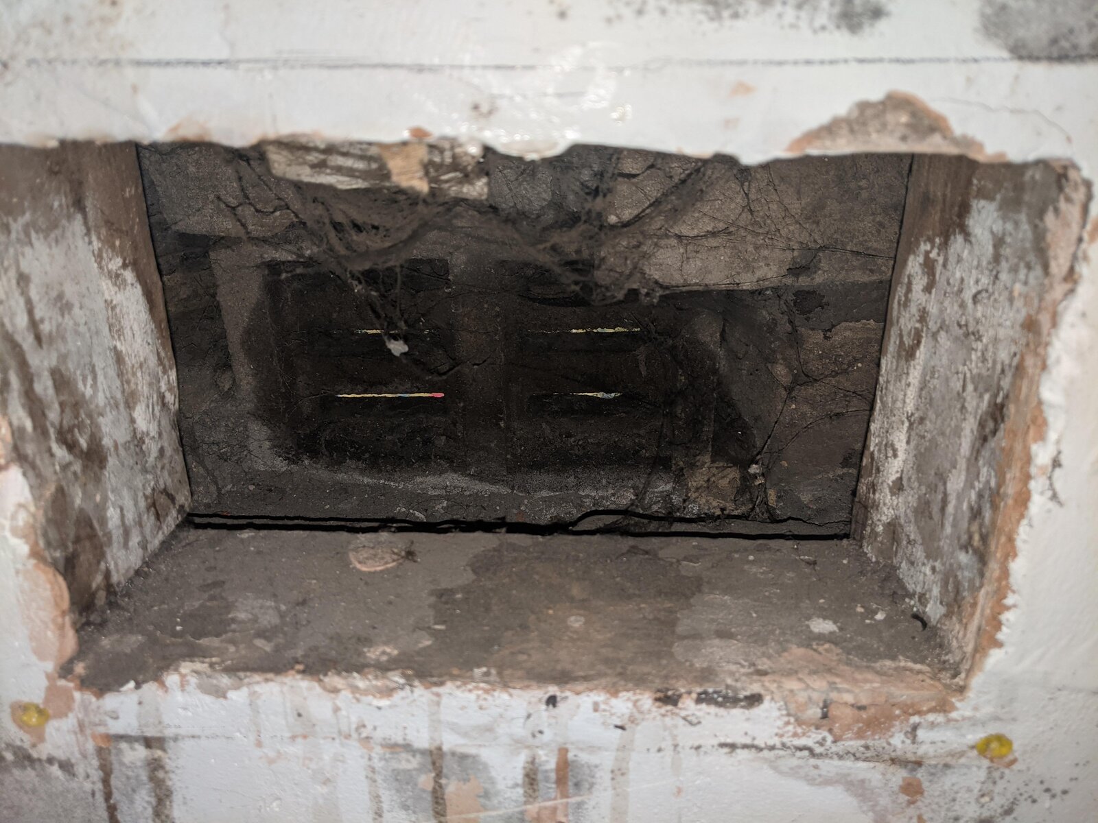

PIC 3 - Grill removed from vent

PIC 5 - Picture of cavity (taken from inside air vent)

PIC 7 - Outside section
PIC 8 - Outside section top
PIC 9 - Outside section - roof

PIC 3

PIC 5

PIC 7
Outside section
PIC 8
Outside section - top
PIC 9

Seems a strange room to have in a house! Has it got a stone roof?
it used to be a kitchen in the old days.. still is kind of - but the kitchen now extends out in the main room. Also have a tumble dryer in the room which gets a lot of use - which may be causing the problem.
Looks like cold condensation mould to me, so foiled backed insulation boards glued in place and boarded over.
And maybe make sure the tumble dryer is vented out properly.
I bought a condenser dryer a few years ago, so good - rather than pumping out moist air, it blows out warm dry air. Probably costs more to run, but no risk of condensation problems, and helps warm up cold utility rooms.
I'd also be looking at that rear wall and how any moisture could be getting in from there.
is the airbrick blocked?
condensation behind furniture is common when the external wall behind the furniture is not warmed, and damp air can get to it.
this can be prevented either by ventilating to the outside; or by warming the wall.
no the air brick isn't blocked - heres a picture of it (I did vacuum the spider webs afterwards!
it looks blocked
..apart from those slits.
I see your point - Ive never cleaned it in say 20 years or so! What's the best way to clear it? Should I just give it a good scrape with a chisel ?
airbricks are usually choked with cobwebs and dust. I'd probably hose it from the inside.
