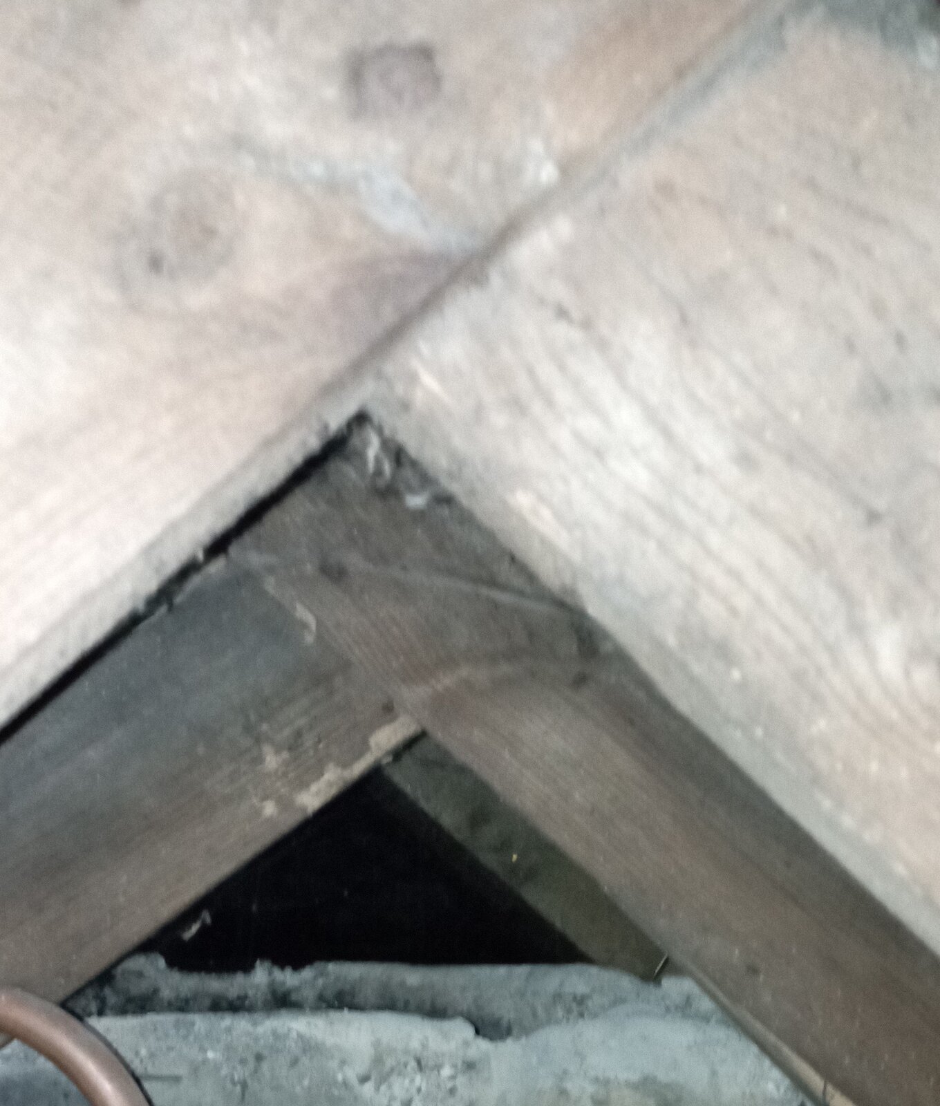

Yesterday we managed to reach the top of the chimney breast in the loft and it looks (haven't been able to get a camera completely over the chimney yet} as if the chimney is open. while the loft is apparently quite dry it is. of course, unheated and our weather in the south of Scotland this year hasn't been exactly dry. In addition, the report was written in January with snow on the roof and the house has now been empty ofr ten months. The bottom of the chimney lies above a framed and dry lined faux fireplace with an electric fire fitted into it.

I don't know what your first pic is. Stand back and take a wider one to show context and scale.

The first picture shows the top of the chimney which is below the roof ridge, I should have explained that more clearly.
The house is a single storey cottage so the chimney is around 5m top to bottom. I should also have pointed out that this is an internal chimney breast. Luckily, the ground is very dry and well drained as there is virtually no sub floor. There are no services anywhere below the building.

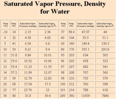

I think we are going to have to disagree on that one. This is janet and john physics- ambient air at 20 degrees 60% RH has a dewpoint of 12 degrees (see the table - sat VP @ 20 degrees = 17.54. 60% = 10.52 = saturated VP at 12 degrees) If the top of the chimney is colder than 12 degrees that ambient air rising will be condensing at the top. If the air at the bottom going in was 25 degrees and 70% RH you'd have had 6g of condensate per m3 of moved air when cooled to 12 degrees.
