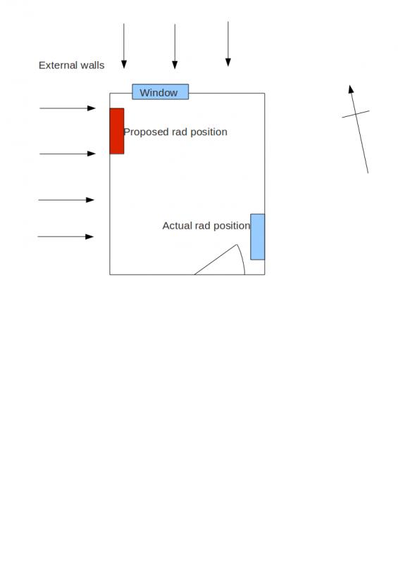

the little bedroom in my house was decorated a year ago and now the wallpaper in the corner of the two external walls is mouldy and damp.
This might not have been helped by longish curtains on the window and the position of a chest of drawers, giving little opportunity for air to circulate in this corner.
However i moved the drawers a few weeks ago hoping this would be enough to stop the problem and allow the area to dry out.
It hasn't dried out though.
I am wondering whether to move the central heating radiator from its current location to the mouldy corner. Is this a good idea? Would it stop the damp wall problem happening?
See the image for details:
You have either a damp penetration problem or condensation; if it’s happening behind furniture or curtains it may be damp penetration Moving the radiator won't cure it, you need to establish what’s causing it.
How old is the property? What type of external walls do you have, solid or cavity? Do you have modern double glazing? Do you at least have background heat in the room or have you shut the radiator down & close the door? Do you dry washing in the house? Do you ever ventilate the room? Do you have extractor fans in the bath/kitchen/utility rooms? Have you checked nearby guttering isn’t leaking or windows letting water in?

The chest of drawers were previously in the proposed new rad position. with the curtains from the window dropping to about 6 inches above the skirting board, which is what made me think it could be condensation. If this is the case, wouldn't putting the radiator on the exposed external corner eliminate the condensation?
A radiator has no effect on condensation and therefor mold.
As has already been stated, moving the radiator won’t cure condensation, it will merely shift it somewhere else. You need to reduce the ambient humidity of the air inside the room/house which is being caused either by lack of ventilation or damp ingress.
