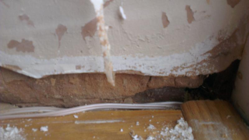

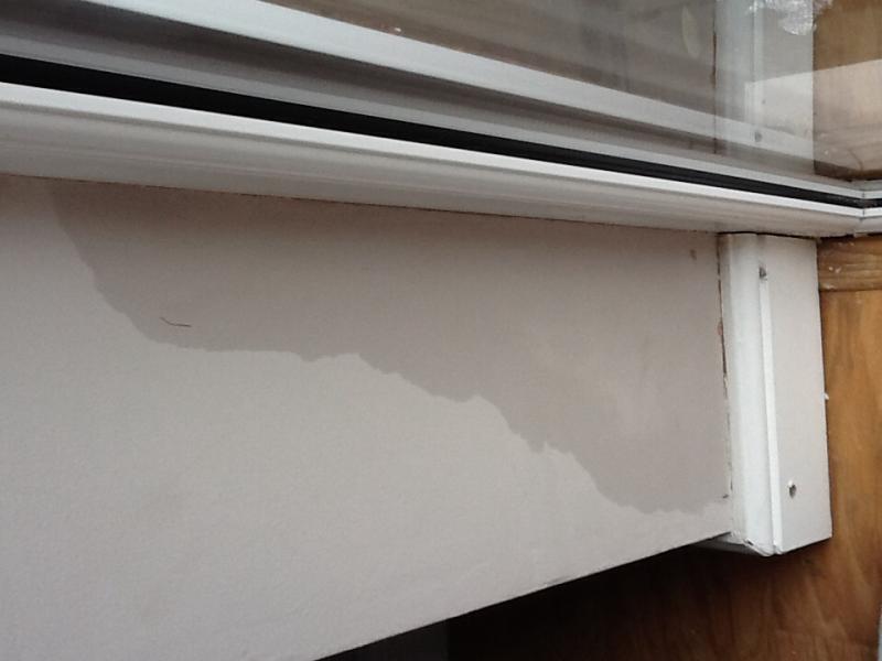

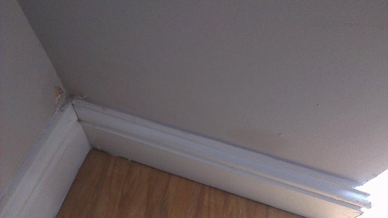

I have tide marks on internal wall right next to the French door.
External Dpc was done 7 years ago
Brick work is excellent condition as house was repointed by myself 7 years ago.
Seal around French doors was a little detoriated so I have replaced with new sealant.
Next door neighbour had a hopper which was blocked ( don't know how long for) this was overflowing so I am thinking this has saturated the floor and the bricks?
I also took the skirting off to check the internal wall and as you can see the plaster is dry so I am thinking I don't have rising damp.

It could be an incorrectly positioned frame and the recent driving rain that caused it.
If a frame is not fitted far enough back (towards the inside) and subsequently some of the external masonry is visible from the inside i.e. beyond the vertical dpc, then all the sealant in the world will not stop the water wicking through.
If there is less than say 20mm of brick visible in front of the frame then it may become a problem in driven rain.

I think the next question is how wide is the frame because you have around 80mm of the outer leaf brick behind it. If your frame is less than that Noseall is very probably correct.
Not sure what you mean but the frame is 40mm wide until the bead that keeps the glass in and 70mm deep

23mm plus the frame thickness of 70mm would amount to 93mm overall. Not ideal but not convincing either. It would amount to about 12mm of masonry showing the wrong side of the frame.
I would dig out a small hole in the plaster where it gets wet to see exactly what is there. If the vertical DPC is getting bridged by the plaster then the answer would be to refit the frame inwards until the DPC is actually behind it and that may be nearer a move of 20mm
Look at the Jamb details on the link below - Your own frame could be fitted too far forward so the DPC is not properly behind the frame.
