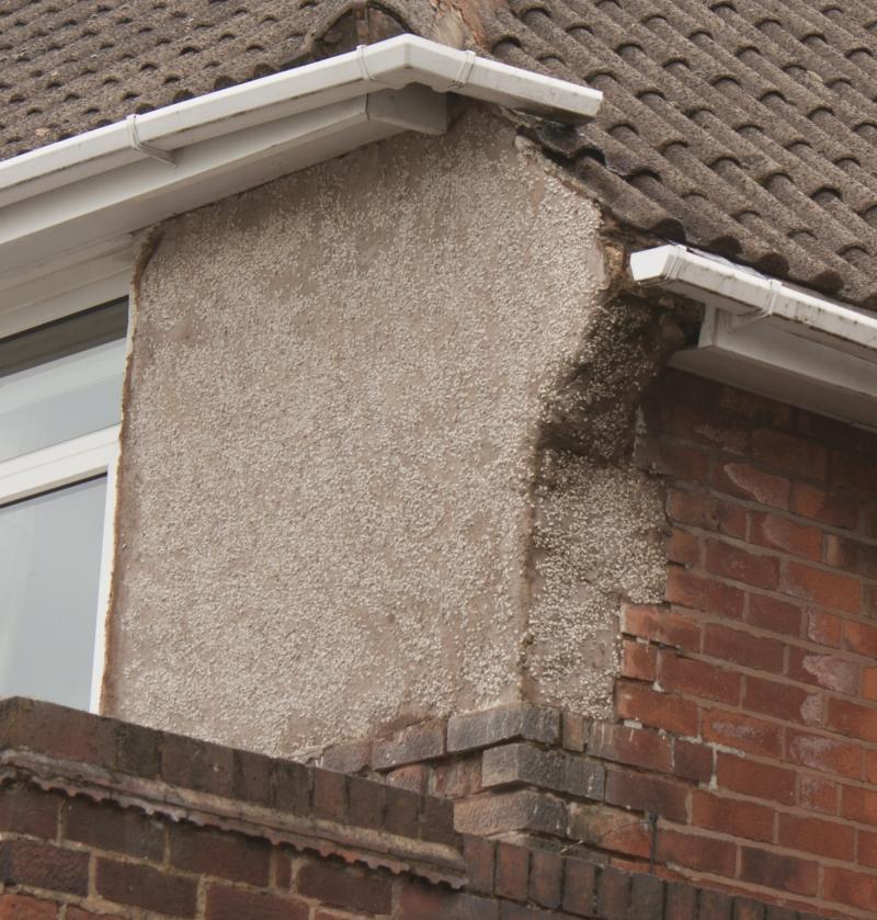

hey guys i was helped out on here a little while ago with rendering and plastering a wall. the render was falling off one of my walls so i re-rendered it with a lot of help from this site, i also had to strip ....very easily it mostly fell off actually...the interior plaster down to the brickwork. the problem is i never got round to painting the outside wall, and recently i have noticed a damp patch and some fungus on the wall. is this because i didnt paint the outside wall, please tell me i havent got to do the whole thing again its all painted and papered inside now, i think i have really cocked up, but i hope i havent help please.

roy, thanks for the answer, i used bonding on the inside wall as a base coat, the inside was left for a few weeks before papering,i did not put any waterproofer in either of the coats, i took advice from here and as far as im aware nobody mentioned doing that, should i have done that?,what do you mean by rendering over a crack, i had to remove some of the mortar between the bricks as it was a bit naff also at the top near to where it meets the roof i had to fill a couple of biggish holes with cement i think there may have been bits of brick in there before cut to the shape of the roof under the roof tiles, was i wrong to just put mortar in those gaps?there arent any plants or trees anywhere near it
i have posted a couple of images so that you can see a before and after where the arrow is pointing are the gaps i mentioned where i had to put a fair bit of mortar hope you can help after this explanantion and pics appreciate you trying

1. joe is on to something: the detailing at the short piece of verge is wrong
2. There's no supporting and projecting cement fillet, and the tile dont project out far enough off the wall face, esp. with the new remedial work.
3. Notice the return end of the gutter is too long, is bent out of line, and is not actually catching any runoff. And the gutter falls the wrong way. A lead saddle/soaker is required here, to pick up run-off and direct it into the gutter.
4. Why only render down so far and then stop? Is there a ledge of some sort?
5. Have you had PVC fascia, and soffit replacement?
6. The left hand side of your re-rendering, at the PVC frame seems unfinished?
7. What is behind that parapet? Is it a garage roof or a balcony ?
8. Whats the answer to roy's question ref. "fungus"?
1. can you explain this a bit more please what is a verge?
2. are you saying that the tiles on the roof should come out further into the gutter?
3. can you explain this a little more please are you referring to the piece of gutter that comes across above the window and then turns across the roof?
4. thats where the original render stopped before there is a ledge of bricks that stick out at that point.
5. pvc and soffits were replaced along with gutter about 5 years ago.
6. it is finished maybe the edge is a bit untidy and havent cleaned up the pvc window frame.
7. its a garage roof.
8. the fungus is in the bedroom, and its only a small ammount

Well i can, to the best of my ability, answer your queries, but in the final analysis you will have to get a jobbing roofer or builder to rearrange some tiles and guttering, and fit some lead flashing at the bottom of the hip area, ie the corner of the roof.
1. the verge is the roof edge bit that slopes diagonal from high to low. Above your arrow in the pic.
2. No. the tiles over the verge have been cut short. New tile, extending over a cement fillet and pointed in will do the trick. Perhaps another bit of lead flashing detail.
3. Yes, that piece requires cutting short and the whole last three feet of the guttering requires to be raised. So that the water will flow to the outlet and not sit and possibly flood over.
Lead flashing should be installed above and discharge into the gutter.
4. A little slope( or fillet ) of sand and cement will prevent water sitting on the ledge. Perhaps you did that?
5. Hence the gutter difficulties.
7. So you can stand and work off it? While you are up a steps check the security of the fascia at that corner.
8. Pic it please. And the surrounding area.
