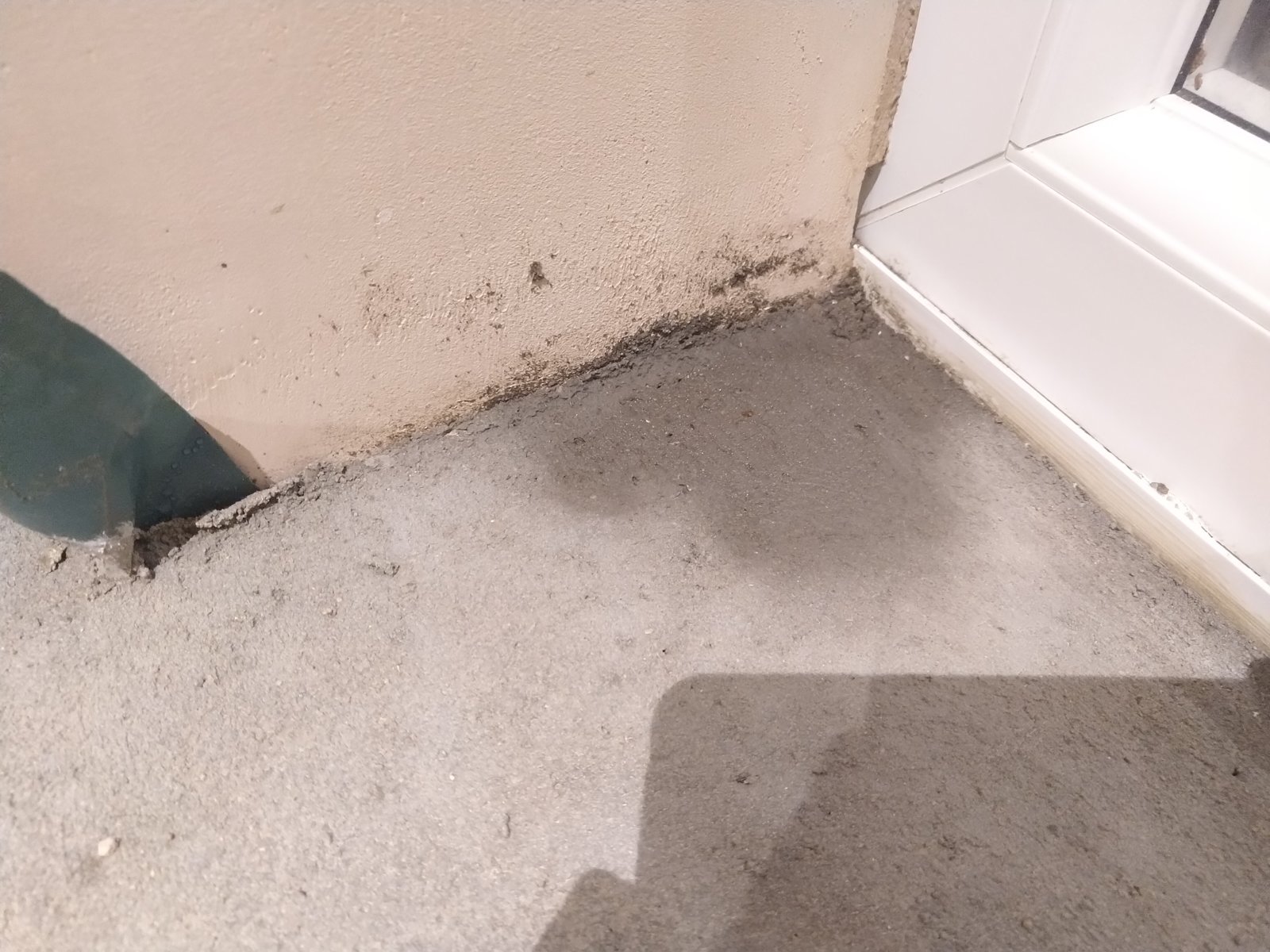

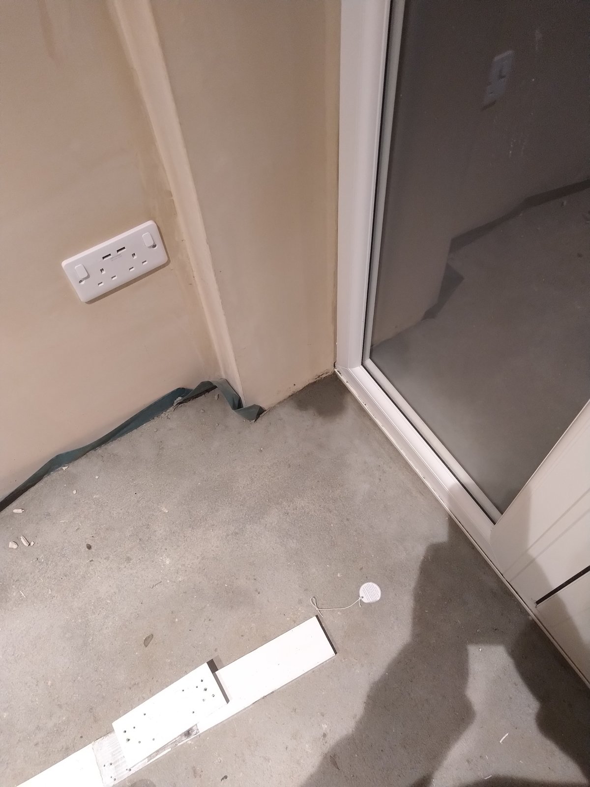

Hi,
My brand new front porch was completed 2 weeks ago. Since then, I've noticed a small, recurring patch of damp on the floor screed. It is located in the front corner, where the side window (which extends from the floor to top-of-door height) meets a short return wall. The walls are thermolite block + insulation (100mm I think) + brick. I have already paid the builder. I have contacted him about this, but am yet to speak directly with him. In the meantime, can anyone please advise me on this? Would I be right in assuming that this is not something to be expected, and that it would be appropriate for the builder to come back and rectify it? At first I thought it might be a leak coming in from the side window frame - now I'm not so sure as it doesn't seem to necessarily coincide with rain. So it may be condensation.
