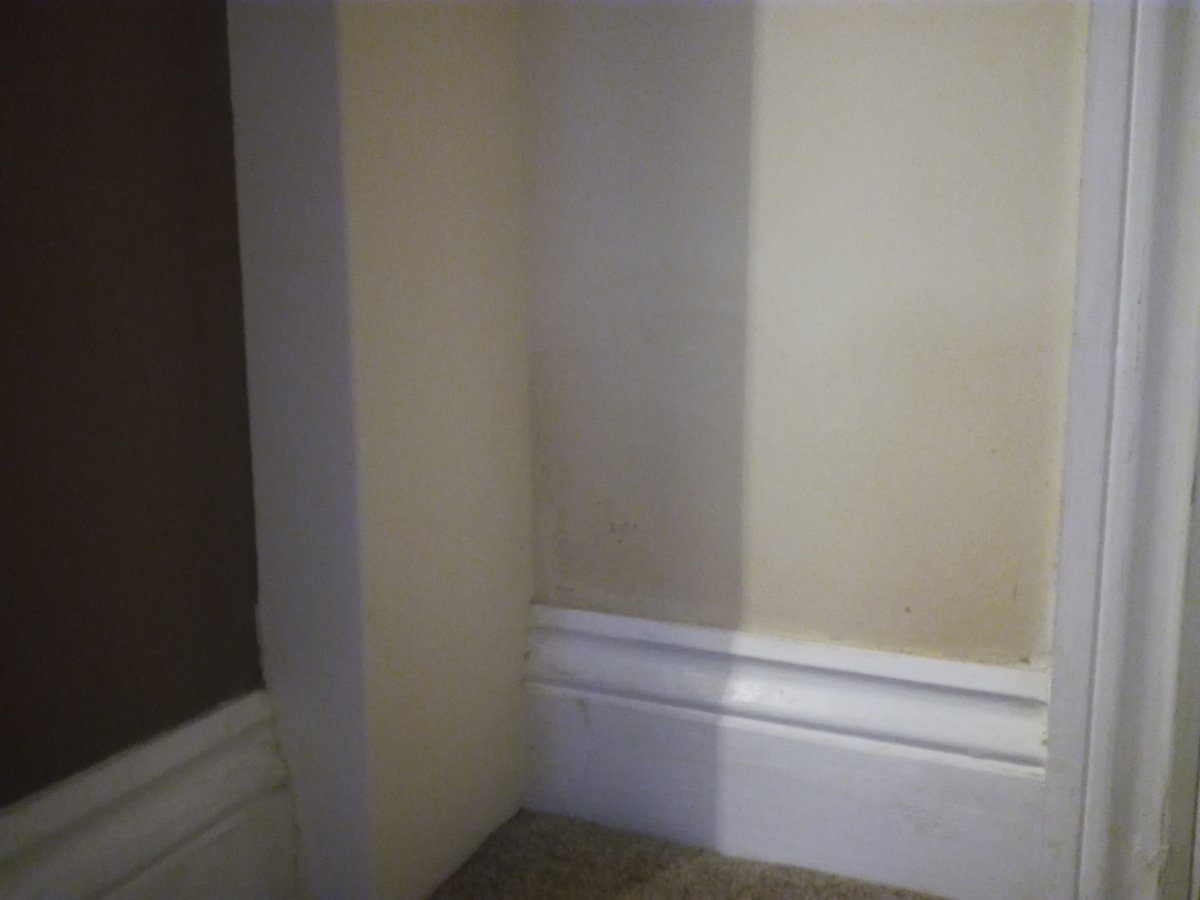

My house is a 1930s semi-detached which I have owned for about 4 years. The internal decoration was in poor condition and the (original) plaster was crumbling off the walls, so I chiselled it all off and had the whole house dotted and dabbed.
One small patch of the lounge wall developed a damp patch. I ignored it initially thinking it might dry out but 2-3 years later it is no better. It seems to worsen through the summer which I'm assuming is probably just down to having the heating on through winter and so assume the problem is constant.
I've attached a picture to show the issue - the wall in question is an internal single skin brick wall approximately 6 feet from the nearest external wall - the other side of the wall does not appear damp, and the brown wall to the left (the side of the chimney breast) also does not appear damp.
The damp definitely appears to be rising, rather than down the wall as a leak, for example, would. However logic dictates if it was rising up the brickwork I'd see damp on the other side? I'm at a complete loss as to where to start, and don't really want to call in a "damp expert" without any knowledge what to expect.
Any thoughts?

hi ,your pic isn't the best ,at least on my kit, but appears to be damp patch on right ,at skirting level, next to architrave. is your floor wooden with crawl space below ,or concrete ? on left side of pic ,are there central heating pipes that are "boxed in " ?? do you have condensation problems anywhere in they property.??,.,..............................
edit..by the way how wide and how high is the affected area ,can't tell from pic ?

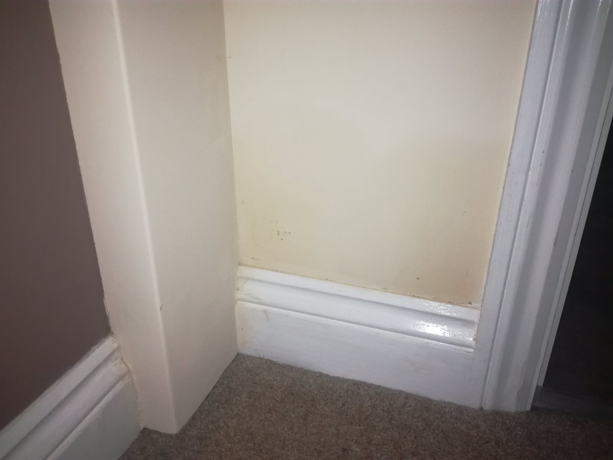

Thanks for replying. I'm struggling to get a decent pic of the area if I'm honest - I've tried again and have attached a marginally better picture.

1) Yes, the damp appears to come up in two places, one further left closer to where the boxed in section is, but the bit next to the architrave is by far the worst spot of the two. The width of the affected area is about 1ft and the damp rises to about 6" above the top of the skirting.
2) Yes, there are central heating pipes boxed in along with a bunch of cables.
3) The floor in the affected room is wooden with space below. On the other side of the affected wall is a concrete floor.
4) No condensation, damp, or mould anywhere in the property.

i think you may have a combination of two problems, condensation and rising damp. when " dot & dabbing" onto bricks that have absorbed moisture ,the adhesive between brick and plasterboard draws moisture from brick into plasterboard. if you rap your knuckles against the wall you will find it solid where damp patches are and more hollow sound where drier .try it and let me know. i can then offer a solution.
Yes, it does sound as though there are two dabs of adhesive roughly where the damp is at it's worst, and it does sound hollow in the middle where it's slightly less damp, which rings true with what you're saying. What's interesting is the other side of the wall also appears to have at least one dab of adhesive at skirting level directly opposite this patch, yet that side of the wall is not displaying any signs of damp?

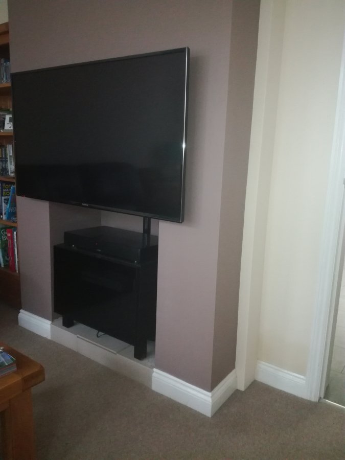

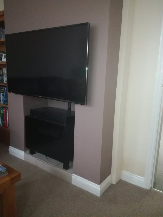

I've also attached a photo from further back showing the full width of the chimney breast.

Thanks for the photo.
The carpet can be lifted quite easily off the grippers, and there's no call from me for you to go "ripping up" anything. Perhaps leave the carpet alone.
What you can look for with very close observation, and by sniffing for a musty smell close to the skirting on either side, are signs of damp in the floors or skirtings.
The general impression from the pic is pretty much everything is in order, so to speak.
