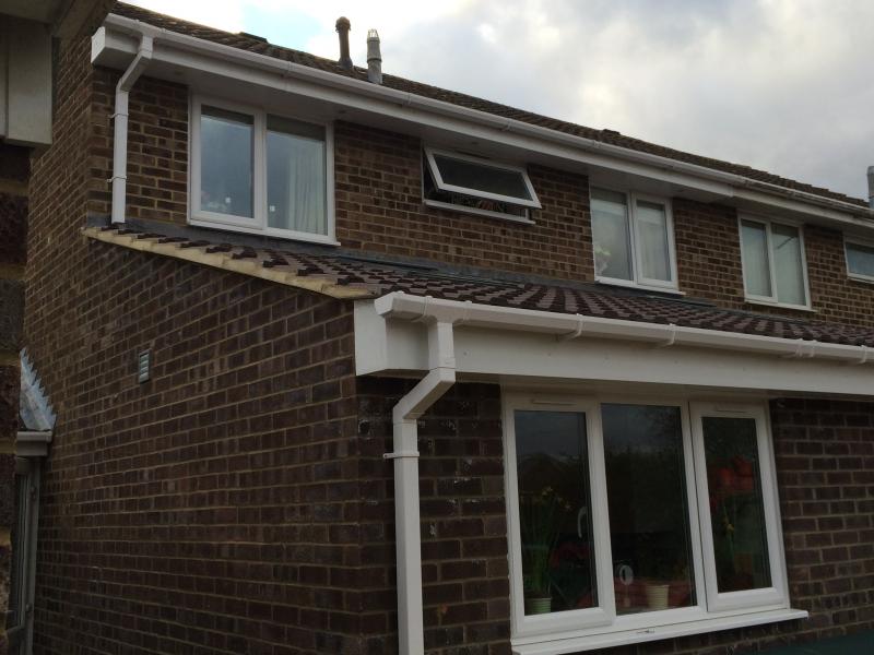

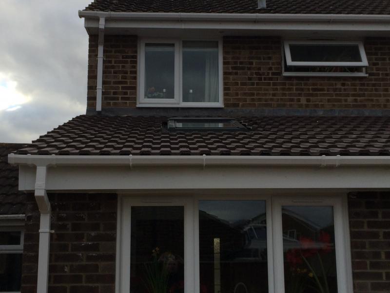

What is the pitch and what type of tiles are they? Got a photo or two, not just the damp bit but the roof too
By the way, although the roof has Velux windows, it is not thought that the water is getting in around them. The damp patch that appears on the ceiling is quite a way away and there is no sign of damp near the windows themselves.

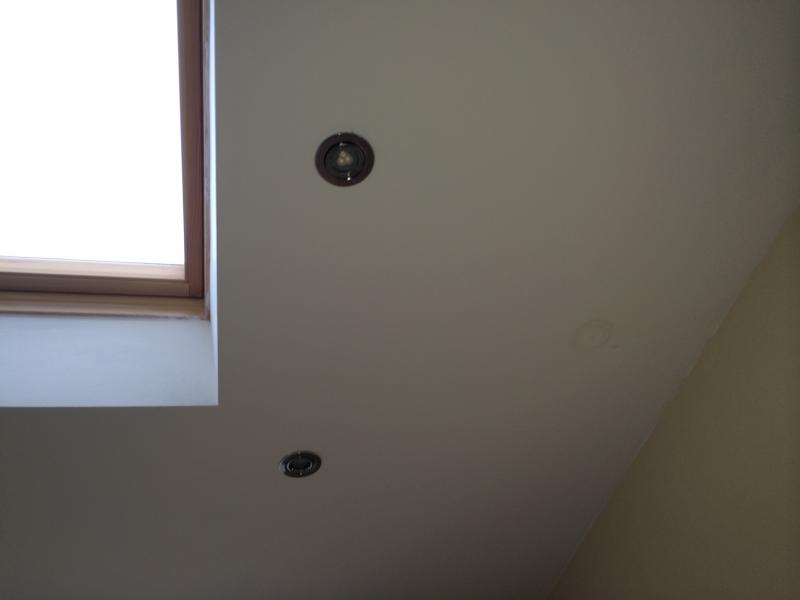

Here are a couple of pics of the damp patch. The second one isn't very clear, but wanted to get a picture of the damp patch in relation to the window. You can probably see a small damp spot in the centre of the brown stain. This was bigger this morning but has dried out a bit since. We haven't had any rain today and there's hardly any wind either.

I would take a guess that pitch is more like 18 degree's. I think if you stop the rain water running off the main roof and down your extension roof then it might dry up.

Thanks for your comment catlad, I may suggest that the builder adds some drain pipework to take the rainwater away from the extension roof.

Agree with noseall, the condensation drip is right next to the downlighters.
Those tiles are 22.5 degree minimum so if you roof is lower than that then it would be unwise to flood the roof with the water from the main roof, condensation is a possibility but it will be easier to move the down pipe first and take it from there.

I had considered condensation but I don't understand why it only ever appears in that one small area. Also, it may not be that clear in the photo's but the damp patch is around 2 feet away from the down lighters. Also, it doesn't make sense why there's no problems on kitchen side of the wall, even though there's lots of moist air generated from cooking etc.
Another thing on the subject of the downpipe. Is there supposed to be another section of piping attached to the bottom of the pipe, where it meets the roof? It just looks a bit odd and my gut feeling is that something is missing as it doesn't look right.
