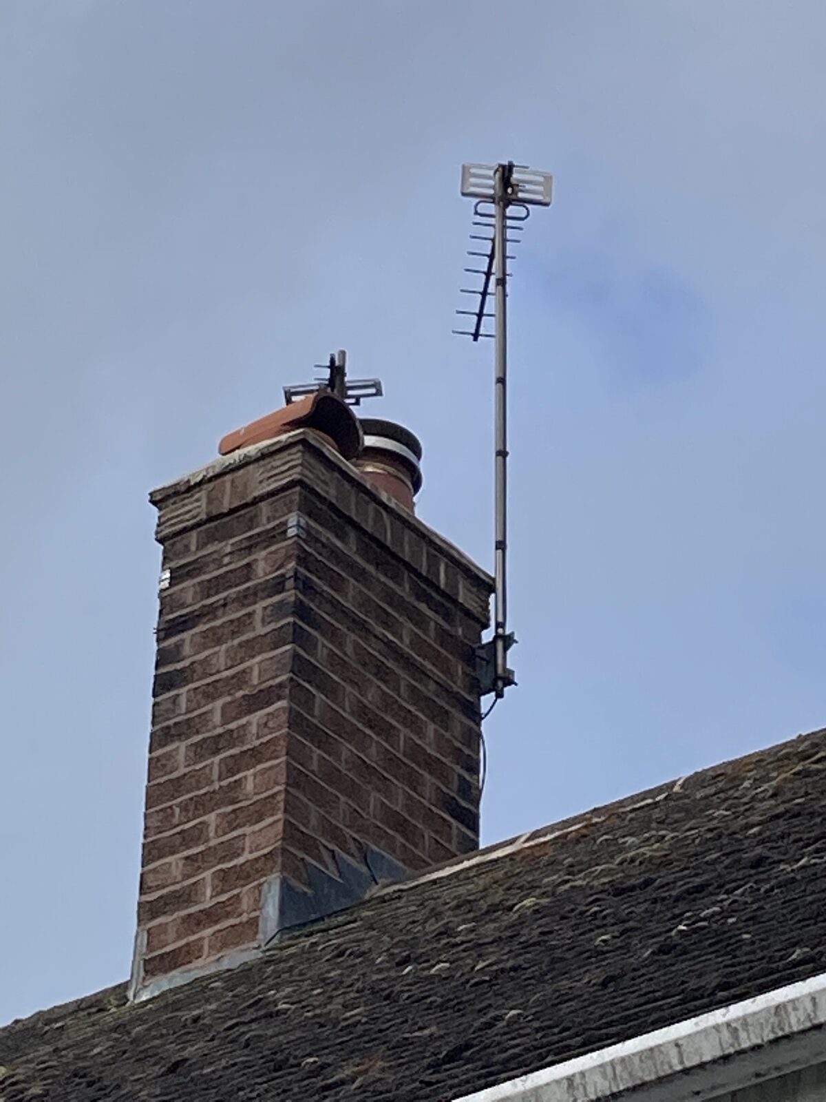

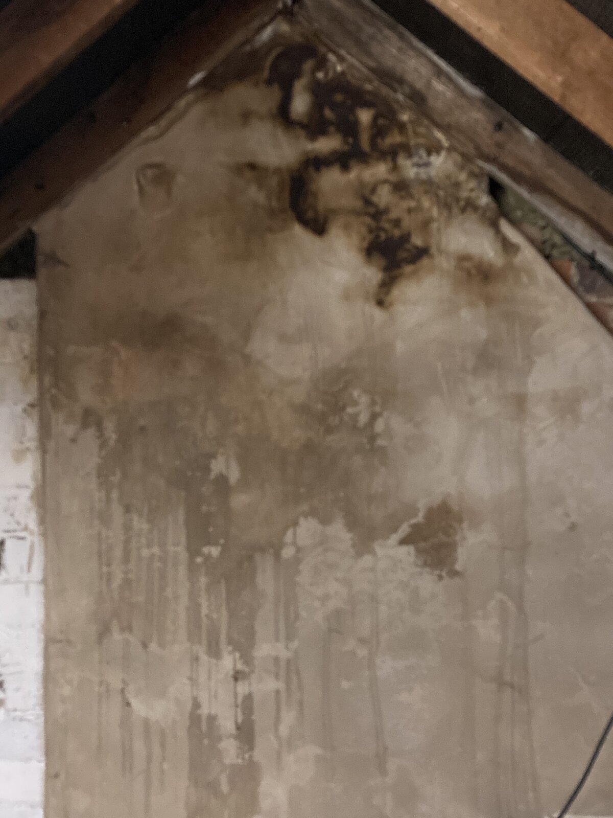

Hi
For a number of years there has been a damp patch on the chimney breast in my attic. It only appears after prolonged rain and does not appear straightaway.
Over 12 months ago I had the lead work, pointing and flaunching redone. They also painted Thompsons water seal on the brickwork.
A month later the issue returned.
The pointing was done again and more water seal applied.
Over the next six months the problem slowly came back.
I suspected it was moisture being absorbed by the masonry so had some Stormdry painted on, this did not work.
I have recently sought advice from another roofer who stated it was coming through the brickwork and the solution would be spray some sort of block paving sealant onto the brickwork.
Has anyone had experience with similar issues and would a block paving sealant be suitable for a chimney?

Check to see the cowls are sealed to the pots. Also there looks like there is a possible issue area at the top step to Saddle point .
Thanks. The lead work/pointing was rechecked recently and I was advised it was fine. I will have a look at the area you pointed out. The cowls have also been checked and are sealed.
All the old Flaunching should have been re-newed, and all new flaunching installed.
A new flaunching mix of sand, cement and chippings should be set 150mm min deep at pots or terminals & should smoothly slope to the four edges of the stack top - the stack is "Crowned".
Perhaps the original leak could have been due to any or all of the above thread suggestions - the long streak marks from what was maybe the original leaking can still be seen.
However, I suspect that the thick, black staining & various dark patches are Hygroscopic chemicals that have penetrated the c/breast brickwork? Hygroscopic chemicals obtain
moisture from condensation in sooty flues, & ambient air.
This would fit the pattern of damp showing intermittently.
Sooty flues - badly vented flues - moisture leaking down from the old flaunching - & moisture penetrating into the flues from the original, sodden, stack pointing - all or any of these factors could have created conditions for chemical activity in the flues.
Sweep the flues and make sure they are vented at fireplaces.
Check for any continuing leaking - go into the loft when its raining.

The flaunching was redone in 2020 as was the lead work and pointing.
The chimney is shared with mine being on the right side, the dark patch is from the wood burner which has not been used for a number of years. The chimney was cleaned just prior to this. The dark patches are historic and don’t alter.
There are damp patches on the rafters but no mould. The whitish discoloured areas are where the dampness has dried out.

The chemicals attracting damp on the loft chimney breast could have been coming through the brickwork for many years.
How many fireplaces do you have in your house?

Thank you! It is just one fireplace. It has not been used for a few years. The vents are open on the wood burner which is attached to the chimney. The damp patches are more on the left side which belong to the adjoining property which has no issues.
The dampness only comes when it rains and moisture can be seen sweating out of the rendering during prolonged rain.

- Two terminals can be seen on the stack - one presumably for the burner flue, and the other for the bed room flue? The bedroom flue is redundant - is the burner flue also considered redundant?
I ask because redundant flues have specific terminals/cowls.
