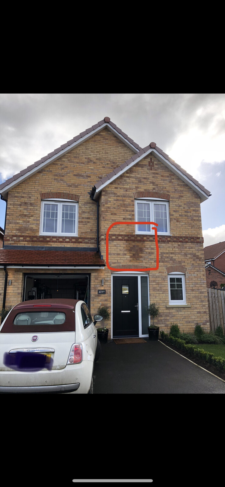

Have recently noticed a damp patch situated above the door frame and below the window frame.
Same patch is noticeable in all weathers, although seems to “dry” in warmer weather.
Was wondering if anyone can shed some light on the cause and possible remedial action?

Next time it's raining, sit in the car and look to see if you're getting any runoff from the window or roof to that spot.

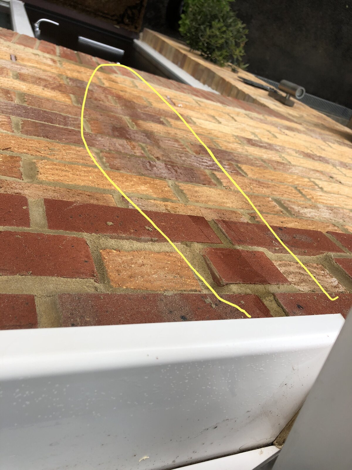

This 100%, the window to the left looks damp in same area, the cills could be falling to the left, check you have drip under the cill, if not you could form one with a bead of silicone

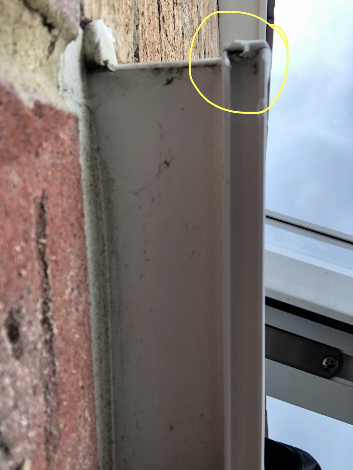

Might be a stupid question, but why would the window potentially have been installed with no drip groove -
Poor craftsmanship?
Design?
Hard to be sure from the photo, but as the frames were set well back and there is an oversailing course directly under, the drip may be hidden.

If you have a ladder and a hose with a mister you could test the window and see how it runs off the cill. Generally rainfall is pretty even over a wall, so parts that are getting soaked usually show up.
Hi all,
Thanks for your help, looks like I’ve located the problem. See images attached.
As you said, the water drains to the left. The groove does it’s job to an extent, but some droplets are falling straight onto the brickwork.
Any suggestions on steps to take next?
