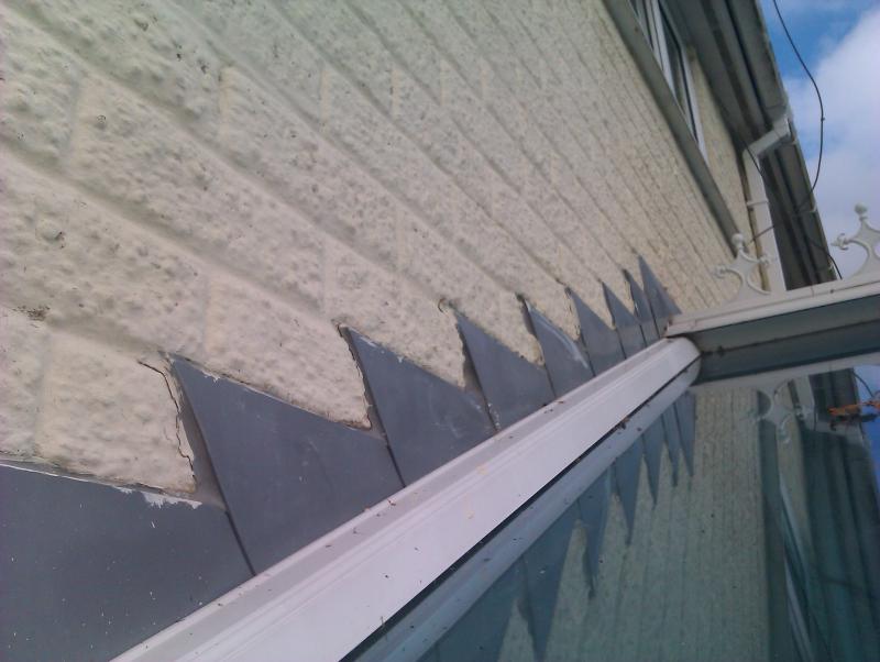

Hi, we have a damp patch on one wall in the front room (see pic). When we bought the house we painted over it but after a particularly wet week the mark came back. The mark is on the wall between the previously external wall and the conservatory. There is no mark on the other side of the wall (inside the conservatory).
The survey we had on the house said this:
"Damp areas were found at low level to the rear east wall in the living room to the right of the French Doors with damp staining present to the plasterboard dry-lining and also the understairs cupboard with efflorescence obvious to the exposed brickwork possibly caused by porous masonry, exposed location and defective flashing to the conservatory. We were unable to determine the exact cause of the dampness and as this is serious you should instruct a Property Care Association (www.property-care.org/) registered company surveyor to inspect all areas of the property"

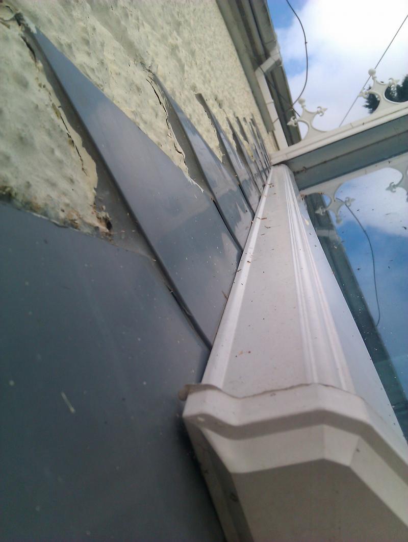

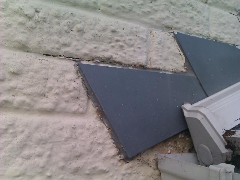

Images of the conservatory flashing attached.
Does anyone have any suggestions of things to try before getting a costly damp survey?
Thanks,
Theo.

That flashing is a joke. Its not doing anything and should be over the top of that end roofing bar, not behind it.
Your surveyor is an even bigger joke in not diagnosing the problem, but referring you to someone else. I'd ask for a refund.
As for the problem, if it's not the flashings, then it's because there is no cavity tray fitted in the house wall to cast water out of the wall above the conservatory roof, instead of it running in the wall and into the conservatory room
Now the photos are there, I see what you mean, the flashing should overlap the conservatory roof - not go under it! It's just redirecting water under the roof!
That flashing at first glance looks like lead but I suspect it is grey plastic shapes, not even chased into the brick work! cosmetic.

The flashing is plastic.
I've had a good good with a generous amount of silicon sealant so we will see if that helps.Thanks again.
We've not really had any change yet. We have put sealant along half the adjoining conservatory roof, the other half to go... it's not done anything either way.the damp isn't getting worse, which given the weather (floods down here in the south west) is good. We are going to finish sealing it all up and then try get it dry through the summer and hope it doesn't come back. Short of getting a damp survey done £200 I'm not sure what else to do.
