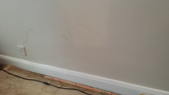

I've been doing some renovation work on a semi-detached bungalow where the chimney breasts were removed some 15 years ago. When the walls were skimmed a stain was noticed on the wall at floor level where one of the breasts had beem removed but it was perfectly dry and thought to be 'historical'. However, we now find that when it rains the patch becomes damp and when the rain stops it dries out.
I have looked in the loft and there is no sign of water penetration. Next doors adjoining chimney breast has been blocked off (no vent installed) and an electric fire fitted but they have no signs of damp.
A local roofing firm has been called in and they are 99% sure the problem is not coming from the adjoining chimney.
The patch is approx. 3 feet wide rising to about 1 foot high in the middle and extends across the floor by about 1 inch.
The problem had not been previously noticed as the wall was papered with a very heavy vinyl with a large sideboard stood in front.
Any ideas as to the cause.
