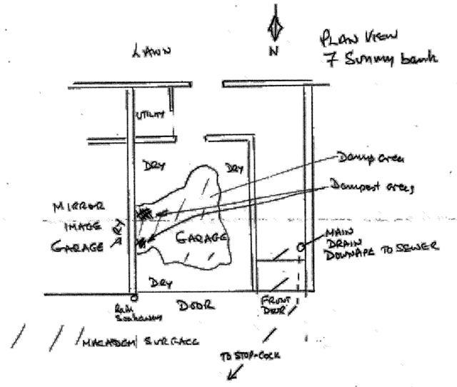

I live in a 40 yr-old terraced town house with the garage on the ground floor.
A spreading damp patch has suddenly appeared in the garage concrete floor.
There are no water-pipes under the floor, or leaks from pipes in the garage. My neighbours do not have any damp showing in their garages.
What could cause the sudden appearance of damp after a prolonged dry period? Anyone got any suggestions for tracing source or treating floor? :?:

Plan View and photos of garage uploaded.
Key Facts:
1. There has not been rain for past week
2. No car in garage for past week
3. Garage and rear doors left open with through draft for last 3 (hottest days) with no sign of drying!
4. Front of garage is Macadam, to rear of house is communal lawn that has not been watered.
5. 7 Sunnybank middle house in row of 9 built on flat ground with river valley ~3/4ml Nth.
6. Neighbouring garage floor bone-dry.
I've now covered garage floor in plastic sheeting to:
a) Ensure their is no water coming from above.
b) So that condensation from below will locate source of dampness?
Looks like that BUT there are no records of underfloor pipes OR any services routed that way!
Mains water comes in across driveway under front door and runs up through 1st floor kitchen to cold water tank in attic. Then feeds hot water cylinder on 2nd floor. All hot and cold feeds to ground floor run at ceiling height.
All pipework in garage appears dry.
Will report tomorrow on plastic-sheet findings.

Hi bogwart47
If you can access the Plan and photos posted to the Forum you'll see the layout but to answer your questions:
1. Yes there is a garage the other side of the wall but it is completely dry.
2. No, none of the overhead pipes (original build), are above the dampest patches and they show no sign of leakage or stains (although I first suspected frost damage to the soldered joints in these pipes).
3. As we have guests staying it will be another week or so before I can do a thorough water-meter test.
4. Postcode SK9 1ND
5. The townhouses are built in the grounds of a former large house but mine is close to the road and unlikely to have been built over the site of the old house.
Hi John,
After a cooler night, there is absolutely no sign of water on top of the plastic sheets covering the garage floor. As a control, I placed a saucer of water on the corner of the sheet and there was very little evaporation. Tonight I'll spread some talcum.
There is a stop-cock located 10m from the front door, as indicated on my Plan.
