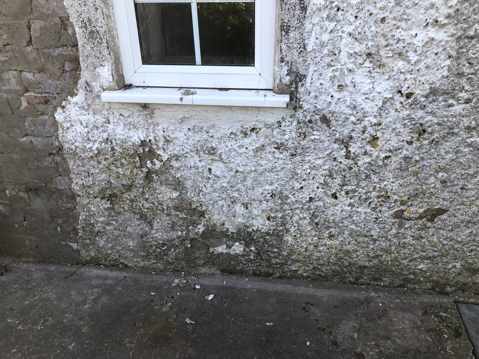

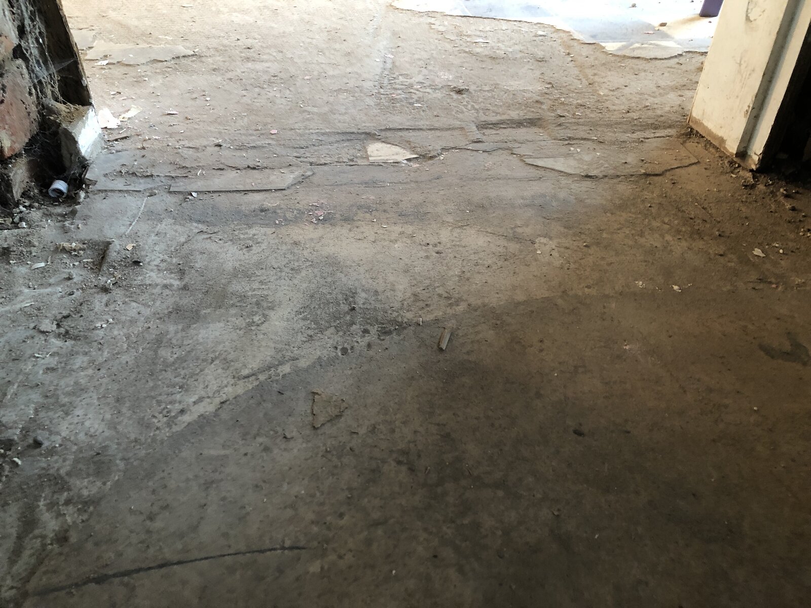

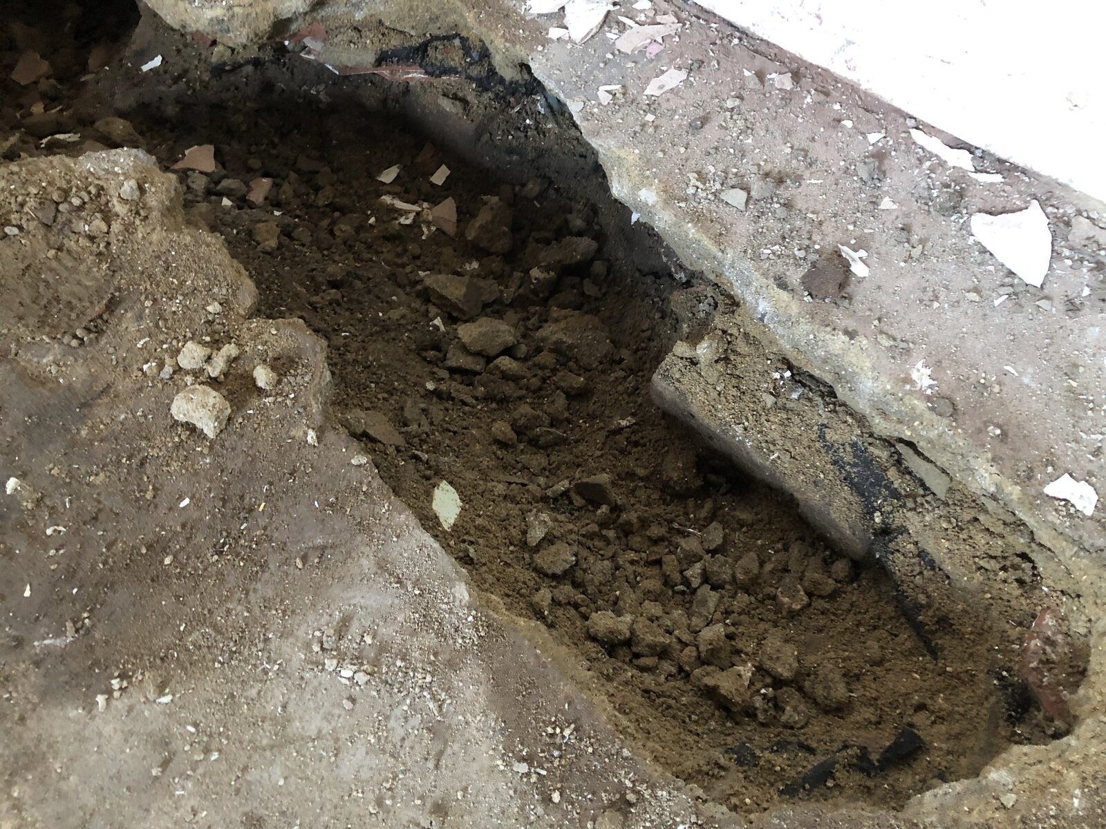

Ive searched this topic in the forums, but all the hits seem to be very old .. so hoping there may be some updated information available. My house is estimated from around 1900 and has everything wrong with it, including quite a bit of movement. One of the endless list of issues is damp patches on the very uneven concrete kitchen floor (which is well below outside level and approx 1cm below level of adjoining hallway). Ive dug out the part of the floor which had the biggest damp patch, and found only wet compacted earth (no puddles), under the sand/DPM/1.5 inch concrete/thin screed. I didnt find any pipework etc. Im then assuming that the DPM under the concrete has failed where the damp patches are, so wondering if I can simply lay another DPM on top of current concrete (after filling in my hole) and screeding on top of that? Or do i need to dig out concrete of whole floor (4.5x4m) and start again?
Or indeed am i missing the obvious in my search for pipework possibly?

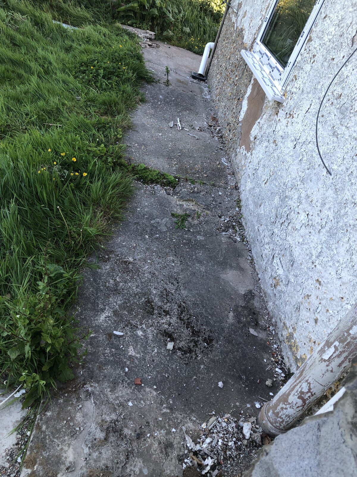

Probably not helping with the damp ground is the external concrete path which almost abuts the rendered house walls, with just a small gap (1mm) between the two along most of the house walls. I was thinking to fill these gaps with concrete or caulk. Would that be the correct thing to do I wonder?..
And i was also considering a chemical injected DPM - to cover all angles. Would it be worth it?
The structural surveyor suggested I spend as little as possible in making the house liveable for the 5 years I anticipated staying here .. as its not going to be an easy place to sell, when the time comes. So this is also a consideration. Any guidance would be hugely appreciated.
99.9% of ground floor damp issues are resolved by lowering the ground around the house so it's 6 inches minimum below the inside floor level. If it was mine, I would have the floors dug out, 1 inch sand, 1200g dpm, minimum100mm kingspan with minimum 25mm kingspan upstand to outside walls, 1200g dpm again, and then 4 inch concrete.
Or, 1 inch sand, 1200g dpm, 4 inch concrete, minimum 100mm kingspan with minimum 25mm kingspan upstand to outside walls, 1200g dpm again, clip underfloor heating pipes down, and then 75mm underfloor heating screed.

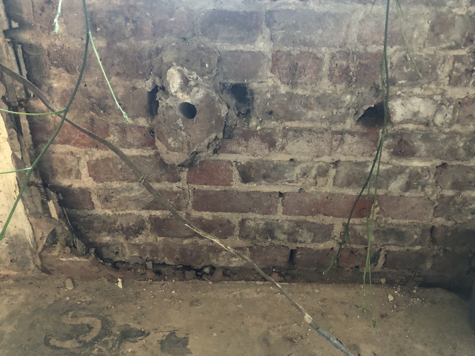

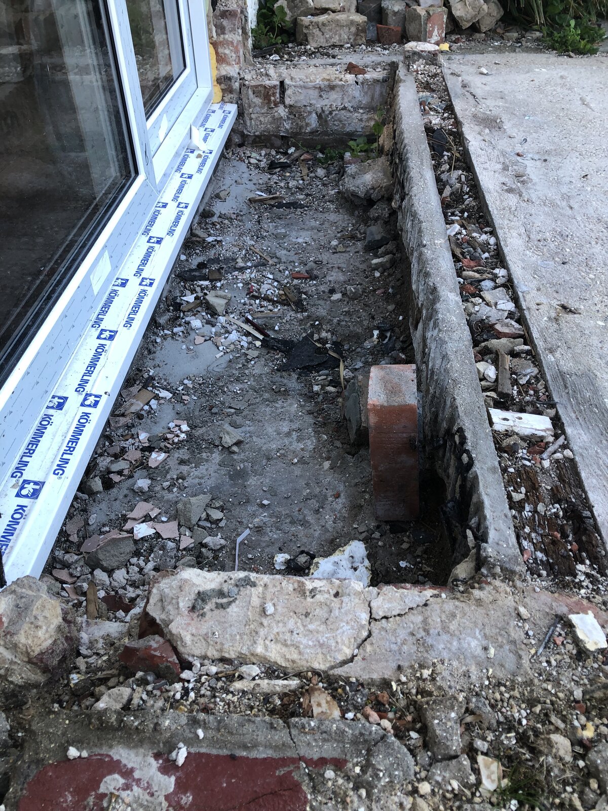

Thanks everyone. The idea of taking the outside level below inside level is pretty much impossible around the whole house, though I will be doing something with the patio area to drop it and put drains in .. as you can see from the picture, the patio door (dining room) is approx 30cm below outside, and the floor of the dining area is another 10+cm .. The large garden slopes to the house.
As for damp, its not showing via mould etc on the walls, though they all have the membrane between brick and plaster, which has surely helped. The other tricky thing to determine damp is that there would have not really been any heating on throughout the house for probably 4-5 years ..
Just another thought .. the structural surveyor suggested doing as little construction work around the house as poss, to reduce the risk of further movement. Plus I really really need to keep the costs down as Im already at double my budget and barely have a shell of a house.
Hopefully the pictures show the current situation more clearly.

you can dig a french drain beside the wall, but at the age of your house it is to be expected that the drains and water pipes are leaking.
