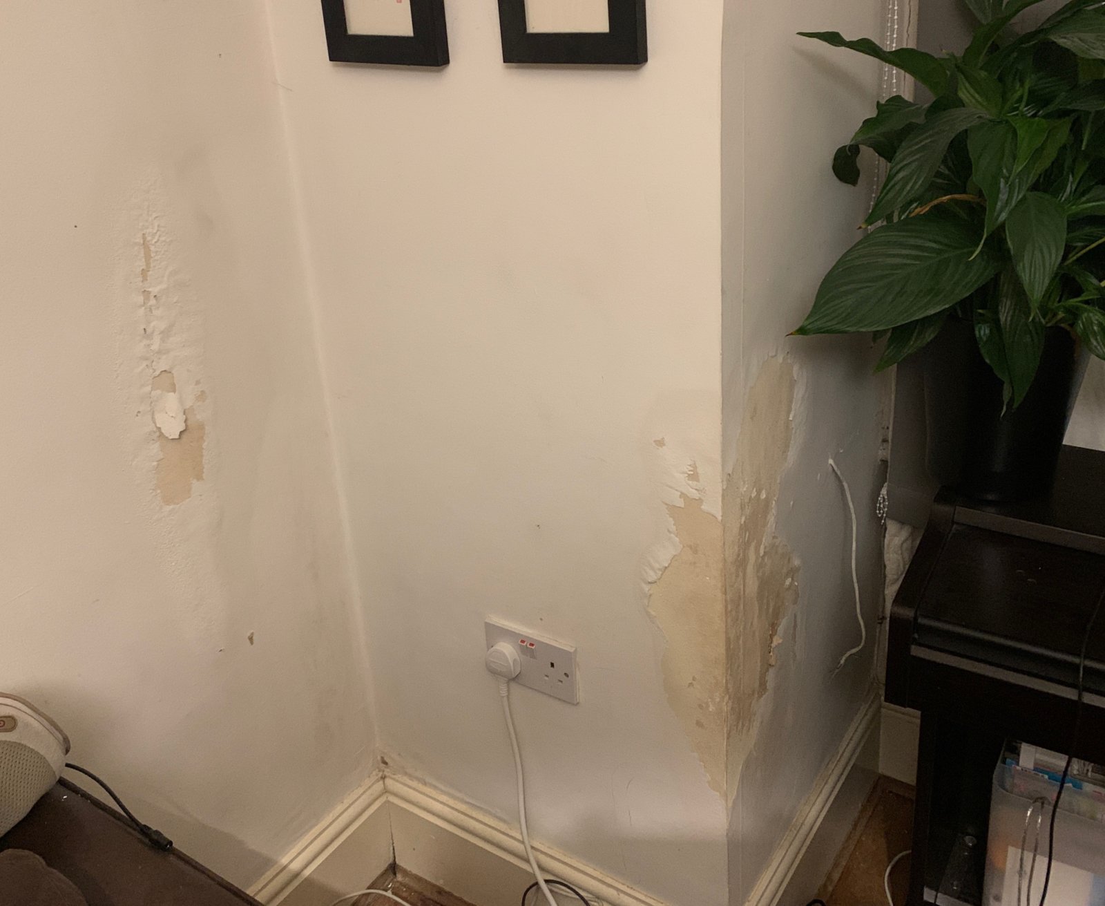

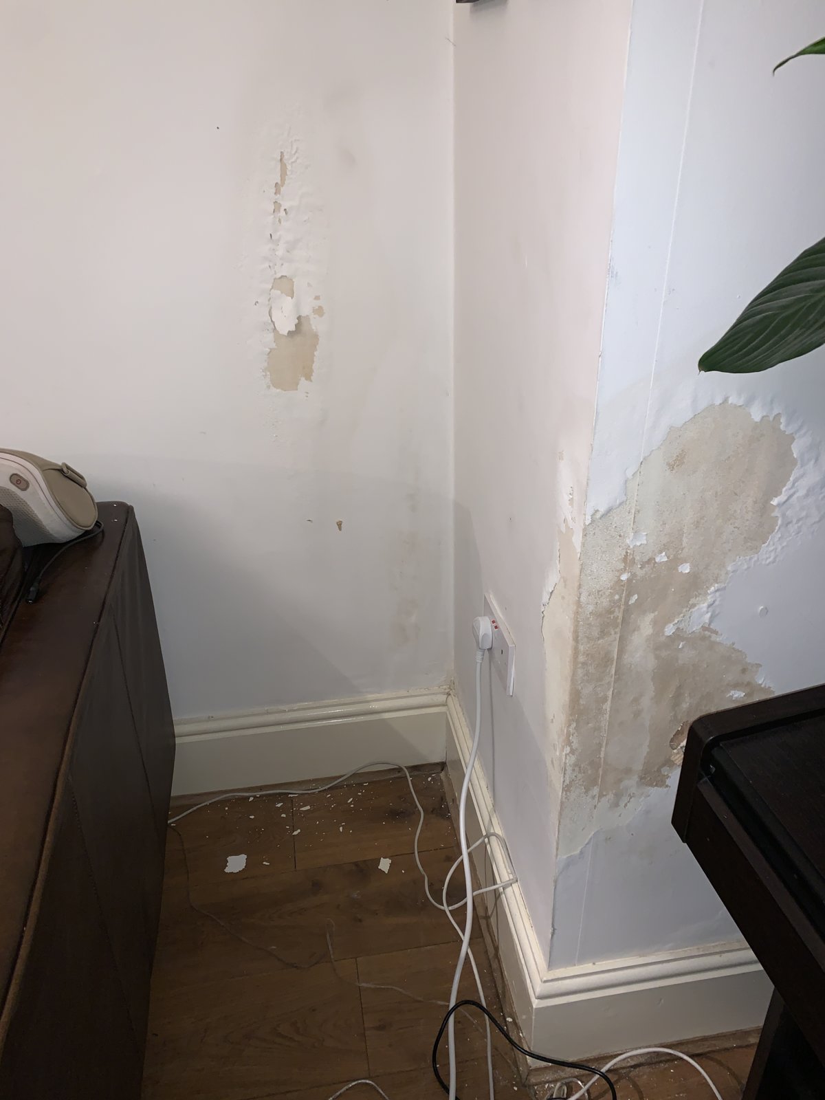

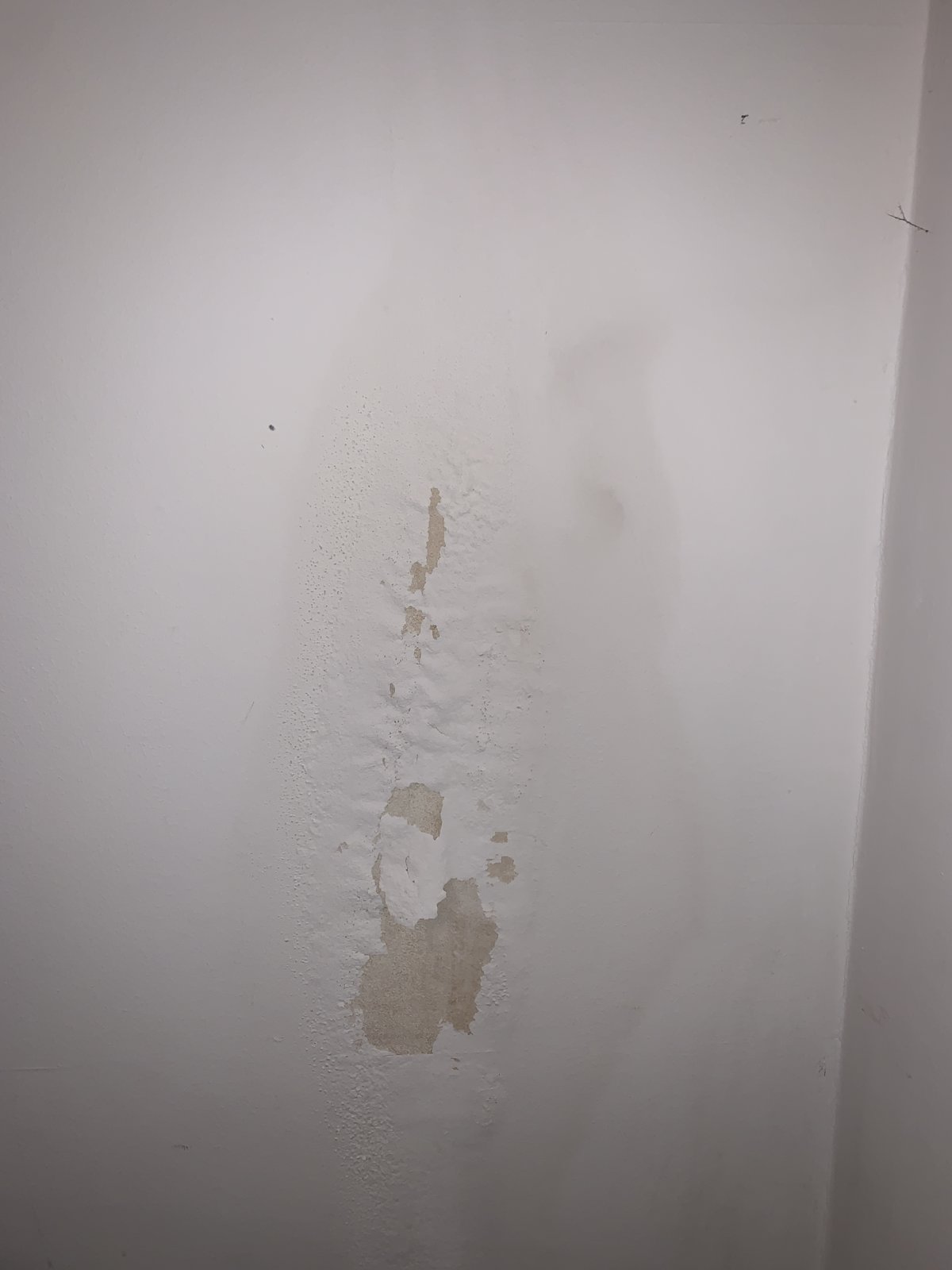

Hi all,
I have a Victorian era terrace house with some damp patches that have come up in the last 2 years, mild initially. Now the wall destruction seems to be accelerating, causing rising flakiness! The outside aspect of this bit of wall doesn't get wet (it is sheltered). I've read a bit about damp and the causes. Particularly about the controversies around the existence/treatments for rising damp. For if this isn't it, then what could it be!?
I'm suspecting that the plaster on the walls are gypsum, given that some of it looks pinkish underneath. This would mean that it is relatively non-breathable and thus may trap moisture in the solid walls. I can't see any leaks anywhere, nor excessive moisture on the nearby windows. No gutters spill down that area.
So would my first step be to replace the plastering in that area with a 'breathable' plaster? Any recommendations on what products are best?
Thanks for opinions!

soot/chemical reactions in the chimney breast flue might be a major cause of your difficulties?
there are signs that the area has been worked on in the not too distant past. do you know anything about previous work?
can you step back, clear any furniture, and pic the whole chimney breast?
and pic the back wall of the c/breast from outside?
is there a fireplace open or blocked in the room above?

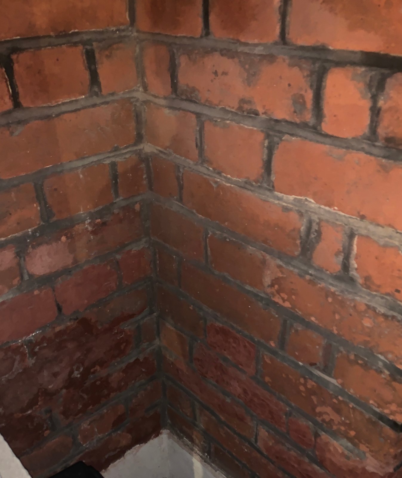

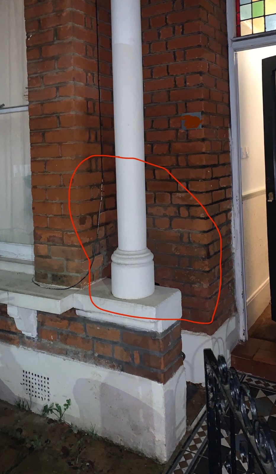

It is not near the chimney breast. It is actually part of the front of the house. Included photo to show you where it is on the inside and out. Thanks again!!

the headers in the wall suggest that its a solid wall.
the external sand and cement plinth suggests that the plinth might have been installed in an attempt to combat previous damp?
the plinth should be cut off from contact with the ground - by about 40mm - 50mm.
there's an air brick that seems to be set too high for venting the suspended floor - i assume that you have suspended floors?
i'm surprised that you dont report further damp signs in the hall, and below that (bay?) window?
it looks like rising damp so IMO: the best remedy is to remove the skirtings, & knock off the plaster back to brick, to about 300mm beyond any damp signs.
then render with a 4:1 or 3:1 mix of sand & lime, skimmed with Limelite finish.
if you have a metal corner bead and its rusting then saw it off above the rust, and replace with a plastic bead.
have you ever been under the floor & inspected your joists for rot or excess condensation?
do you have air bricks venting at the front & rear elevations?
the original step would probably have had a vent grill below the nosing - but the new tile step will have blocked that ventilation for the hallway sub-area.
doing the above will give you quite a few years of damp clear decorated surfaces - it will not remove or "cure" any kind of damp. it will merely mask the damp.
