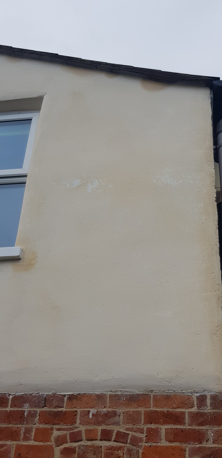

Good evening,
My wife and I bought our house (1880s semi) in November last year, we've had the old cement render ripped off as it was cracked and leaking, and had it replaced with lime. This all now looks great but we've noticed damp patches appearing on the tender when it rains, just underneath the roof edge. I'm guessing the underclosk.might need replacing but wanted to ask advice? And is this serious.
We've got no damp reading inside the property in that area so dont believe the roof is leaking.
Any advice regarding what this might be, and what to do would be greatly appreciated. I've added a photo for clarity.

Thanks for the response, is it best to get the undercloak replaced, is that the likely issue?
probably is an under cloak issue.
what lime was used?
I'm not sure, we paid someone recommended to do it. It was a traditional lime render, with horse hair weave mixed in. It then had several coats of lime wash as a shelter coat.

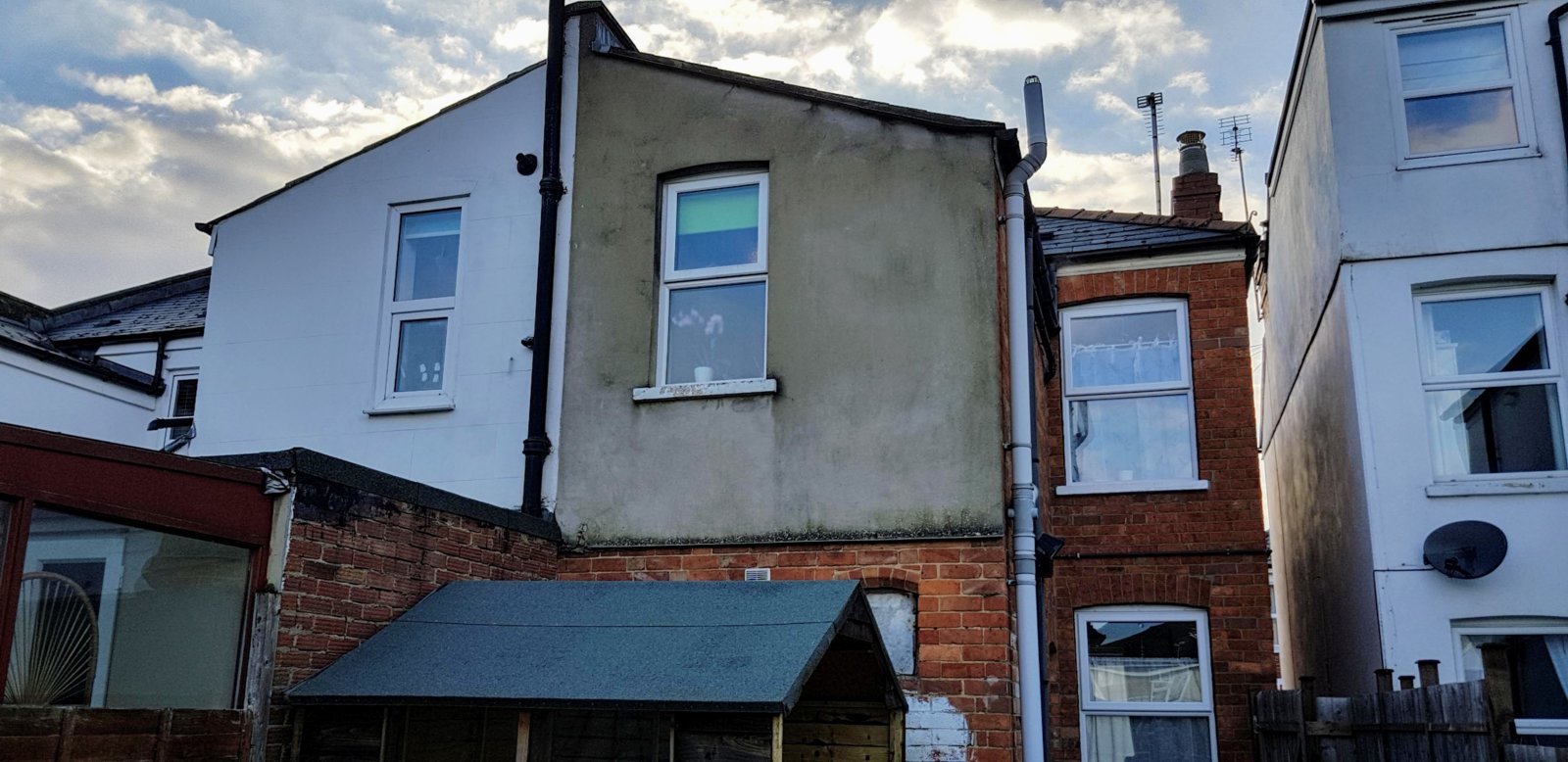

I think the undercloak issue has been there for a long time as where the dalp patches are the previous cement render had cracked. See the photo prior to lime render.
Would we usually get the undercloaking replaced?

You could put a small fascia board up in conjunction with a continuous dry verge to shelter that area.
That's really helpful, thank you. You don't think I need to get the undercloak, verge, and edge tiles removed and recemented?
