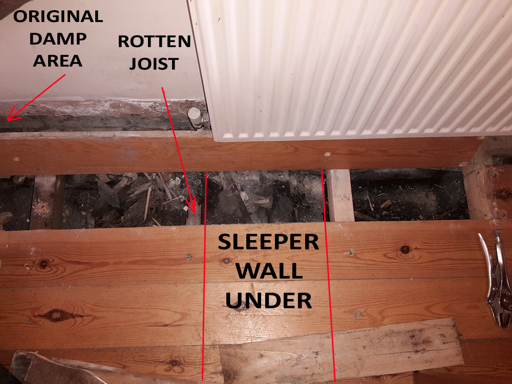

Hi All,
I've got some moisture coming up a party wall from the bottom in the middle of a ground floor room. I've removed some render and a section of the floorboards. I'll try to provide as much information as possible but ultimately I'd like some advice on how to prevent this from re-occuring.
- ground floor room
- party wall, non cavity
- area of concern starts in the middle of the room
- suspended floor
- air vents clear all around the house (could do with bigger vents)
- unsure if neighbouring property has any/similar problems
- the brickwork the joists were resting is damp
- the brick above appears to be dry although the mortar seems damp
- the end of the joists have rotted (will be re-instated once the damp is controlled)
- the lowest level below the floor is dry ie the ground below the floor
- unsure how far it extends along the wall but suspect it runs along to the external wall
- a chimney breast was removed at some point 1m plus away from the exposed area but remains in the adjoining property.
- musty smell which could be a combination of the wet debris and timber, not evident before exposing the area.

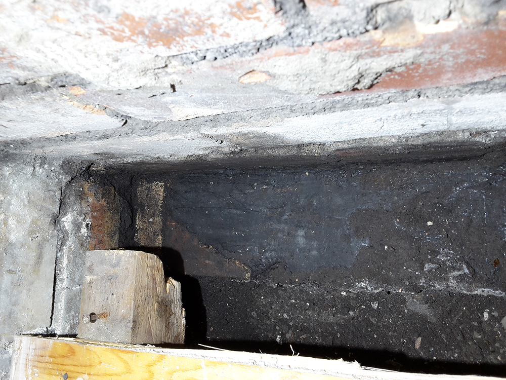

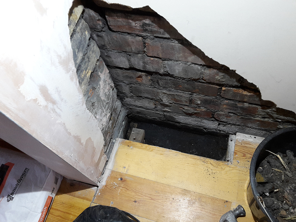

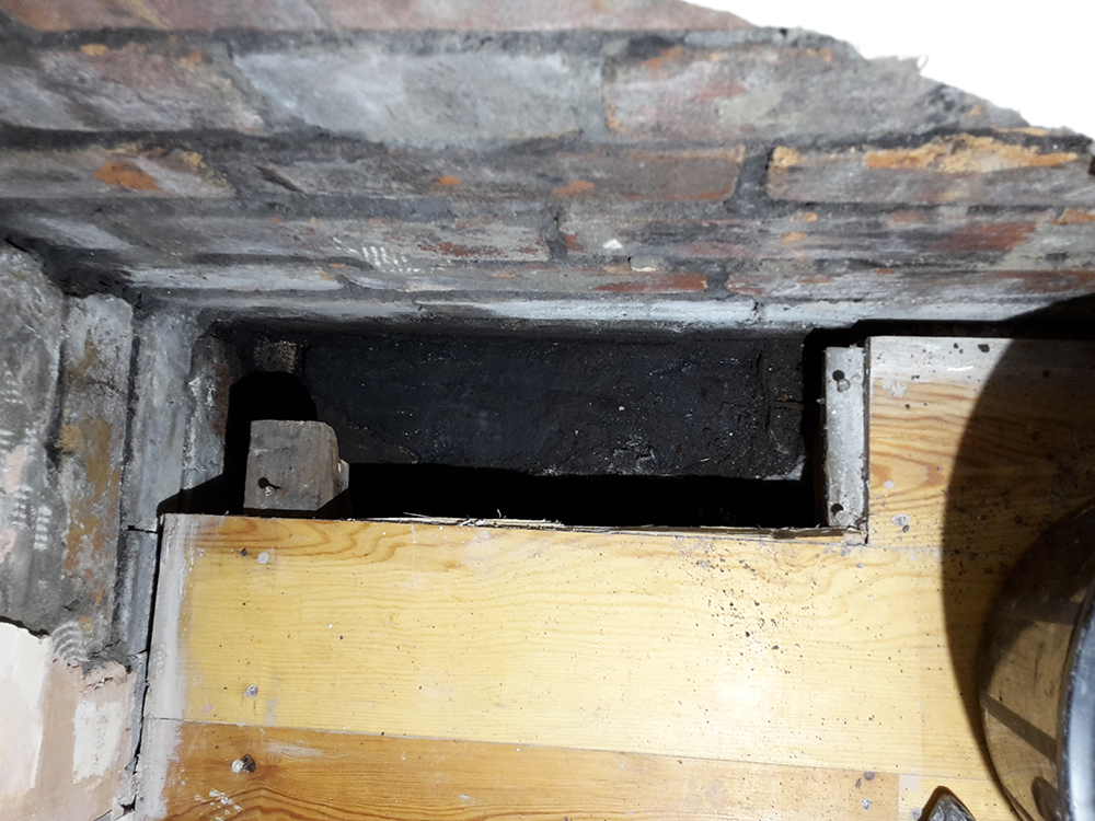

Some photos - corner joist has been cut as it was rotten and wet.
The black 'pad' appears to be some sort of epoxy. Is this the DPC? It's easy to pull away and has failed at some point, possibly leading to the moisture getting into the joists. I excavated quite a bit of dirt/debris around the joists which was on top of the black pad. Some could have been from removing the render.
I'd like to sort the joists out and rest them on something that won't allow damp to propagate. I'd also like to make the wall good and prevent the damp re-occurring up the wall. Any advice appreciated.

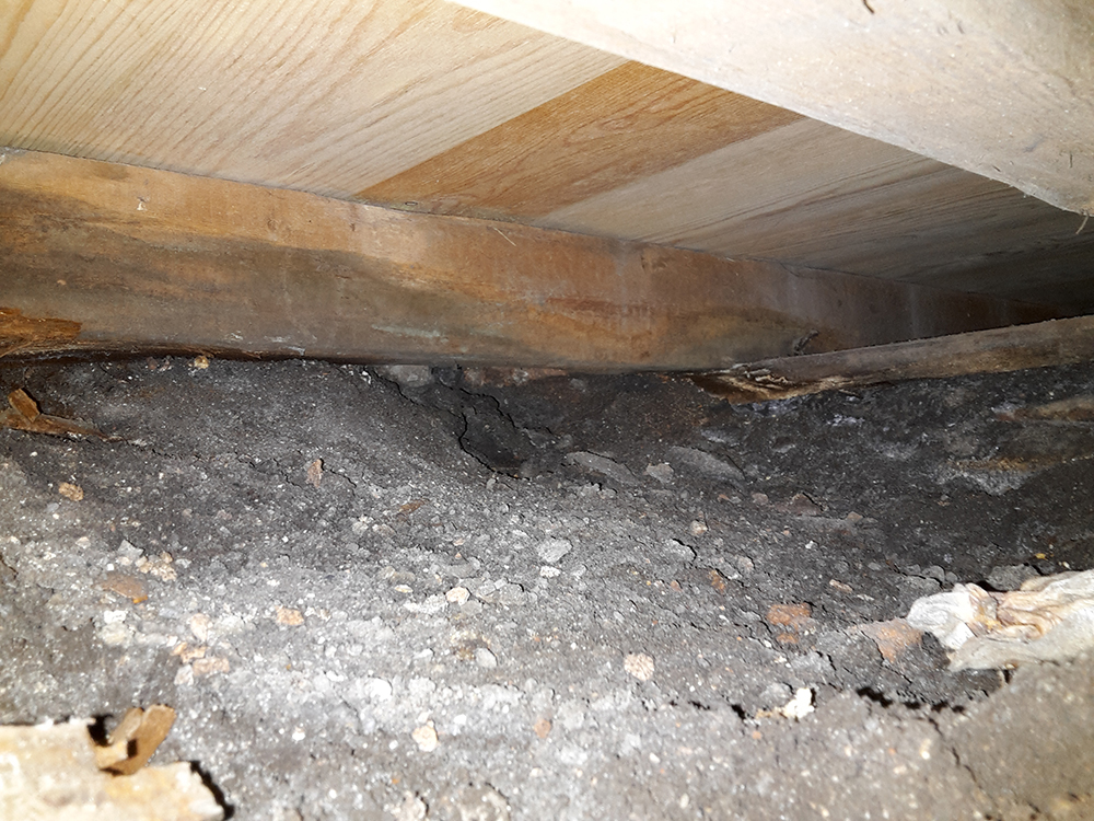

For those following along at home, I finally got around to a bit more investigating under the floor. The boards aren't coming up very easily but need to keep them in reasonable condition until replacement.
There appears to be a low wall running parallel with the joists which has a load of rubble/debris blocking airflow. Since I lifted the original floor board and removed the rubble the wall has been drying out nicely. Not sure why the wall is there. The joists either side of it appear quite different in age. Original wall maybe?
Location of wall under joists
View under floor from left hand side of wall
View under floor from right hand side of wall (copper pipe from rad for reference).
When I take the floor up I'll look at what this wall is actually doing. Currently I'm guessing not a lot so will be modified/removed to allow airflow and sort out my condensation problem.
