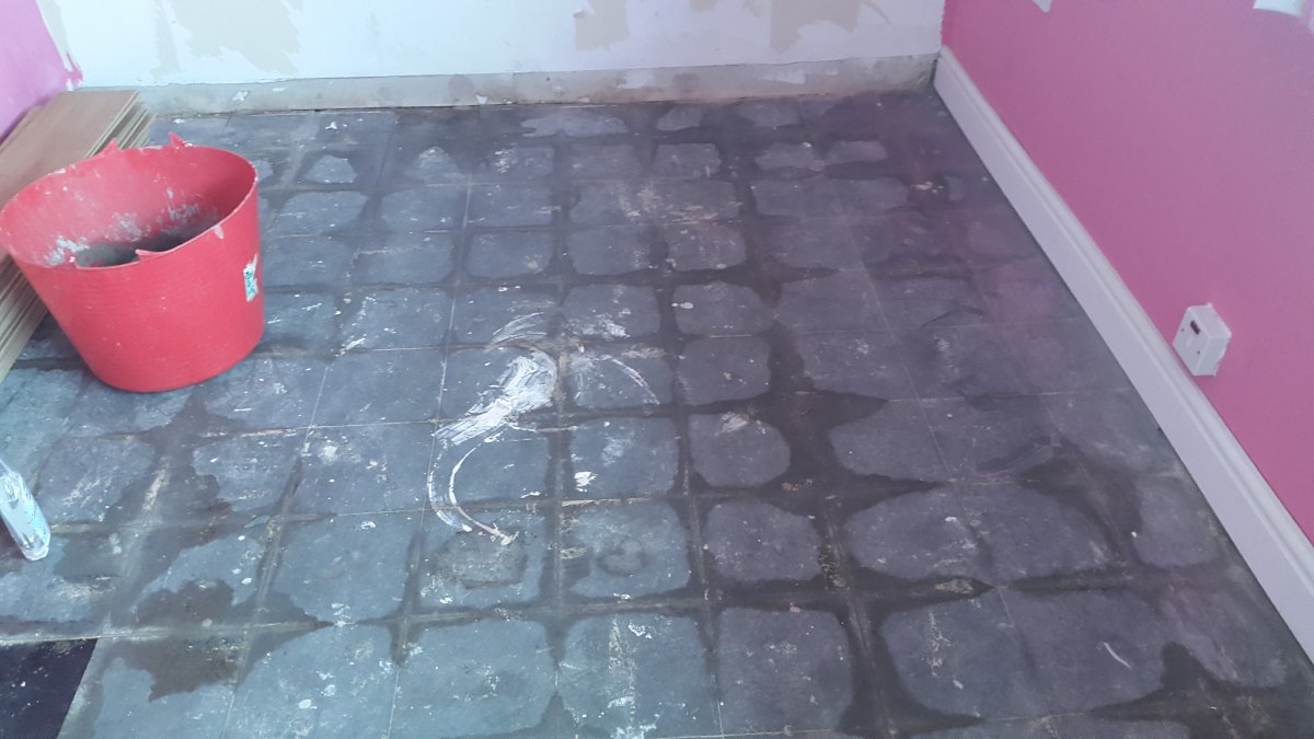

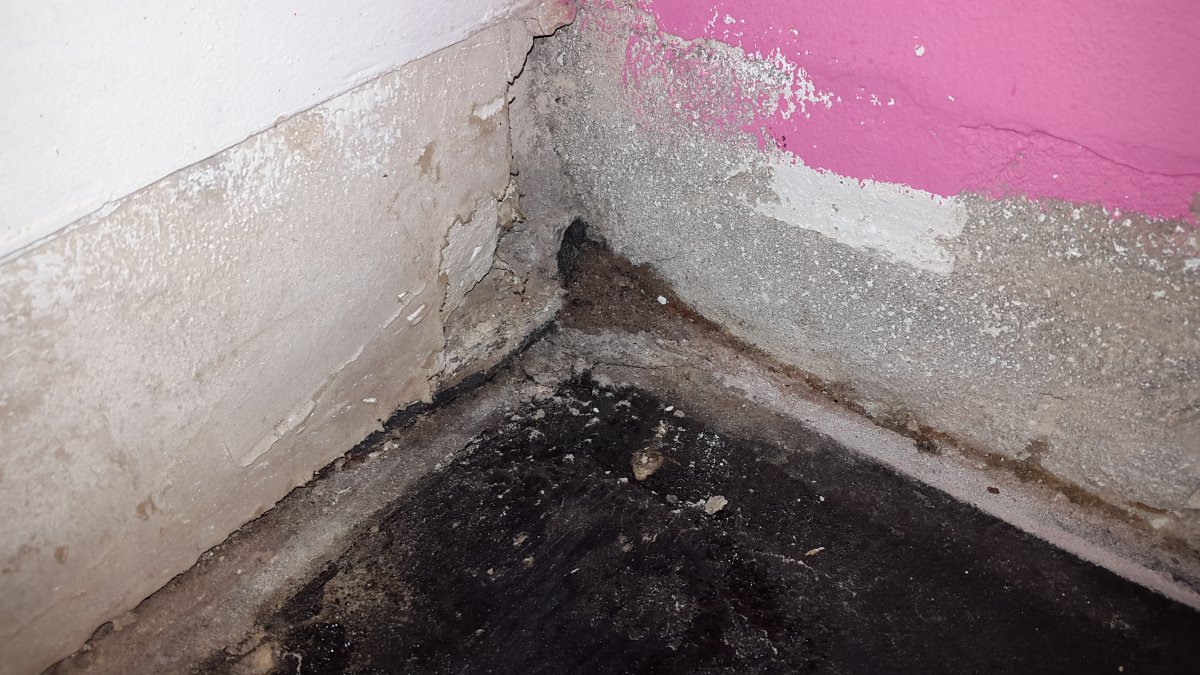

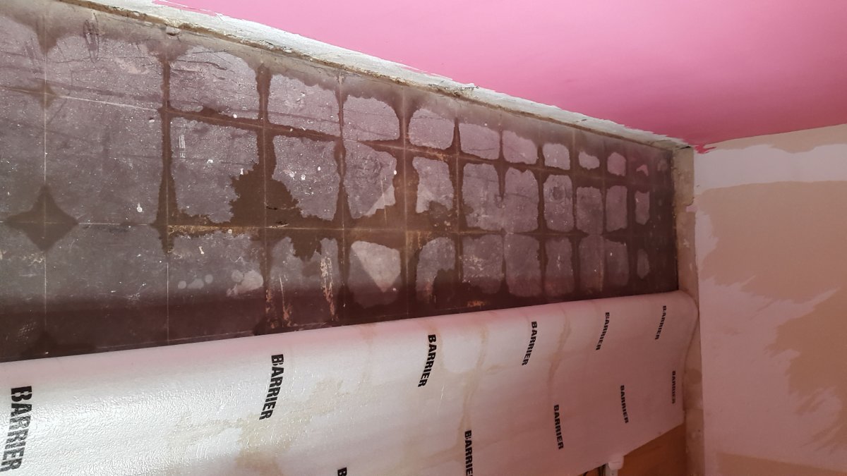

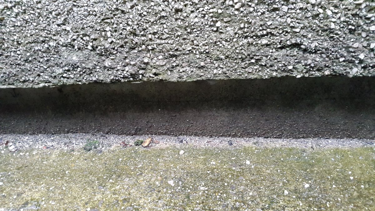

I bought a 1950's bungalow last year which is on a hill and one of the bedrooms at the back (up hill) has had a damp smell since we moved in and decorated. Eventually took the new laminate flooring up and there was damp in between a lot of the old floor tiles underneath (see photo). I have since taken the tiles up and painted a layer of Wickes liquid damp proof over the bitumen adhesive that was underneath and it now looks pretty waterproof! However, I'm not entirely sure if the damp is rising up through the floor (because of water migrating down the hill under the house maybe?), or whether its more likely to be coming in through the walls somewhere? There were patches of damp on the floor along the external walls, but not really a lot more than the rest of the room and the walls all seem fine. I notice the external has pebble dashing all around apart from on the bottom two bricks, not sure why? However, on the back wall of the damp bedroom, this layer of brick has been cemented over (see other photos). Would this have been done to try to stop the damp problems maybe? Would it be a good idea to paint some water sealant for brick over these parts? The same wall of the bedroom has also been replastered quite recently by the looks of it (where i've stripped the wallpaper in the photo).

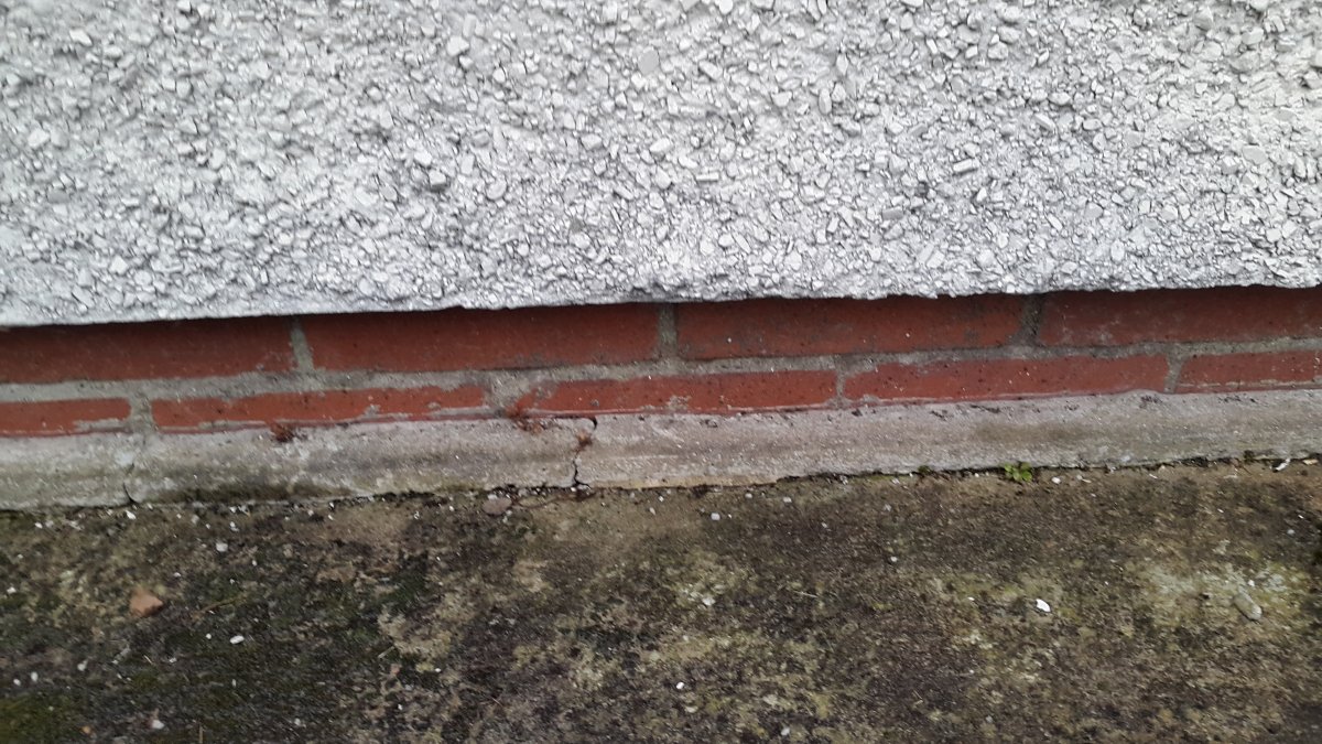

That pic with the line of bricks in it. I reckon that your damp course is lower then the path and a bodger tried to fix it by putting a bit of render on it. The problem is that the water will run down hill between the path and over the damp course showing up as the wettest spot at the down hill end. I would lever off some of that cement to locate where the DPC is. Cut the path back 2" from the wall and dig out a groove so water from the path can drip down into the soil (throw a bit of gravel in to pretty it up). Follow this around the whole building. You may find that the DPC suddenly steps down some where, but the path is on a slope so its higher then the DPC.
Frank

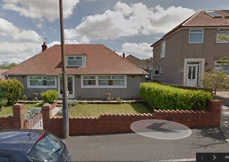

Hi Frank, thanks very much for your reply. I've had another look at the bricks and just underneath where the pebbledash finishes and the bare brick starts, I can see a black slither all the way along which I'm assuming is the damp course so this is above path level and is around the same level as the floor inside. I will hack off a bit of the rendered section to see if there is a step down in the damp proof on that side like you suggest. I have attached a picture of the house so you can see the path and the way the hill is running, the affected bedroom is the window on the right. Next door is obviously on a higher level and the grass does get quite a bit boggy on that side so I'm thinking it probably is more likely that its rising through the floor than coming in anywhere? I haven't noticed any damp smell in the bedroom next door though (also on the high side facing next door), so it's a bit strange how it is so bad just in that room. Is that amount of water coming up serious or am I worrying too much do you think?

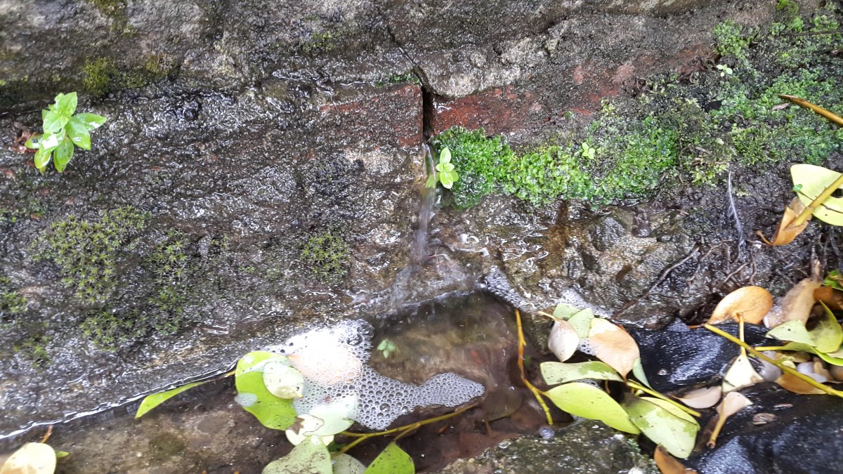

Should also add, there is a fair bit of water coming through the wall from under next doors drive every time it rains - see photo (this is just behind the bush in the last photo, at the corner of the house - you can just see the corner of the path at the bottom in this photo). I am channeling the water away using a french drain/land drain which goes across the lawn and out onto the path by the gate, but guessing a lot is still being soaked up in the soil. I dont really want to bung this hole up as I'm guessing it will just build up and make its way out somewhere else where i cant keep an eye on it?
WOW! you have a stream running towards your house. If the DPC is intact then water will not rise through the brick work, but if the high water level is leaving a large puddle within your walls under the house, the water will constantly being evaporated and when it hits the more or less waterproof bitumen glue/PVC tiles it could condense into real water again and mark the floor boards.
First thing is to make sure that all your gutters and drain pipes work properly, no point adding to the water overload. I think the next thing is to pull up a floor board and have a look. If you are unlucky, your floor joists will be rotten and will need attending to. One thing that has not been mentioned are air bricks, are there any?.
