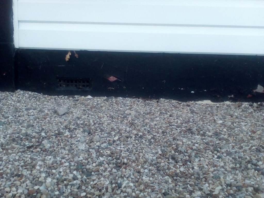

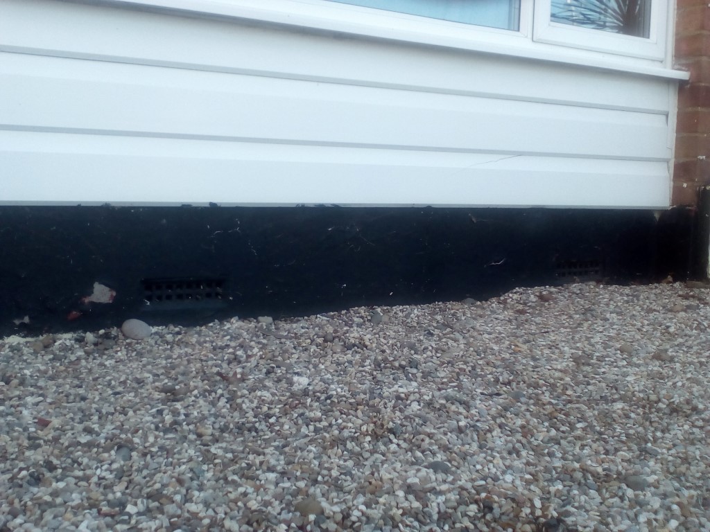

Cheers for reply. So two pictures of front, the house floor level is basically where the cladding starts. Had a builder round today to quote to raise the airbricks by one brick as the flood went halfway past the airbrick.

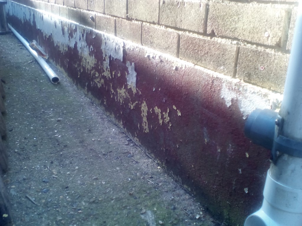

Then one picture of down the side, I don't know what this rendering is over brick but I'm going to get 3-4 airbricks put down this side and then the render will be all painted and sealed.
Was also advised to dig a pit in front of the concrete raft (foundations, protrudes 1 meter round house) to stop the water flooding out the front. However I've looked online and it states that soakaway pits need to be a minimum of 5 meters from front of house which isn't feasible as I have a tarmac driveway just after 4 metres and by then the ground is higher up.

If your house is located on a hillside then that might be the root cause of your damp difficulties.
Are you saying that all or part of your house was built on a concrete raft - & that the wall or walls were set back 1m from the edge of this raft?
But you still have soil in the sub-area?
Is your sub-area covered with a layer of concrete?
Is this raft or concrete projection visible on the ground surface or is it located at some depth?
Is the ground surface in photo 3. (the photo with the red render) the raft projection you are talking about?
Photos of the hole area plugged with foam might help - believe me, masses of foam doesn't sound like a satisfactory solution.
The black (bitumen) painted area - is that render?
Likewise the red painted area render plinth seems to have been painted with plastic paints - bad, only masonry paints should be used. Dont seal anything.
Plus all render ground contact should be cut back by say 150mm.
Can you definitely indicate where your DPC bed is in the photos?
I dont understand what you say about the rear elevation & air bricks?
