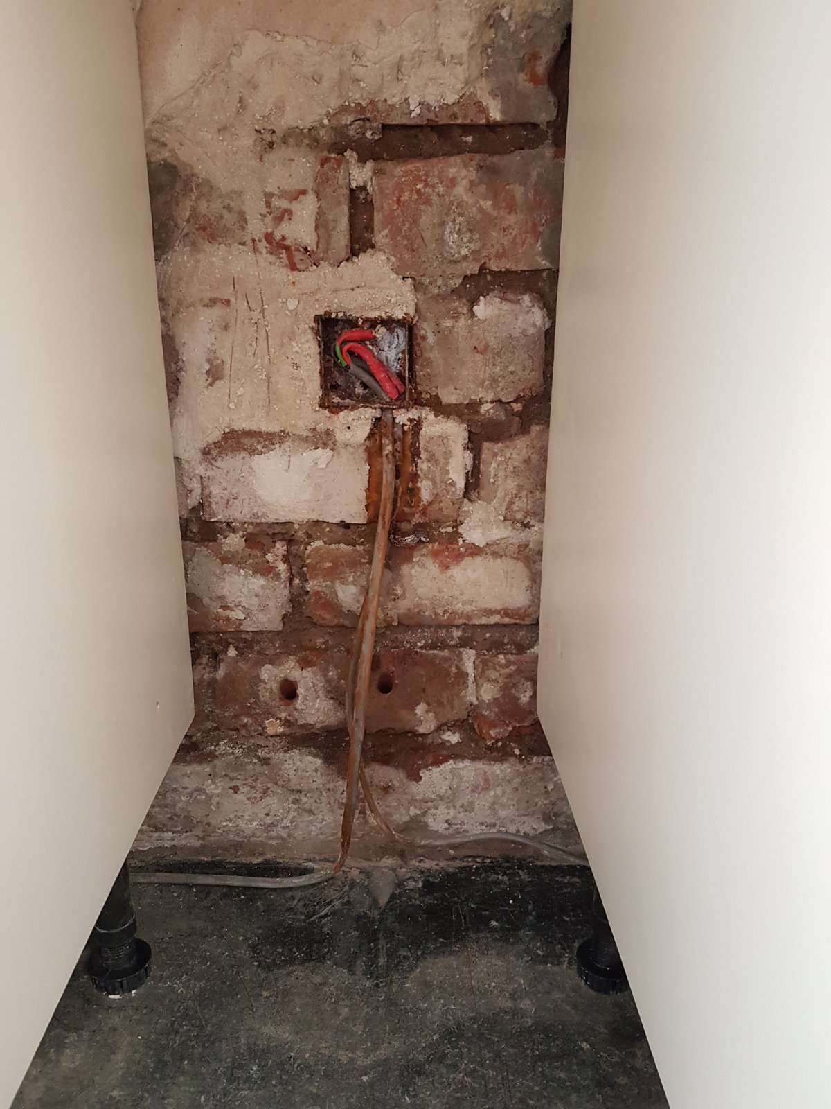

I Managed to remove a cupboard and the plaster underneath was soft, like clay in places. It seemed localised to the cupboard that I removed fortunately. So I stripped off as much plaster as I could. The plaster at the edges of where I could reach to strip it off is feeling dry (pic)

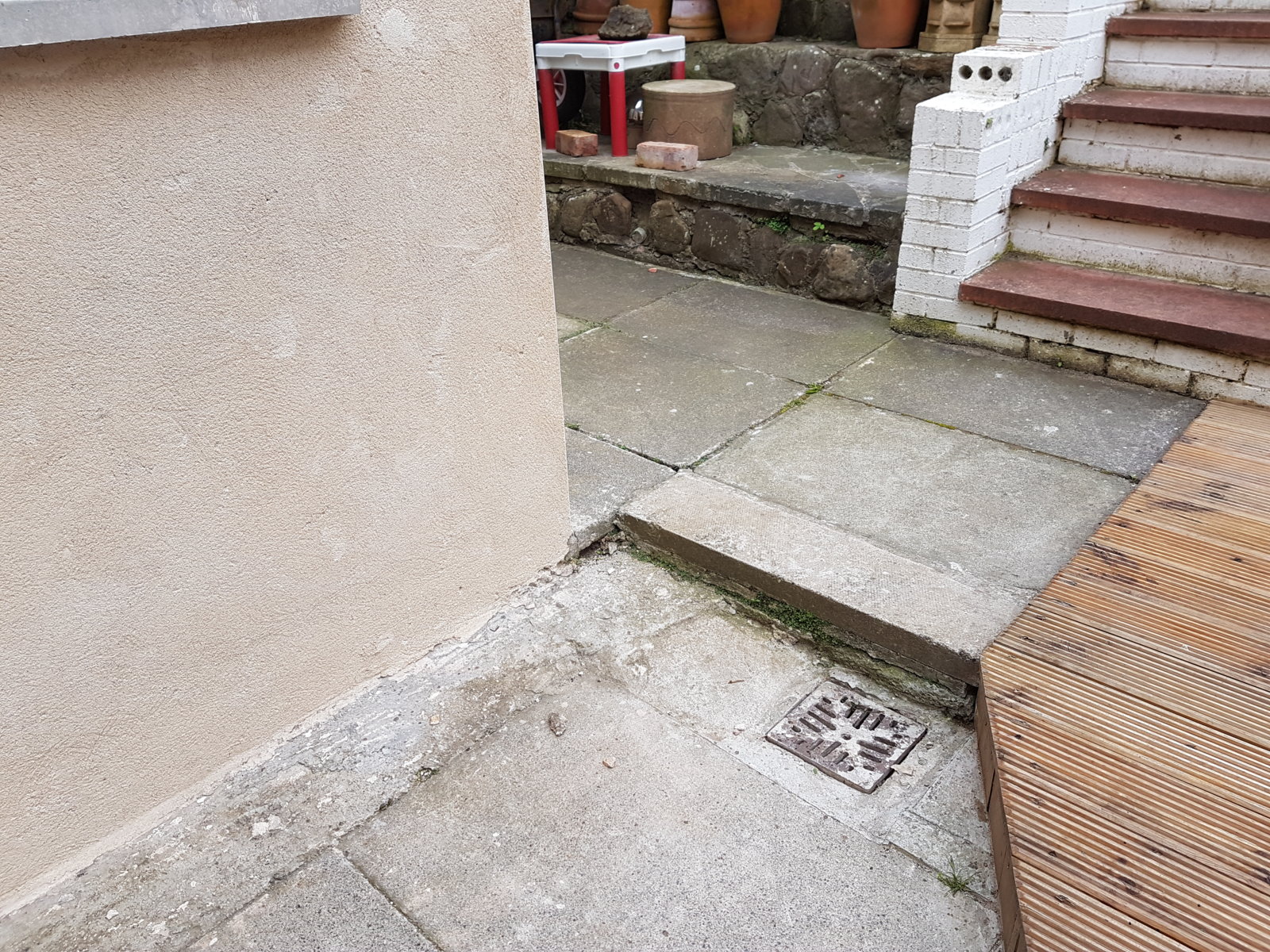

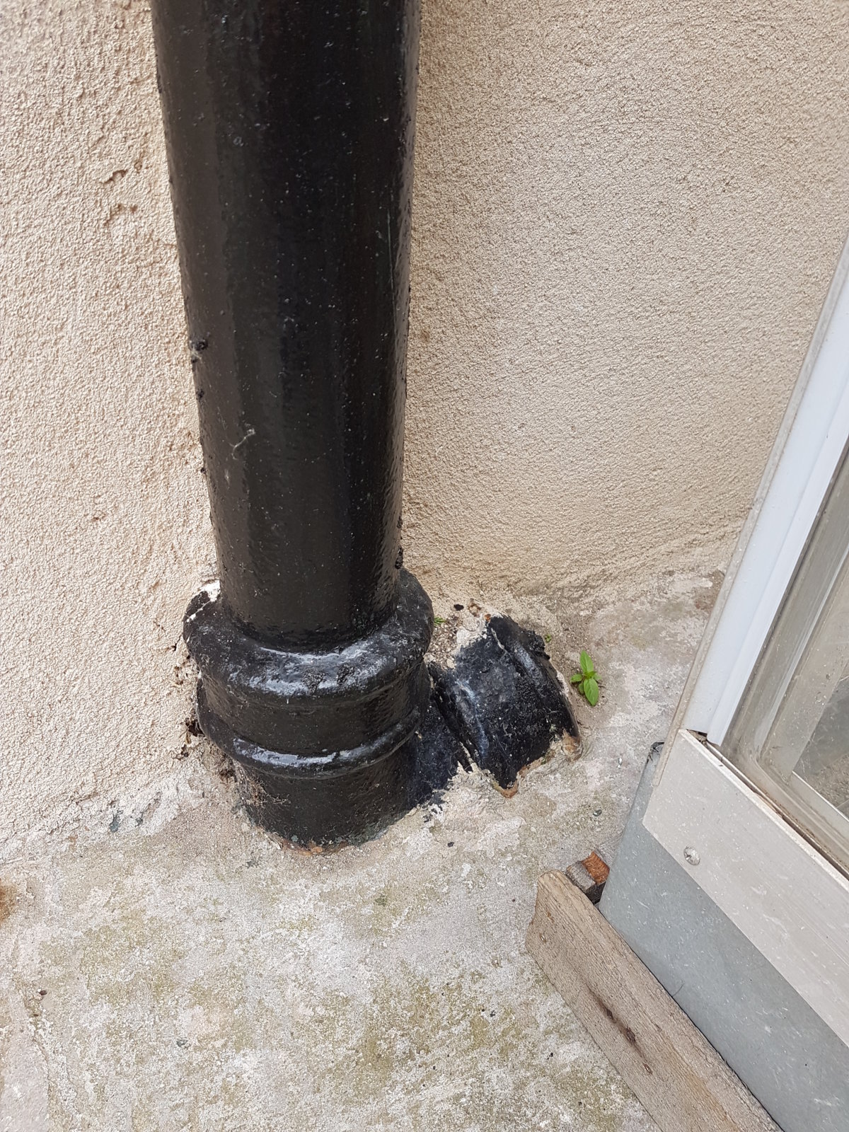

On the outside of the wall there is a patio against the wall, at the same level as the internal floor (pic). This raised patio is only against the damp wall the other wall has a lower patio against it. There is also a cast iron drainpipe going into the patio with a blocked off T at ground level (pic)

3) Should I cut a trench at the join of the patio and wall to fill with gravel to aid drainage?
3b) If so I imagine the wall will be exposed, what to do with the wall below the gravel level

probly bst to pull all the base units from that wall and hack off all the remaining plaser.it looke like gypsum plaster which is badnews .
and injection holes from a failed chemical dpc can be seen.
rising damp and condensation in the wall are probly happenin along the wall.
the back box should be replaced with a plastic box if a elec outlets needed..
the thermocromex site says the stuff is lime based andcan be layered on. so the s and c scratch coat is a barrier causing condensation in the wall.
ther should be a bellcast at the bottom of the render and the render should be stopped 150mm above any ground contact or above any dpc.
your solid wall brick mortar is sodden it wont be local.
removing the high patio flags will help to stop bridging,the ones near the wall.
is that CI pipe down pipe or a soil pipe? wheres the nearest manhole?
whats the grey plastic pipe near the ci pipe doing?
Thanks for your reply Bob,
The pipe is an old soil pipe I guess, there's no gutter attached and it goes above the roofline like a vent, no idea what it was originally for. The grey pipe connecting to it is a lagged condensate pipe from the boiler. That's the only connection now.

Agree with previous comments, I would hack off 150mm of the new render (sorry) and either lower the patio or at least cut it back 200mm from the wall, dig a small trench, fill with pebbles... presume there is now DPC, but the ground level looks high, can you post a pic of the 'outside'.
A couple of pics with more in field of view, can see the step and vertical drain.
Tbh the render didn't go on as well as I'd hoped, so will need painted with a lime paint.
so your on a hillside which will give you water table pressure problems anyway.
definitely lower flags near wall to gulley level.

you could probly drop the CI pipe an make other arrangements for the condensate pipe.
