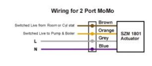

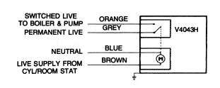

Spot the difference ;)
Honeywell spring return 2-port motorised valve. [Drayton & Danfoss valves are the same]
Sunvic MOMO
Apart from the different names and top picture has image of motor and switch :p
Most domestic systems would not readily convert to MOMO operation without additional wiring, and probably new thermostats.
