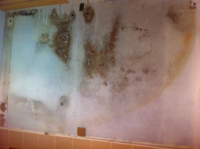

About three months ago, a dripping pipe from the flat above me starting dripping down into my kitchen. This was quickly fixed, but it was found that the pipe had been dripping for sometime down into the adjacent wall. A few weeks later, damp patches started to show inside my kitchen cupboards and mould began to grow on the back panelling - and there was a really strong smell of damp.
I've now taken the kitchen cupboards off the the wall behing was slightly clammy and very stained with mould. Have included a pic of this below. I was wondering what is the best way of sorting this? Is it as simple as painting the wall with some anti-damp / anti-mould paint and putting the cupboards back on the wall?

If it were me, I'd cut out the damp damaged section of plaster with a stanley knife to cut the perimeter. The stanley knife will minimise damage to the surrounding plaster as the damaged area comes away.
See how it looks underneath and then allow some time to let the brick/blockwork dry out before your next step.
