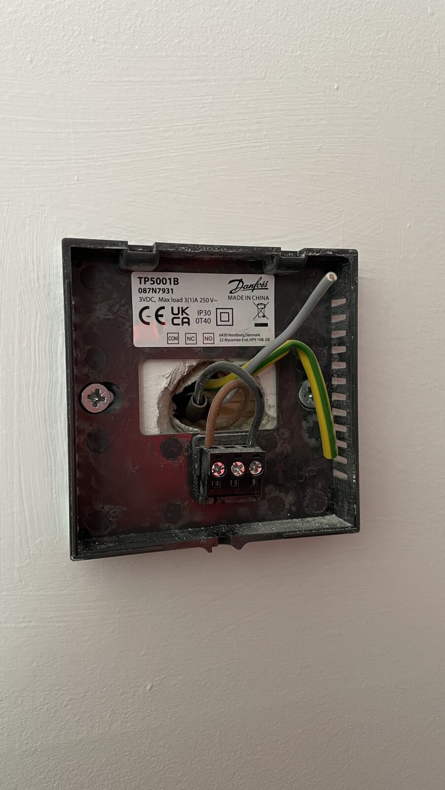

Apologies I wasn't sure if this would be better in the Electrics or central heating forum.

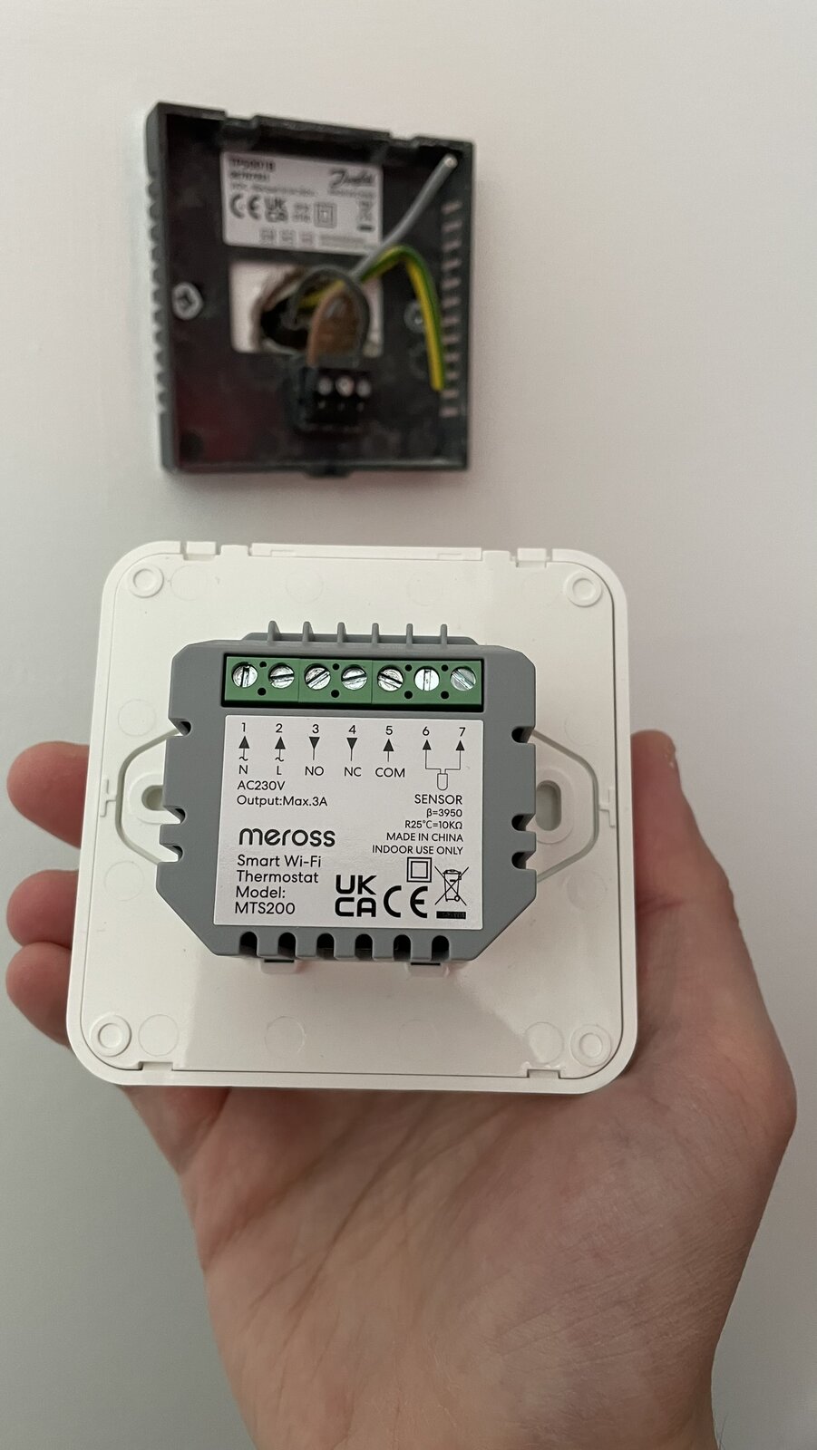

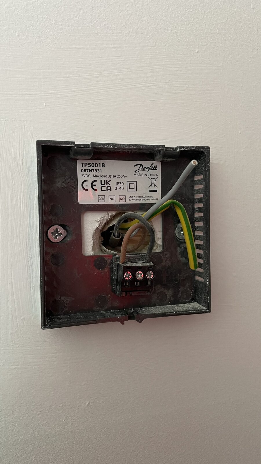

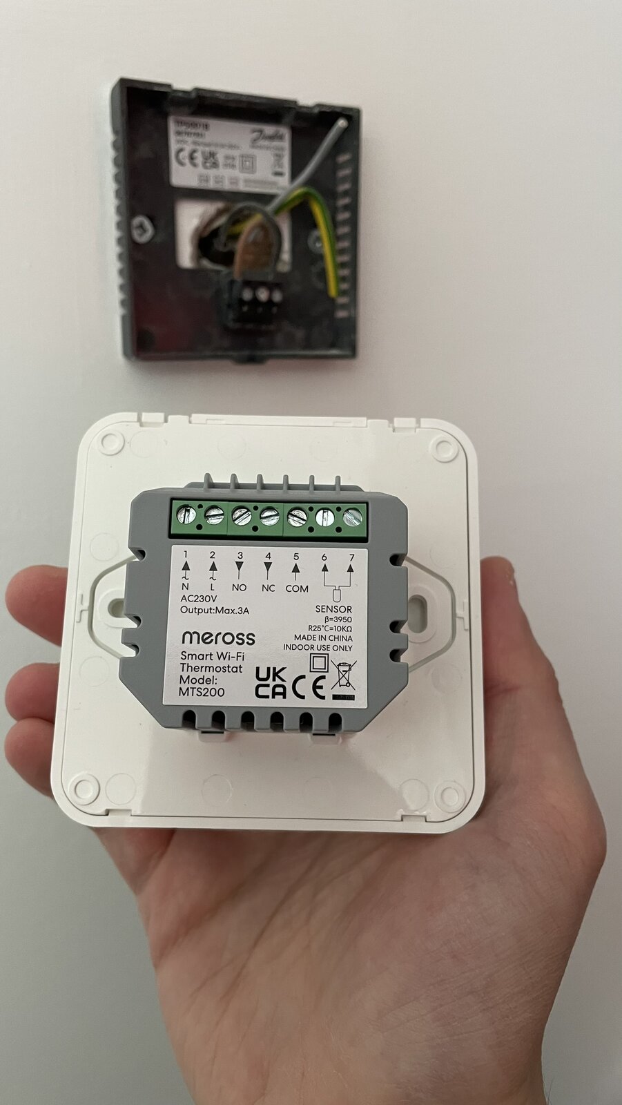

I currently have a Danfoss thermostat which I wanted to switch out with the new Meross Smart one I purchased.

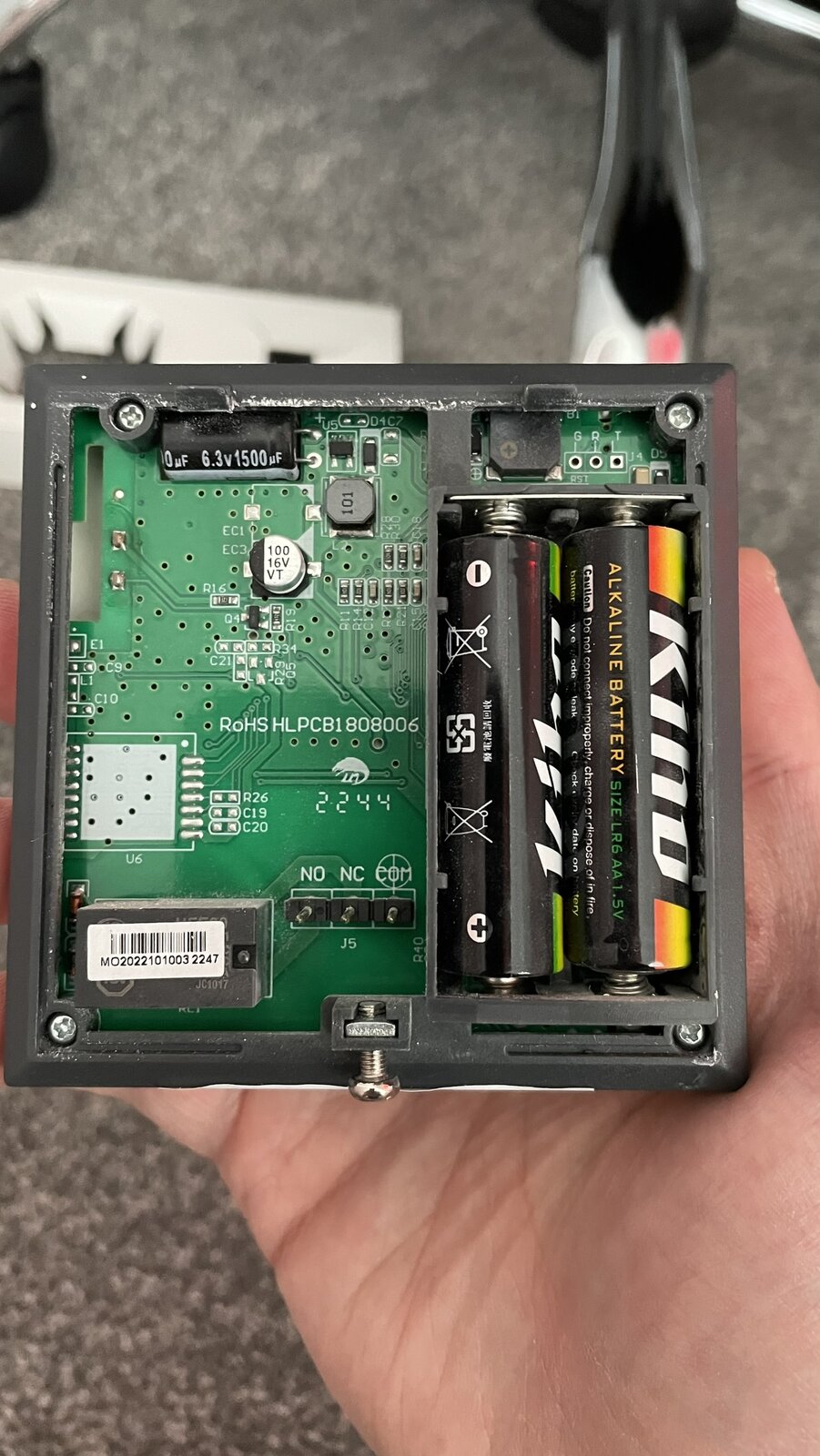

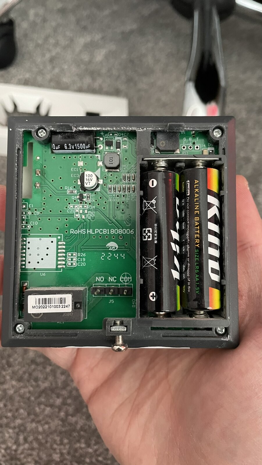

Thinking this would be an easy swap but I've discovered the Danfoss seems to be battery powered so I'm confused in regards to which wires would go where on the new Meross which requires a powered connection.
I understand the COM and NO connections are from the boiler but am unsure if the grey sleeved wire that's not connected to anything could be either a live or neutral that I could connect to the Meross.
Any advice would be appreciated.
Wires in wall:

If you look carefully, you will see the wires go to terminals on the Danfoss thermostat marked COM and NO. The New thermostat also has terminals marked COM and NO. So the brown wire goes to COM and the black wire to NO as they do now.
As you say, the old thermostat was battery powered, and the new one is mains powered, so you need a 230V supply for the new thermostat connecting to terminals marked N and L. This should come via the same 3A fused connection unit that supplies the boiler.
Now it may be that the old thermostat is wired using 230V switching and the brown wire in COM is actually a Live. In which case it can be linked to the L as well, and if you can find the other end of the grey wire which may also not be connected to anything at its other end. It could be used to provide the Neutral connection. It you have a multimeter (or know someone that has) and are competent in using it you can check if the wire in COM is a live or not.
A word of caution though. Some boilers use 24v for the thermostat control, others use 230V and others have the option of either. So you do need to check. If you have a system where the thermostat is connected to a motorised valve they will be switching 230V
No mention of an existing programmer / timeswitch anywhere, which if you do have may also require attention.

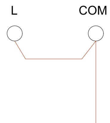

Likely I’m being stupid asking but how would I connect the current brown COM to BOTH the new COM and the LIVE at the same time?
Also, regarding the unconnected grey wire, assuming this is a neutral can I just strip some of the sleeve at the end and connect this to the new thermostat as is?
Like this by adding a short link wire between L and COM.
I assume you have determined that the brown wire is connected to a live, as per my first post. If you haven't, don't assume that the brown wire is being used as a live, it may not be connected to 230V L at its origin, it may be connected to 24v.
Yes that's how the connection would be made, but. the wire may be unconnected at its other end. You can't assume that it is connected to a neutral.

Thermostats such as the Merros thermostat that the OP has require 230V for its operating power.

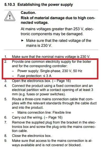

This statement, or a variant of it can be found in most boiler installation manuals. Here's one example from Vaillant.

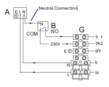

From the manual, as you say, boiler terminal 2 (from wire bk 2 in the diagram below) does provide a Live, so should be presently connected to the existing thermostat COM . The wire in terminal 1 (from wire b1 in the diagram below) should be connected to NO. So you should have as per the below. Except that in your case there is presently no Neutral connected to the existing Danfoss thermostat.
From the instructions you posted.
In the case of the 230V L coming from terminal 2 (bk 2) it is fed from the Fused Spur, as it will be isolated when the Fused Spur is switched off.
