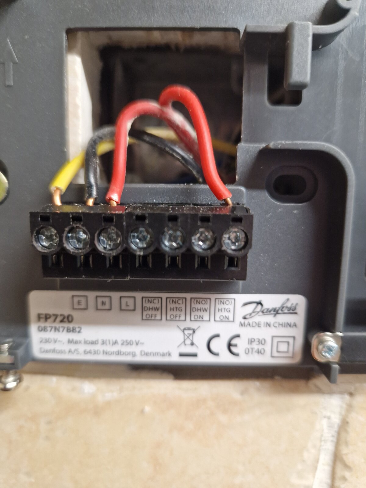

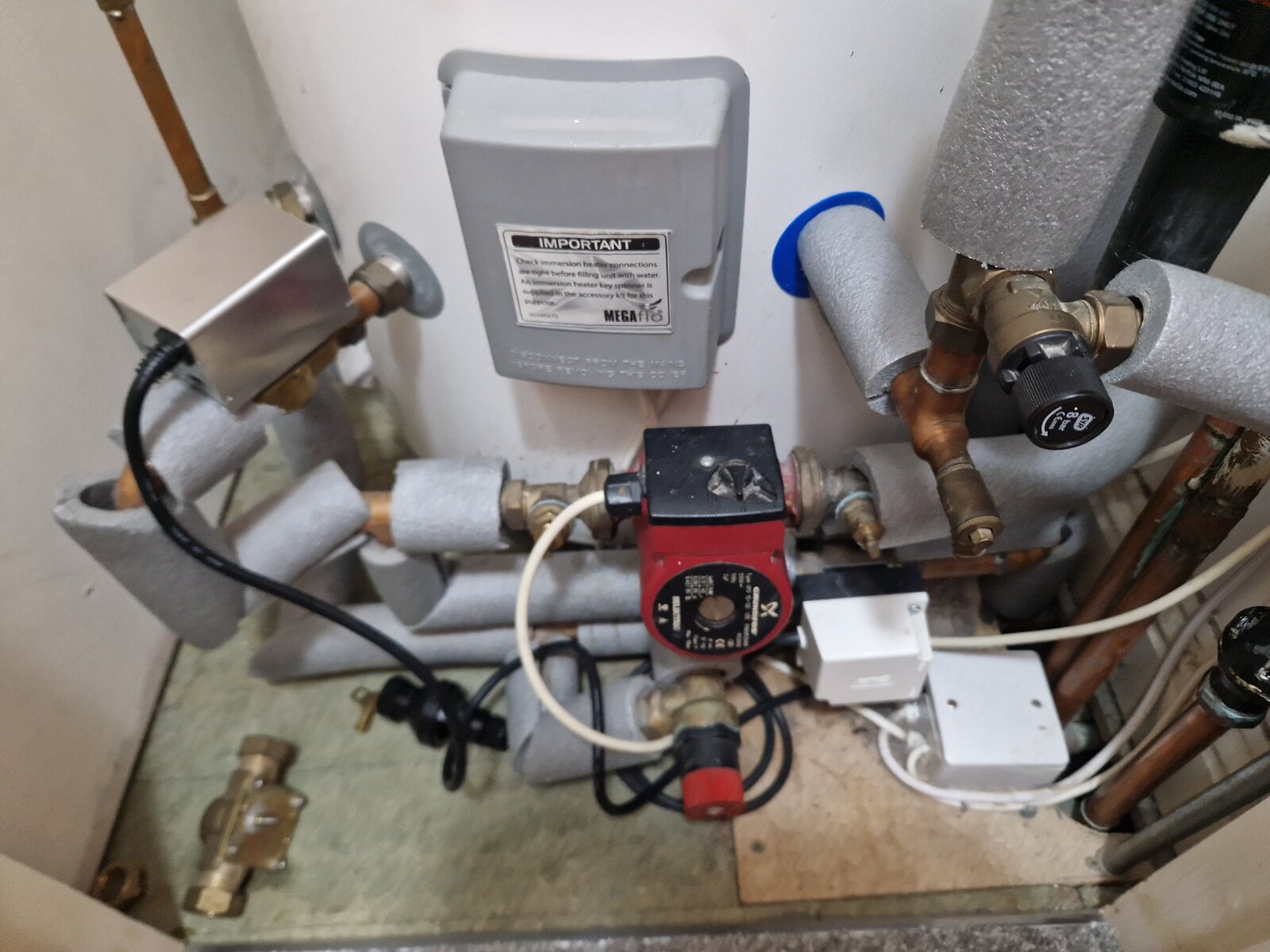

I changed my fp715 with a fp720 and changed to back plates over. wired it up the same but i have no hot water. The red led lights up when the time it is set comes round but it doesnt show the tap symbol in the display. i changed to motorised valve with a new spare I have. wondering if its wired wrong or i havent got the settings correct? The system is an Trianco oil boiler with Megaflo water tank. 2 motorised valves and a mechanical thermostat
Best with photos please of wiring and motorised valves.
The danfoss valve is heating the silver Honeywell is the hot water

Danfoss is the white valve at the bottom. I suspect you’ve wired it wrong, as there’s no hot water on connected in the FP720 - I think you may have incorrectly placed it into the earth terminal, that looks like just yellow imo.
