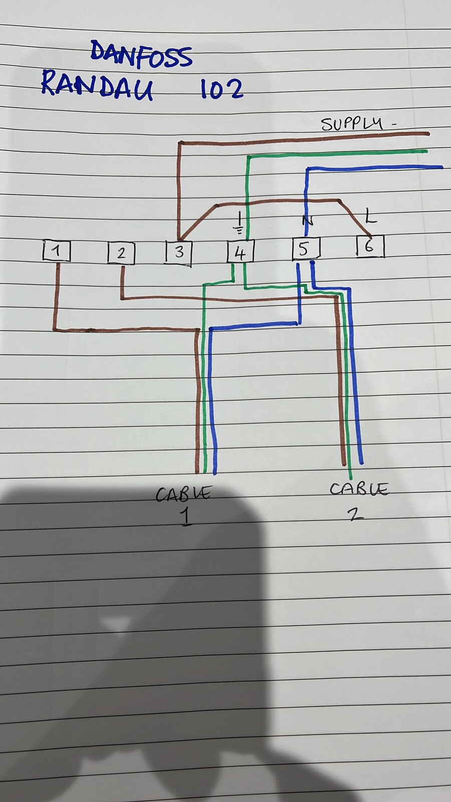

Hi. I have an old back boiler system that is controlled by a danfoss randall 102.
The Randall 102 has failed and I want to replace it.
Can you please advise what the best replacement timer would be and where to connect the wires.
At present there is a live feed to the timer which goes to terminal 3 and is then linked to terminal 6. The neutral goes to terminal 5 and earth to terminal 4 There are two other wires connected. The neutrals and earths are connected to 5 and 4. And the live wire from one cable goes to terminal 1 and the live from the other goes to terminal 2. ( I hope this makes sense)
I just want to connect up a simple easy to use replament timer for this
Can anyone please advise?
Thanks a lot for your help
Steve
This is the current wire to the danfoss Randall 102.

It depends if it’s setup as Gravity and pumped heating or fully pumped, if the latter, then almost any would be suitable. Can you confirm setup or show a photo of cylinder cupboard?
Did you have any success with this Steve? I'm trying to do a similar job to replace an old Randall 102 with a modern smart thermostat.
