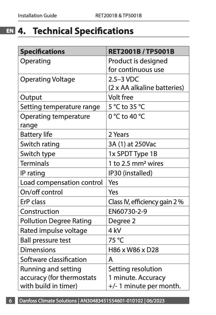

Hi Chris, thank you for the explanation. Looking a bit deeper into this I think you are spot on, it's a load compensation and not opentherm. And it's very basic, as you said.
It definitely does not have a receiver - I checked the model, which is 5001B. I've attached the specifications for this thermostat.
So basically what we have here is a very simple on/off thermostat, with slight "benefit" of turning the boiler on/off to frequently to control the heat, but actually does not change flow temperature like OT does. How annoying!
Does Ideal Logic ESP1 have opentherm support as standard, or would I need to buy a weather compensation kit?

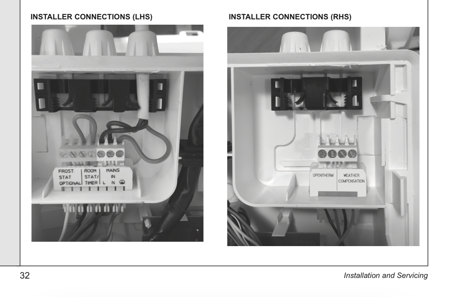

Providing it’s the correct instructions I have for your boiler, it does appear to support OT.
If you want a simple opentherm thermostat that you can install using the existing 2 wires look at NEST E, you will have to change the existing 2 wires at the boiler end to the OT terminals
