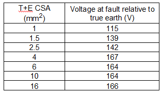

So, if we consider just a bog standard T & E cable supplying something in any location then what voltage might be present under earth fault prior to disconnection?
Seems like 16.0 T & E and 4.0 T & E might be the highest and 1.0 T & E might be the lowest.

As you illustrate,you aree perfectly capable of doing the (very simple) sums, but one problem is that the real-world answer depends upon factors external to the installation, which will usually often be unknown.
Presumably reflecting what you have done, IF the substation transformer (hence the neutral connection to true earth) were right next to the CU, and IF the supply voltage remained at 230V during the duration of the fault, then the voltage, relative to true earth, at the point of the fault would be roughly as per this table:
... which confirms, as you say, that the highest voltages at the fault, relative to true earth, arise with 4 mm² and 16 mm² T+E.
Assuming that the building is properly constituted as an equipotential zone, then what actually matters are potentials relative to the installation's earth (not 'true earth'). That means that, in the real-world situation (substation being remote from the installation) then IF the supply voltage at the CU remained at 230V during that fault (which it won't, since Ze will not be zero), then the figures in the above table would still apply to the voltage relative to the installation's earth - and that remains true whether it is a TN-S, TN-C-S or TT installation.
However, in the real world the catch is that (since Ze will not be zero) the supply voltage will not remain unchanged during the fault. Particularly if the installation is fairly distant from the transformer, I imagine that the supply voltage at the origin of the installation could drop markedly during the fault, thereby markedly reducing the voltages at the fault relative to the installation's earth.
However, none of this is 'news', so I wonder what your point is. I thought we all understood that 'touch voltages' remain 'dangerously high'; during a fault, that being the reason why we are required to take steps to limit the faults to very short durations (before disconnection)?

Yes I know all that John, what was striking was the theoretical difference between the best and worst size relationships at the point of the fault . Besides I do prefer to think about 240 being the "real voltage" as it always has been - ish rather than the now notational 230 volts . Europe did not change their voltages and neither did we, we simply all rewrote it to fit in with each other.

.... what was striking was the theoretical difference between the best and worst size relationships at the point of the fault .
Indeed. I have no idea how 'they' arrived at the decision as to what CSA of CPC to have in T+EE cables. I think that, in some countries, COCs have to be at least the same CSA as the live conductors - which makes a certain amount of sense.
However, I'm not sure it really has much practical relevance, since the CSA of CPCs would have to be at least double that of the live conductors before the touch voltages became remotely safe - and that'snot going to happen (nor, to my knowledge, is it the situation anywhere ion the world). ... and, of course, RCDs don't make any difference to (the magnitude of) the touch voltages, either.

Anyway, I always feels a bit safer with 1.0 T & E or singles of the same size conductors than some of the other sizes, even if somewhat deluded
It's obviously 'the best' T+E, but I don't think you should feel significantly 'safer' because the touch voltage is (briefly) then 'only' 115V (or 120V,or whatever) :)
