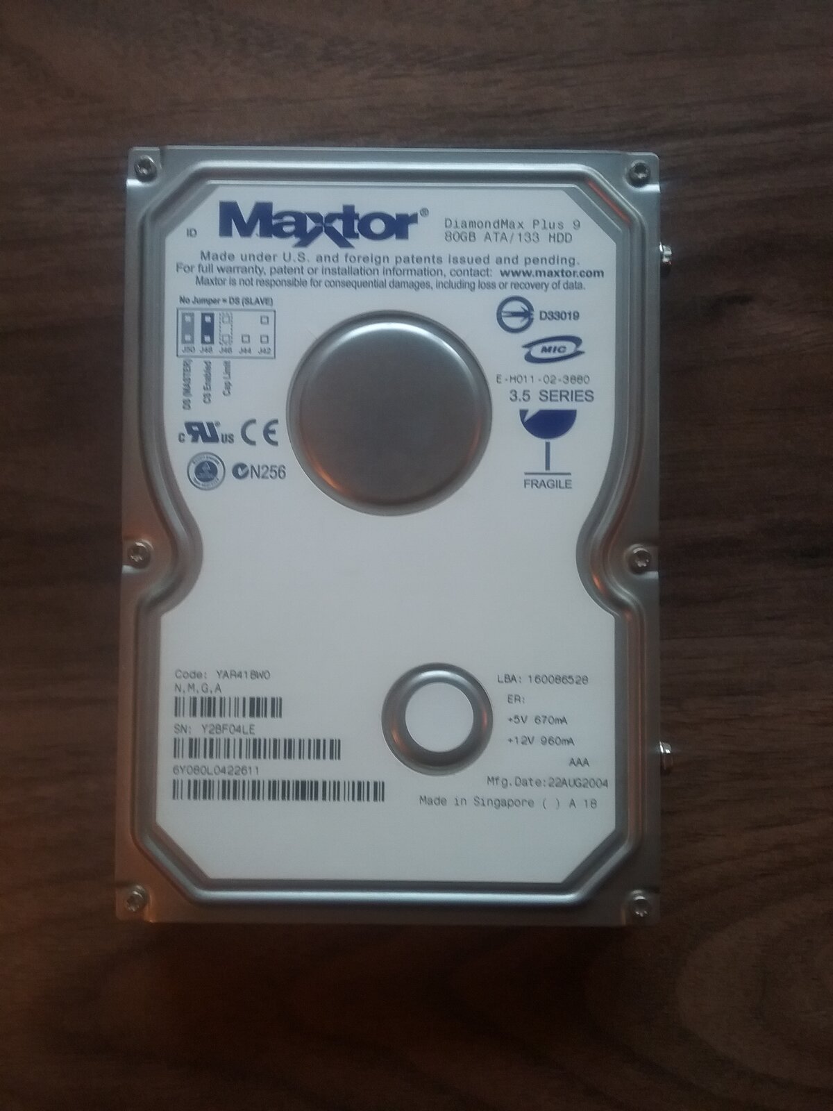

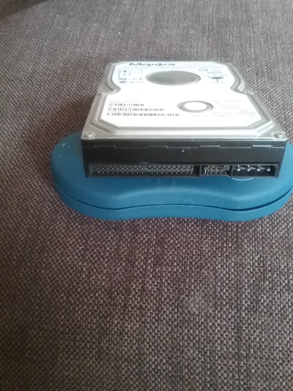

A friend's "dated" pc won't power up. To help him I've followed all the online advice to no avail. He now has two choices get a professional firm to transfer files or allow me to buy kit to connect the hdd to my pc and transfer a few text files, that he took ages to create, to my pc.
The former is very expensive the latter not. However I'm not confident enough to buy the correct kit. The hdd is an 80gb Maxtor, ATA, 3.5 series as per the enclosed images.
I would be grateful for any links for an inexpensive best buy.

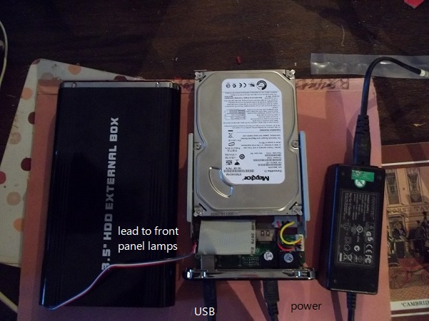

I used a caddy into which the hard drive is fitted and via a USB this caddy then connects to the host computor as an external disc.
My caddy is labelled as a 3.5" HDD External Box
Make sure your computor cannot boot up from the disc in the caddy. Easiest way to ensure this is to turn your machine on BEFORE connecting the caddy.

I have a caddy too but it is only suitable for SATA drives and I see that yours isn't SATA so, you might need to get an adapter cable.
Thanks all. So I need a PATA enclosure. And the hdd is connected to something inside the enclosure.
The enclosure is connected to the pc presumably by USB. But won't it require a power source?
Has anyone got a close-up image of how the enclosure works?
Bernard I think it was you that sent images of a Maxtor PATA in a caddy. It had all the connections inside the caddy with a power source for transmitting to a PC or Laptop. Just what I need. Thanks. Have you got a buying link?

It may still have an IDE connector (same as on the drive) on it, and if it does then all you need is a cable and you can attach it.
Else get a "3.5" IDE USB drive enclosure" - searchable on amazon or ebay etc.

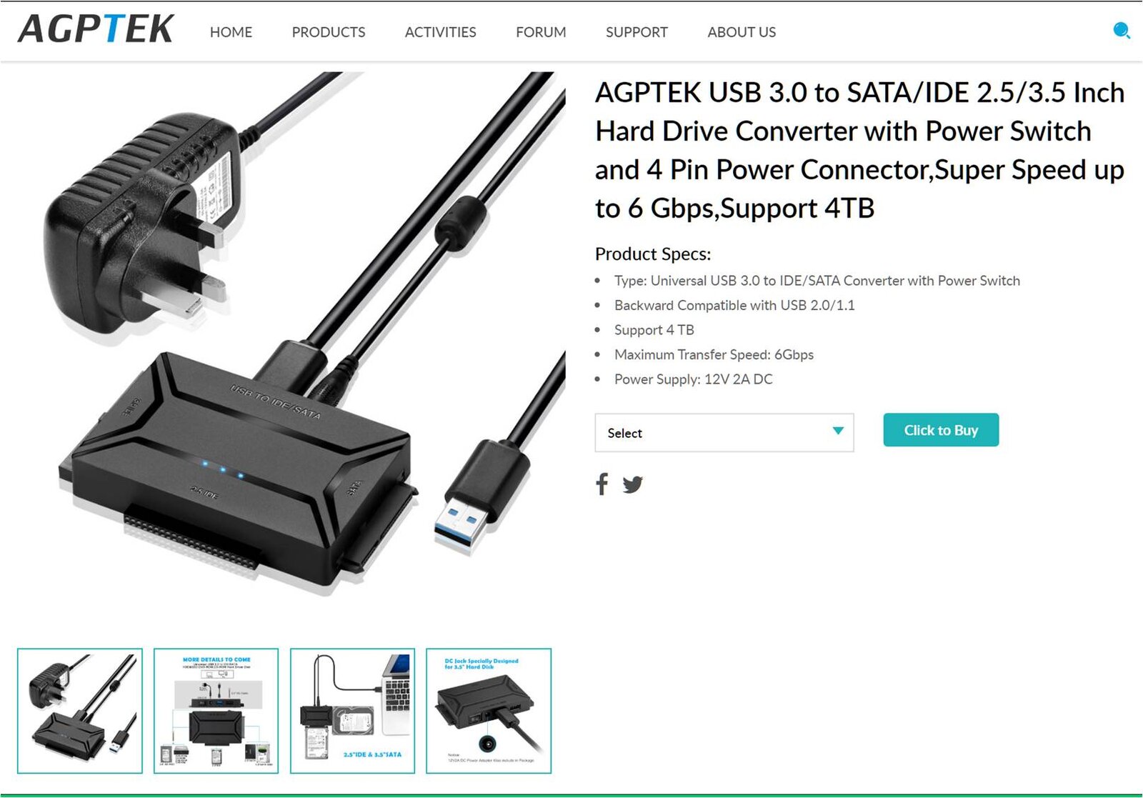

the PDF may explain how this unit works with the IDE Data & LP4 power connections
https://www.novatech.co.uk/products...ssdhdd-1-x-type-a-female-usb/usb2sataide.html
I purchased a similar unit from Novatech maybe 10 years ago and use on a lot of different drives to copy data from peoples OLD harddrives
