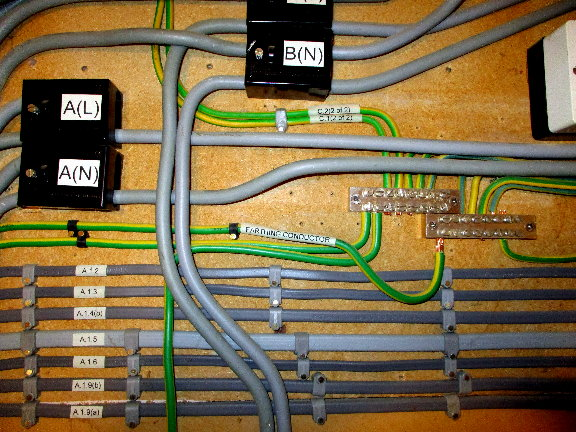

You mean this sort of labelling, in my domestic installation (without labelled earth blocks :) )? (Even if the labels are not very easily read in this photo - apologies !) ....
Kind Regards, John
That looks more like a map of the underground than an electrical installation I've seen!:LOL:
... but's that's only a very small part of the entire underground network - maybe I should show you the whole thing) if my camera has a wide-enough angle lens - it's a very narrow room, so I can't get very far from the 'map' !!
Kind Regards, John
