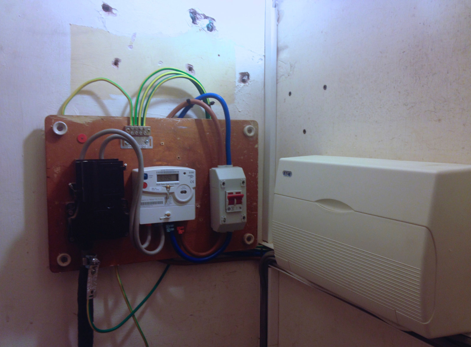

Why are there two cable ties on each meter tail out of the meter feeding the isolator?
That’s a British Gas thing. They say L and N on them, despite being blue and brown already, he had to double mark them! There’s also one tie on the tails feeding the meter to indicate it’s the feed
Before removing any customer tails from a meter, ukpn and probably all others have to confirm polarity and mark up the tails with stickers with the confirmed polarity. This is visual reminder that polarity has been confirmed whether or not the tails are coloured correctly. In case of distraction etc.
If the tails were incorrectly coloured and confirmation was forgotten, ukpn would be negligent to reconnect the installation the "correct" way round. Actually they'd refuse to work on the installation in all likelihood.
Like with flying a plane, there's no"use your common sense" in jointing manuals as it's not safe to decide any more than necessary when you're execution a safety critical task. If it takes 10 seconds longer but increases safety it's in the book.
I appreciate it’s a confirmation but the next person that comes along is also going to confirm polarity regardless - they would be negligent in not doing so - who’s to say since those tails were tagged something has gone awry and the polarity is now incorrect?

That's what, apparently unlike EFLI, I was also not sure about, either, and maybe not even a metre - perhaps 500 or even 300 mm.
As I asked EFLI is it your practice to attach such labels to a MET which is very close to (but not inside) a CU/DB, and is it your experience that most others do this?
Kind Regards, John
<a photo of someone's work>
So what's the answer ....
Are you implying that the photo is of your work, and that's what you usually do, or what?
Kind Regards, John
