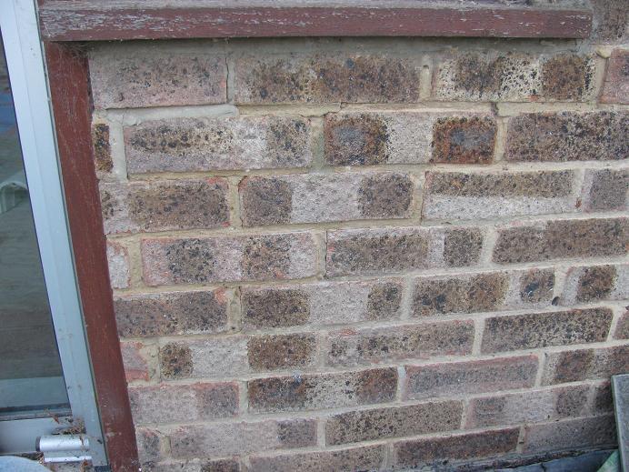

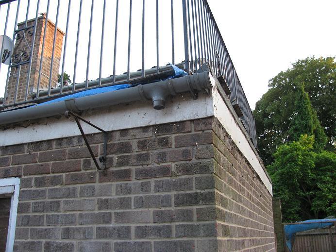

Lets first accept that the roof joists used in this thing are 47x150... Not even sufficient for a roof, let alone a balcony. But these are then build onto walls that are, well...
I'm sure that also, due to the bricks being dug out to bed the joists in, the rest of the wall is cracking...

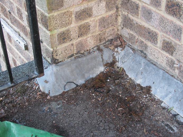

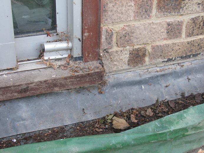

All of this not helped by the lack of suitable guttering. This was just a down spout into a raised bed built against the wall and over the DPC...
And while the roof leaks through various holes in the felt, somehow, the flashing seems to be NOT leaking through some sort of satanic power...

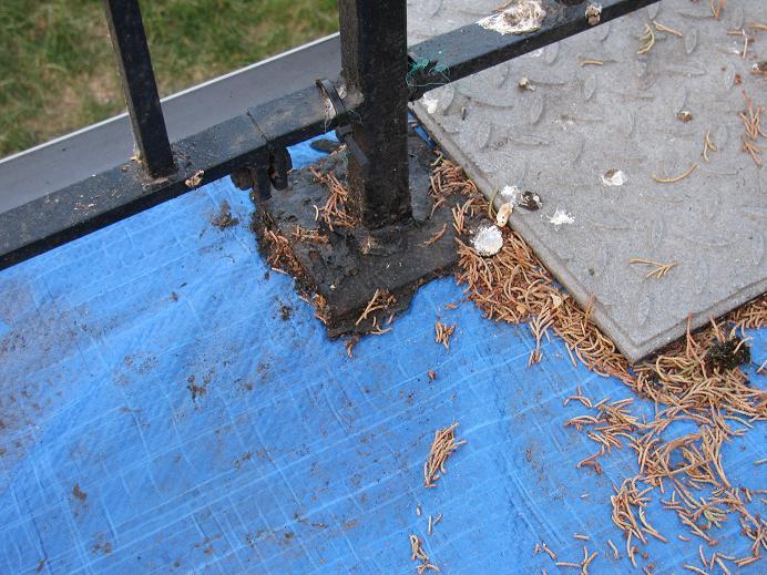

Let us not forget the EXTREME ULTIMATE NEAR DEATH RISK FACTOR!!!!! The railings aren't even connected to the roof. I managed to lift them up to get the tarp underneath...

Looking at the roofing charts for maintainance only access. Even with the lightest imposed load (0.75 kN/m2) and lightest dead load (under 0.5 kN/m2). a 47x170 (being generous on the size, it's only 45x150 + firing) joist on 600mm centers has a recomended maximum span of...
3.61m.
The room (from finished plaster to finished plaster) is 3.65m long
Also, not shown in the pictures. There is no wall plate. So the joists are resting directly on bricks. On the frog. With no mortar. Thus, one end of each joist is supported on about 940mm^2 area. That sounds a lot, but should be... 4700mm^2 (100mm support of 47mm joist).

Although one can sympathize with your never-ending discovery of DIY horrors, this joist-bearing issue is not technically as bad as it seems.
The previous edition of the Building Regs tables allowed a minimum bearing of 38mm for joists! But the actual compressive stress per square mm on the timber is still quite low relative to the permissible compressive stress.
Also, when I first started, some Inspectors would not allow flat-roof joists to be fitted to a wall-plate but required that the joist were built-in as the wall went up.

With regards to wall plate, I assume from your saying about building it into the wall, you mean the end that is against the house wall (which I had thought was a ledger board), rather than the end where the joists sit on top of the extension wall. In which case, I imagine the advances in fixing methods (resin bond anchours, expanding bolts... etc) are the reason 'to the wall fixings' (as opposed to 'in the wall fixings') are now acceptable.
While I can completely appreciate timber and brick have huge compressive strengths and are no where near their failure limit in this situation, it seems daft that for the sake of a little bit of mortar or timber, you would make the acting pressure 3 times higher than it could be.
This ties in with my 'over engineering' thread. If you CAN make something stronger for a couple of quid, why not do it, especially if it's your own house. Because inevitably building regs will change and what was just good enough at the time then becomes unacceptable by new build standards.
