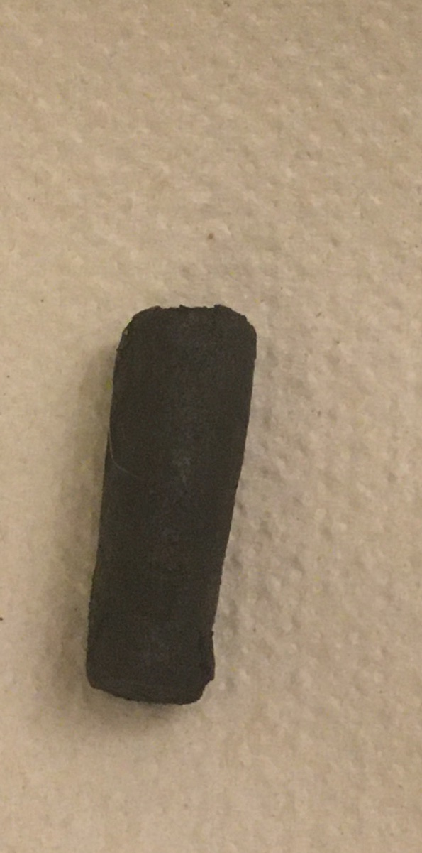

Hi there, I've had ongoing problems with my Fiat Scudo van (Diesel, 2007, 100,000miles) having some kind of intermittent fuel stoppage and sailing to a complete halt. And then starting again straight away and being fine for another few miles. And can be fine for another 4 weeks!
Everything was changed (fuel filters etc) and after another 3 weeks it broke down again.
Finally the garage cleaned the fuel tank and discovered 4 cigarette butt type objects in the tank. They are all identical in size and structure. They are the exact size of a cigarette butt.

For sure, these could cause issues if they lodge in the tank filter where the first pump is.
I guess the tank has been removed and flushed?
The debris could come from a garage with contaminated tanks or even sabotage!
John :)
Here is a picture

They won't have a Fiat part number!
Are they soft in texture?
Normally the strainer on the fuel pump would stop these things but you can only clean the tank and try again to see if the engine behaves.

Yes they are soft in texture. I was thinking that just swirling up against the fuel filter would cause a breakdown?
Theoretically if the problem started at the fuel garage, any debris would be held in the nozzle filter.
I'd also have thought that diesel would at least delaminate a fag end rather than leaving it whole.
The tank pump has a fairly large filter and it would take a fair amount of debris to totally block it.

If it is a fag end, it could well have the outer skin removed. In fact I think it does.

It's common to find large-ish bits like that in a fuel tank believe it or not, what happens is the same thing that happens when you make a snowman a small amount of dirt rolls around and more dirt sticks to it. Over years the bits can end up quite large. For the same reason, if you remove a car tyre, it almost always has a load of little balls in it. This is almost certainly not your problem though, the fuel sender/fuel filter pickup has its own swirl pot and the pump has a filter screen, these bits wont get anywhere near the pickup. You problem, I believe, will be worn brushes on the electric pump itself.
